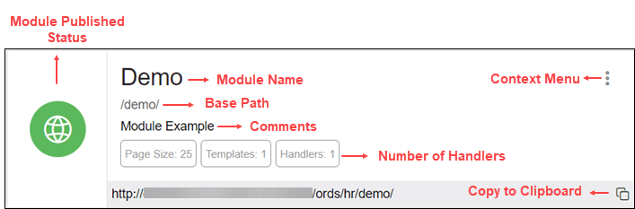

4.6.1 Managing Resource Modules
You can define, edit and delete resource modules in the Modules page.
To navigate to the Modules page, in the REST Overview page, click Modules in Objects, or from the menu in the header, select Modules.
The module attributes displayed by default in card view are shown in the following figure.
The module status can be published or unpublished. If the status is unpublished, the icon is displayed in a red color.
Click the module name in card view to go to the Templates page for that module. You can also navigate to the Templates page through the context menu.
The actions available in the context menu are:

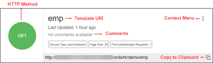

4.6.3 Managing Resource Handlers
You can create, edit and delete resource handlers for a template in the Handlers page.
To navigate to this page, in the Templates page, click the Actions icon for a template and select Handlers, or click the name of the template in card view.
At the top of the page, the template card is available with context menu options such as Edit and Delete.
Tthe handler attributes displayed by default in card view are shown in the following figure.
The HTTP Method can be one of the following: GET, PUT, POST and DELETE.
You can navigate to the HTTP method page using the context menu. There are three tabs displayed in the HTTP method page: Source, Parameters and Pre-Authenticated Requests.

4.6.3.1 Creating a Resource Handler
This section describes how to create a resource handler.
  1. In the Handlers page, click Create Handler.
  2. Specify the properties of the resource handler. The specific options depend on the method type.
    Handler Definition Tab
    • Method: Enter the HTTP request method for this handler: GET (retrieves a representation of a resource), POST (creates a new resource or adds a resource to a collection), PUT (updates an existing resource), or DELETE (deletes an existing resource). Only one handler for each HTTP method is permitted.
    • Items Per Page: Enter or choose the default pagination size, or the number of rows to return for a database query. This option is only available for GET handlers. If this value is not defined, the number of items per page is the one defined in the module.
    • Source Type: Select the source implementation for the selected HTTP method. The default is collection query.
      • Collection Query: Executes a SQL query and transforms the result set into a JSON representation. Available when the HTTP method is GET.
      • Collection Item: Executes a SQL query returning one row of data into a JSON representation. Available when the HTTP method is GET.
      • Media: Executes a SQL Query conforming to a specific format and turns the result set into a binary representation with an accompanying HTTP Content-Type header identifying the Internet media type of the representation.
      • PL/SQL: Executes an anonymous PL/SQL block and transforms any OUT or IN/OUT parameters into a JSON representation.
    • Source: Enter the SQL query or the PL/SQL block for the HTTP method. In the handler details page, you can test the SQL or PL/SQL handler code in the handler editor.
    • Go to Handler after creation: Select this option to go to the details page after the handler is created.
    MIMEs Allowed tab
    Identifies the type of information included in the HTTP Request Body. For example, if the POST Handler is expecting JSON in the request, add "Application/JSON" as the MIME type.
    Show code: Select this option to view the PL/SQL code equivalent of the Create Handler slider. You can copy and execute this PL/SQL code in the worksheet to perform the same action that occurs when you click Create in the Create Handler slider.
  3. Click Create.
    The handler is displayed on the Handlers page for the specific template.
    You can test the REST service endpoint using a REST client or a command-line tool such as cURL.
