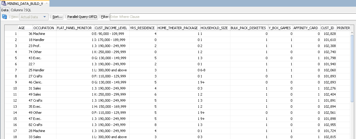

View Create Table or View Data
You can view the data of a node in the Data Source Node viewer.
After the node runs successfully, right-click the node and select View Data. The data is displayed in the Data Source Node viewer.

Update Table Node Data Viewer
After the node runs successfully, you can view the data in the Update Table Node Data Viewer.
To view the data, right-click the node and select View Data. The data viewer is the same as Data Source Node Viewer.
Related Topics
Parent topic: Update Table Node
