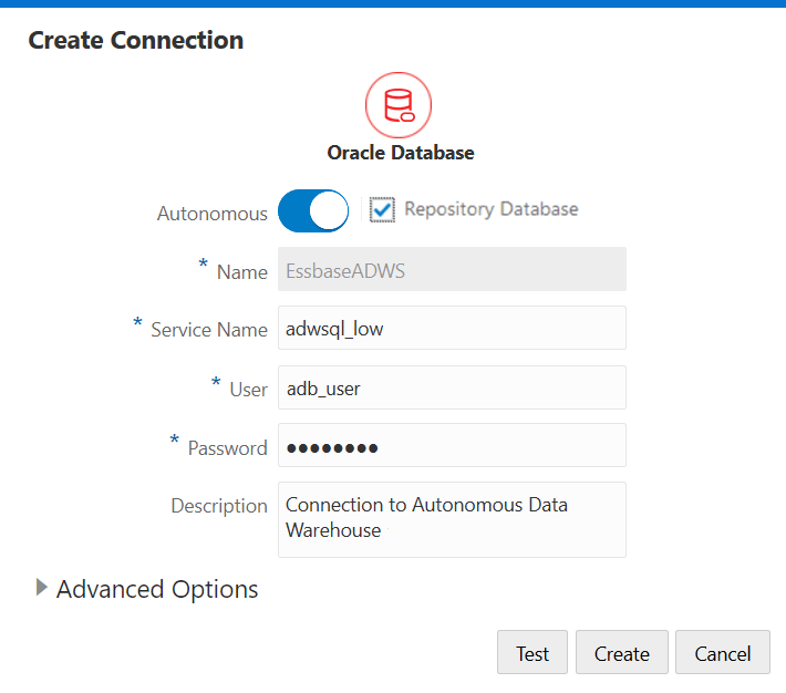

Click Create Connection, and for the connection type, select Oracle Database.
Enable the Autonomous switch.
Enter a connection name.
If you are recreating an Autonomous AI Lakehouse connection after migrating the application using the Lcmimport CLI command (or an Import LCM job), it is recommended to use a new connection name, to avoid encountering errors.
Select a service name.
Use connection type Medium when you need your application to run many Essbase calculations. Use connection type Low if your application is used mostly for queries. Consider using Medium connection type if your queries involve large calculations and you don't have a large number of concurrent users.
Enable the Repository Database switch. This is required for federated cube connections.
You do not need to upload a wallet, because Essbase will use the wallet associated with the repository database.
Enter your Autonomous AI Lakehouse username, password, and optionally, a description.
Click Test to validate the connection, and if successful, click Create.
If you get connection errors, you may need to expand Advanced Options to adjust the minimum and maximum connection pool sizes.
Refer to About Controlling the Pool Size in UCP in Universal Connection Pool Developer's Guide.
Verify that the connection was created successfully and appears in the list of connections.

Click Create Connection and select Oracle Database.
Select Autonomous using the toggle switch.
If you are recreating an Autonomous AI Lakehouse connection after migrating the application using the lcmimport CLI command (or an Import LCM job), it is recommended to use a new connection name to avoid encountering errors.
Select the Repository Database option. This option is required to be selected for federated partition connections.
