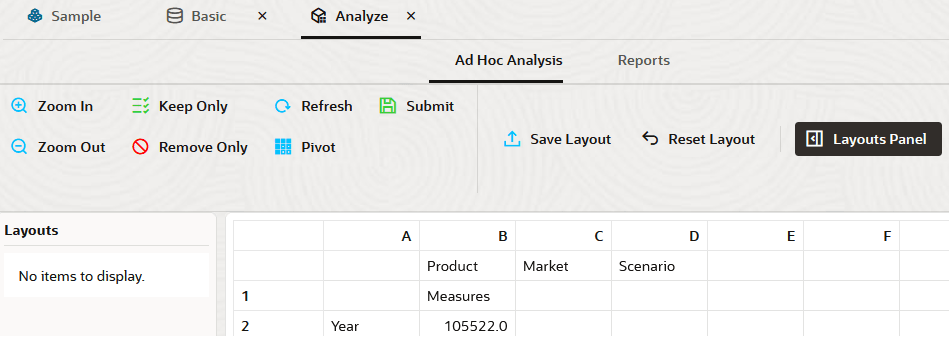

In the Ad Hoc Analysis tab of the Analyze Data view, a grid is displayed containing each of the base dimensions (non-attribute dimensions) from the cube.
You may or may not see data in the ad hoc grid, depending on your filter access and how data is stored in the cube. Data is not always stored at the topmost member for every dimension hierarchy.
Use the ad hoc navigation buttons at the top left of the Ad Hoc Analysis tab to navigate to data that you are allowed to see. If your filter grants you write permission on the cube, the Submit button enables you to update data for stored intersections within the scope of your filtered access.
