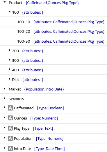

The Sample_Dynamic Basic cube has five standard dimensions (Year, Measures, Product, Market, and Scenario), and five attribute dimensions (Caffeinated, Ounces, Pkg Type, Population, and Intro Date).
The standard dimension Product is associated with four attribute dimensions: Caffeinated, Ounces, Pkg Type, and Intro Date). The standard dimension Market is associated with the attribute dimension Population.
The Market dimension member Connecticut is associated with the 6000000 member of the Population attribute dimension. That makes 6000000 an attribute of Connecticut.
Detail of member Connecticut in the Market dimension displays the attribute associations it has.
The product member 100-10 has three attributes—it has caffeine, is sold in 12-ounce containers, and is sold in cans.
Detail of member 100-10 in the Product dimension displays the attribute associations it has.
