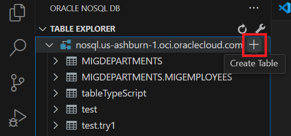

- Hover over the Oracle NoSQL Database connection to add the new table.
- Click the Plus icon
that appears or right-click on the database
connection name and click Create
Table.
