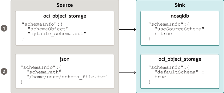

  • Providing Table Schema: NoSQL Database Migrator allows the source to provide schema definitions for the table data using schemaInfo attribute. The schemaInfo attribute is available in all the data sources that do not have an implicit schema already defined. Sink data stores can choose any one of the following options.
    • Use the default schema defined by the NoSQL Database Migrator.
    • Use the source-provided schema.
    • Override the source-provided schema by defining its own schema. For example, if you want to transform the data from the source schema to another schema, you need to override the source-provided schema and use the transformation capability of the NoSQL Database Migrator tool.
    The table schema file, for example, mytable_schema.ddl can include table DDL statements. The NoSQL Database Migrator tool executes this table schema file before starting the migration. The migrator tool supports no more than one DDL statement per line in the schema file. For example,
    CREATE TABLE IF NOT EXISTS(id INTEGER, name STRING, age INTEGER, PRIMARY KEY(SHARD(ID)))
    Migration will fail if the table is present at the sink and the DDL in the schemaPath is different than the table.
  • Create Sink Table: Once you identify the sink table schema, create the sink table either through the Admin CLI or using the schemaInfo attribute of the sink configuration file. See Sink Configuration Templates .
    If the source is a CSV file, create a file with the DDL commands for the schema of the target table. Provide the file path in schemaInfo.schemaPath parameter of the sink configuration file.
