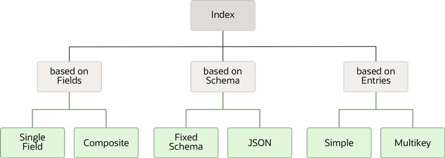

Classification of Indexes
Indexes can be classified based on fields, schema, entries, or a combination of them. Each one of these is described below.
Fields
Single Field Index
Composite Index
Schema
Fixed Schema Index
Schema-less Index (JSON Index)
Entries
Simple Index
Multikey Index
The following classification is made based on the number of fields that are provided while creating an index.
Single Field Index
An index is called a single field index if it is created on only one field of a table.
Composite Index
An index is called a composite index if it is created on more than one field of a table.
The following classification is made based on the schema type of the fields that are indexed.
Fixed Schema Index
An index is called a fixed schema index if all the fields that are indexed are strongly typed data. For more information on strongly typed data, see Wildcard Data Types section.
An index is called a JSON index if at least one of the fields is JSON data or fields inside JSON data.
The following classification is made based on the number of index entries created for each row of data in the table when evaluating an index.
Simple Index
An index is called a simple index if for each row of data in the table, there is one entry created in the index.
Multikey Index
An index is called a multikey index if for each row of data in the table, there are multiple entries created in the index.
Figure 1 - Index Classification

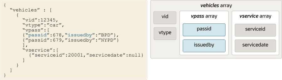

You can use multiple fields of an array/record/maps-viewed-as-records together. However, the restriction here is that a field cannot be treated as both array and map within a single
CREATE INDEXstatement.The following is an example of a composite multikey index in which multiple fields of an array are used together. The index is created on the
passidandissuedbyfields in thevpassarray in theUserInfotable.CREATE INDEX nestedindex1 ON UserInfo ( info.vehicles[].vpass[].passid AS ANYATOMIC, info.vehicles[].vpass[].issuedby AS ANYATOMIC )Figure 2: Composite Multikey Index

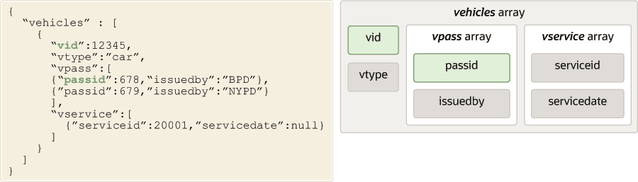

You can use fields of an array/record/maps-viewed-as-records, as well as the fields present inside the inner arrays of those array/record/maps-viewed-as-records together. However, the restriction here is that the immediate parent array of all such fields should be the same.
The following is an example of a composite multikey index in which fields of an array and fields of an inner array are used together. The index is created on the
vidfield in thevehiclesarray and thepassidfield in thevpassarray which is in thevehiclesarray in theUserInfotable.CREATE INDEX nestedindex2 ON UserInfo ( info.vehicles[].vid AS ANYATOMIC, info.vehicles[].vpass[].passid AS ANYATOMIC )Figure 3: Composite Multikey Index
The following is an example of a composite multikey index in which fields of an array and fields of an inner array are used together, however, notice that the immediate parent array of the two fields are not the same. The following is an invalid index creation statement. The index is being created on the passid and serviceid fields in the vehicles array in the UserInfo table. Note that within the vehicles array, passid is inside the vpass array, and serviceid is inside the vservice array.
CREATE INDEX invalidindex1 ON UserInfo (
info.vehicles[].vservice[].serviceid AS ANYATOMIC
Figure 2 - Composite Multikey Index (invalid)
