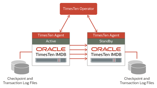

About the TimesTen Containers and the TimesTen Agent
After the objects are created, the TimesTen containers run a script that configures and starts the TimesTen agent. The Operator communicates with the TimesTen agent running in each Pod, in order to configure, manage, and monitor TimesTen in that Pod. The agent provides an HTTPS endpoint in the Pod that the Operator uses to query and control the tt
container in the Pod. If the TimesTen agent fails, the tt
container automatically terminates and is re-spawned by Kubernetes. Figure 1-3 illustrates the two way communication between the Operator and the TimesTen agent.
Figure 1-3 The Operator and the TimesTen agent
Description of "Figure 1-3 The Operator and the TimesTen agent"
The TimesTen agent starts TimesTen and thus runs as the instance administrator user. It has full control over TimesTen.
