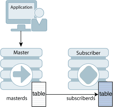

Configuring a Classic Replication Scheme with One Master and One Subscriber
You can configure a classic replication scheme that replicates the contents of a single table in a master database to a table in a subscriber database.
This section describes how to configure a classic replication scheme that replicates the contents of a single table in a master database (masterds) to a table in a subscriber database (subscriberds). To keep the example simple, both databases reside on the same computer.
Figure 2-2 Simple Classic Replication Scheme
Description of Figure 2-2 follows
Description of "Figure 2-2 Simple Classic Replication Scheme"

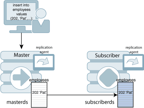

  6. Insert data into the table on the master database.
    1. Use ttIsql to connect to the master database and insert some rows into the employees table:
      % ttIsql masterds
      Command> INSERT INTO employees VALUES
            ( 202,
              'Pat',
              'Fay',
              'PFAY',
              '603-123-7777',
              TO_DATE('17-AUG-1997', 'dd-MON-yyyy'),
              'MK_REP',
              6000,
              NULL,
              201,
              20
      1 row inserted.
    2. Open a second command prompt window for the subscriber. Connect to the subscriber database and check the contents of the employees table:
      % ttIsql subscriberds
      Command> SELECT * FROM employees;
      < 202, Pat, Fay, PFAY, 603-123-7777, 1997-08-17 00:00:00, MK_REP,
      6000, <NULL>, 201, 20 >
      1 row found.
    Figure 2-3 shows that the rows that are inserted into masterds are replicated to subscriberds.
    Figure 2-3 Replicating Changes to the Subscriber Database
    Description of Figure 2-3 follows
    Description of "Figure 2-3 Replicating Changes to the Subscriber Database"
