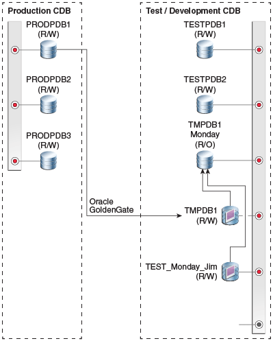

The following figure shows the TMPDB1
created from TMPDB1_MONDAY
. The original TMPDB1 has been renamed to TMPDB1_Monday as part of the DROP PLUGGABLE DATABASE
/CREATE PLUGGABLE DATABASE
steps listed above. The new TMPDB1 is a sparse snapshot pluggable database that, until any changes are made to TMPDB1, looks exactly like TMPDB1_Monday. Oracle GoldenGate applies redo to the new TMPDB1 snapshot without having to make any changes to the replicat configuration

The following figure shows the TEST_MONDAY_JIM snapshot PDB created from TMPDB1_MONDAY. TEST_MONDAY_JIM uses TMPDB1_MONDAY as its parent so all data in TMPDB1_MONDAY_JIM is that same as the data in TMPDB1_MONDAY until changes are made to the snapshot PDB. Oracle GoldenGate continues to receive and apply redo to TMPDB1.
