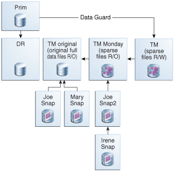

Figure 9-17 Configuration After Repeating the Process
Description of Figure 9-17 follows
Description of "Figure 9-17 Configuration After Repeating the Process"

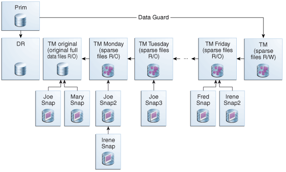

The process to create a new sparse test master can be repeated up to 9 times, which would create an environment 10 levels deep with the original standby data files and 9 hierarchical snapshots.  When repeating the process for the ninth time, do not create a new snapshot to receive the redo from the primary database.
Figure 9-18 Potential Future Configuration
Description of Figure 9-18 follows
Description of "Figure 9-18 Potential Future Configuration"
If you reach the maximum 10 levels, you have multiple options:
  • If you have enough space to maintain multiple copies of the standby database and snapshots, then create a new tree of hierarchical snapshots based on another standby database. The original standby data files and snapshots can remain as long as required.
  • If you do not have enough space to maintain multiple copies of the standby database and snapshots, then:
    1. Delete the snapshots and their associated data files, including any snapshots used as test masters.
    2. Refresh the standby.
    3. Create a new tree of hierarchical snapshots.
  • Create a new standby database on a different environment and create a new tree of hierarchical snapshots.
