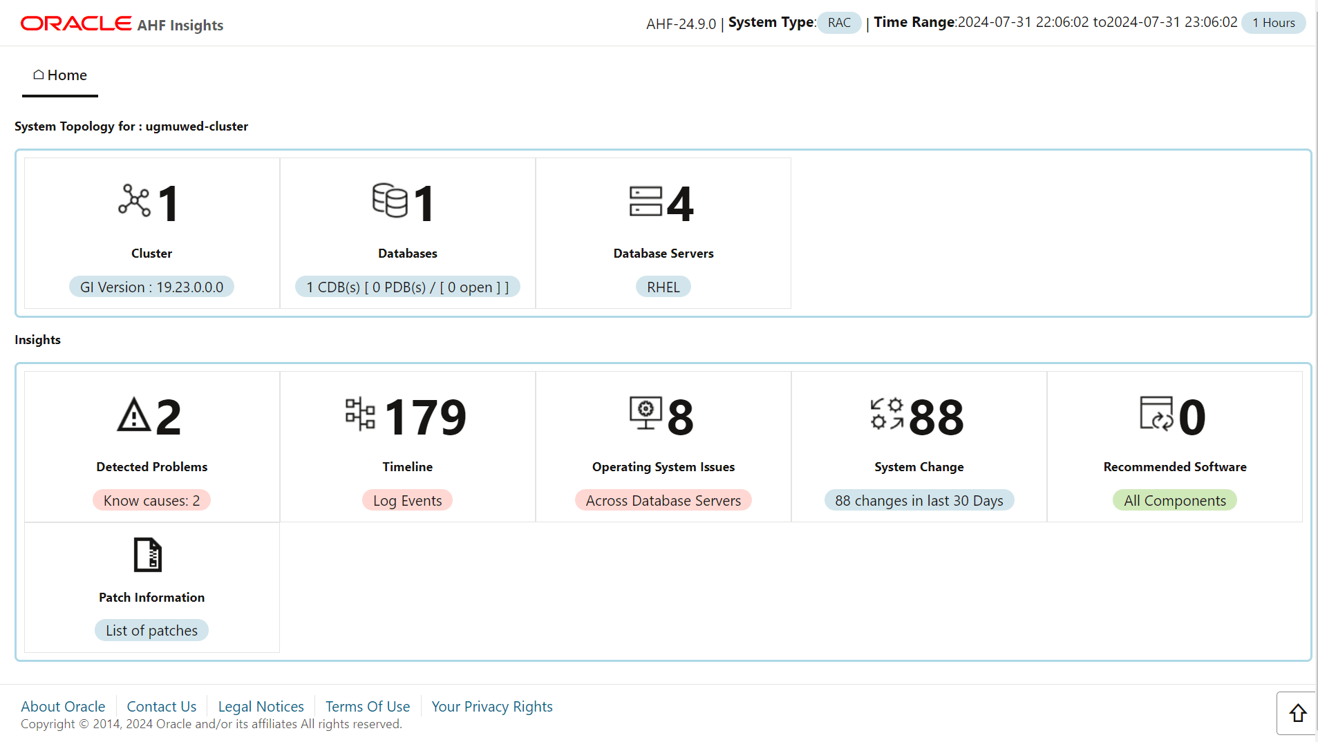

- Within here you’ll find another zip containing Autonomous Health Framework Insights. Extract that and open the
index.html.Figure 7-1 AHF Insights
Figure 7-2 AHF Insights
Figure 7-3 Detected Problems

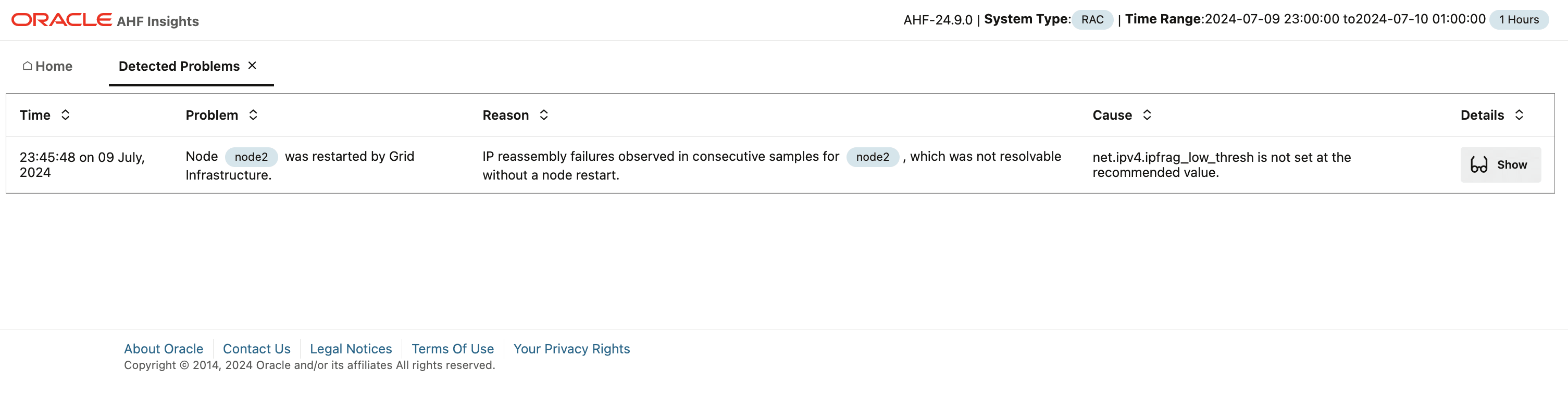

- Click Detected Problems.
The Detected Problems page displays the list of problems detected.
Figure 7-4 Detected Problems
Detected Problems section is created only when AHF Insights detects problems. - Click Show to view the details.

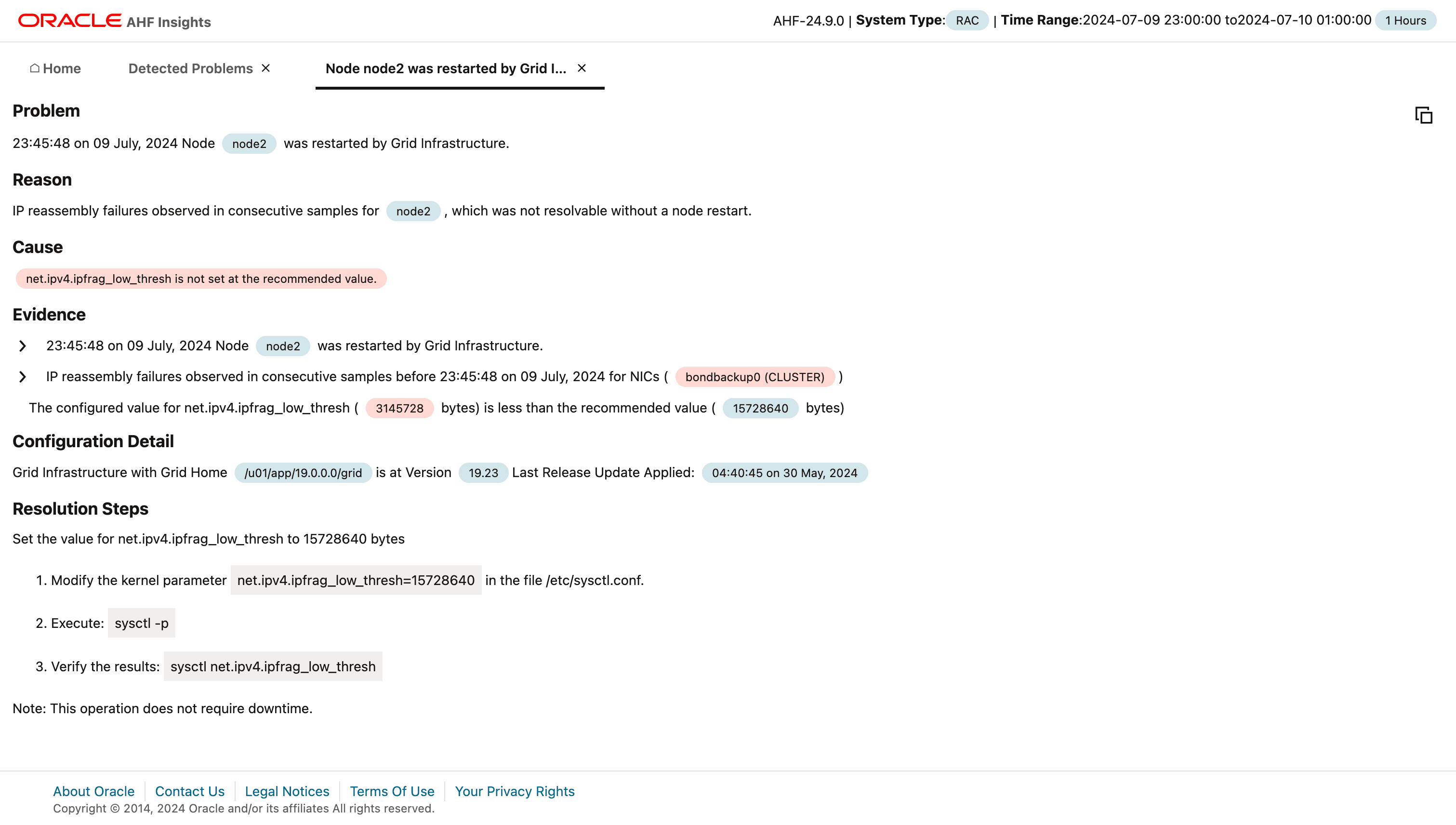

Figure 7-5 Detected Problems Details
The Problem Summary contains:- Problem: Describes what happened.
- Reason: Explains why it happened.
- Cause: Identifies the root cause.
- Evidence: Provides proof to support why this is the cause. Evidence sections are expandable to show the underlying data.
- Resolution Steps: Explains the exact steps to resolve the problem in simple terms.
