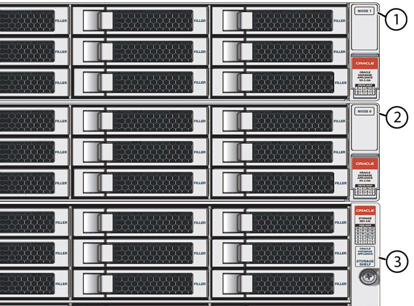

Installation Sequence
Understand the proper installation sequence when installing an Oracle Database Appliance X9-2-HA into a rack.
Always install equipment in a rack starting at the bottom and working upwards. For Oracle Database Appliance X9-2-HA, install the equipment in the following order:
                                 Storage expansion shelf, if equipped (lowest available rack space).
                                 Storage shelf (next rack space above that).
                                 Server node 0 (next rack space above that).
                                 Server node 1 (next rack space above that).

Apply Labels to Server Nodes
Complete this task to apply server node labels before installing the appliance into a rack.
Parent topic: Installing Oracle Database Appliance X9-2-HA Into a Rack
