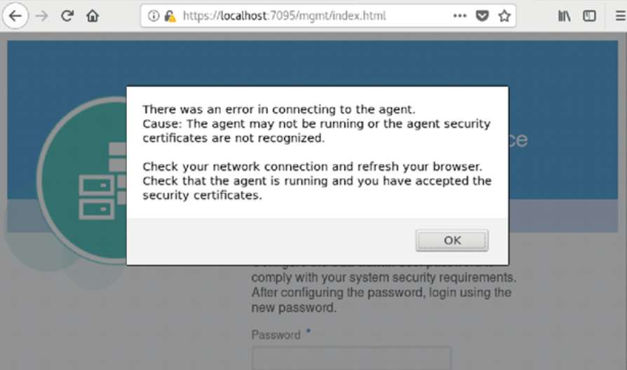

About BUI Agent Certificate Issue
Understand the common BUI issues you may encounter when setting up the Oracle Database Appliance simulator.
Requirements
https://server IP:7095/mgmt/index.html
Your assigned port number maybe different
You may see a BUI agent security certificate error message:
https://server IP:7096
( Your port number maybe different)
Go through the certificate exception process again and add the exception. Then you can access the BUI to create the appliance.
Parent topic: Setting Up the Oracle Database Appliance Simulator
