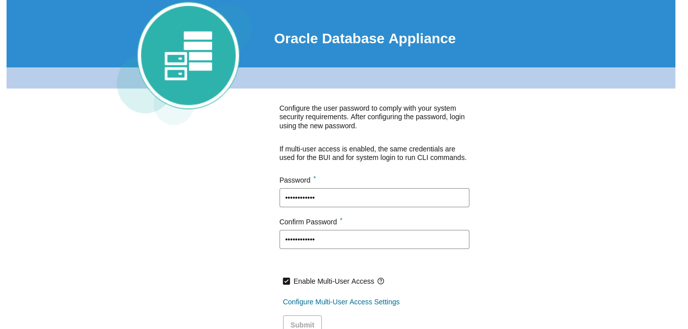

Step 3 - Enable Multi-User Access
You can deploy the appliance using either the BUI or the command line. The command line is useful for scripted and silent installations. This lab uses the BUI.
After you configure the firstnet and update the repository, log into Oracle Database Appliance BUI using odaadmin and the previously-created password (for example, WELcome12##)
Multi-User access can only be enabled during initial provisioning of Oracle Database Appliance. Select the Enable Multi-User Access checkbox. Description of configure_oma_bui_login.png follows

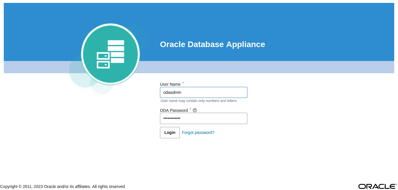

Log into BUI.Description of login_after_configuring_oma.png follows

After you configure the firstnet and update the repository, log into Oracle Database Appliance BUI using odaadmin and previously created password (for example, WELcome12##).
https://OCI public IP Address>:xxxx/mgmt/index.html
Description of bui_login_page.png follows
This takes you to the Appliance tab in the BUI. It should show that the appliance is not yet deployed.

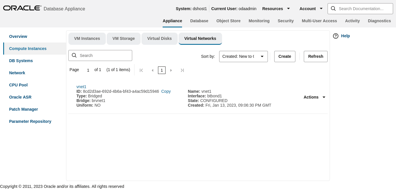

Step 6 - Networking
Check the network.
You can check the network by clicking on the Network tab on the BUI Appliance page.
You can also create a new VLAN by clicking Create Network and specifying the network information.
Click on the Create button, then submit the job.

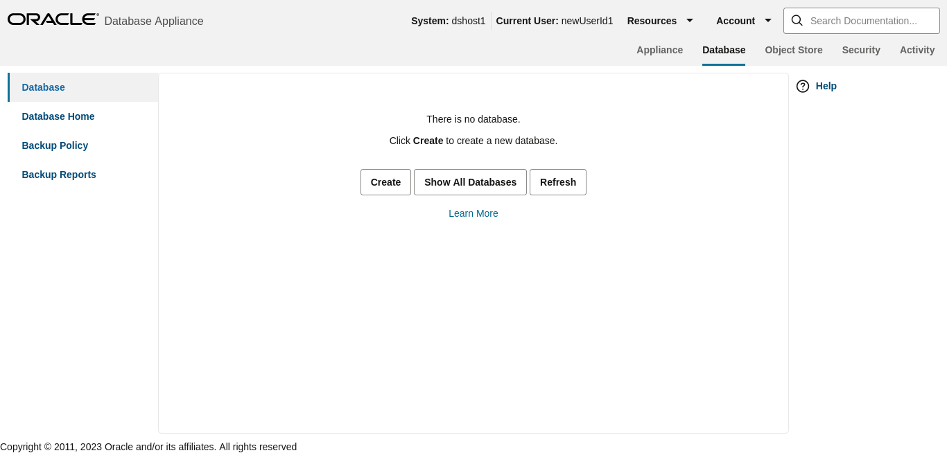

On the Oracle Database Appliance BUI, click the Database tab in the web page. You will see the database db1 created during deployment.
In the upper right-hand corner, there is a Create Database button. Click it. It brings up the Create Database wizard.
Choose Create Database, and click Next.
Specify the DB Name, for example, db2, and if you are creating a CDB, a PDB Name. Also remember to scroll down and enter a password that would in an actual appliance be used for SYS, SYSTEM, and PDB Admin.
When finished, click on the Create button. Click Yes to confirm. Beware of the password complexity checker—“WELcome12##” will pass the test.
This will bring up a link to the job status. Similar to ODACLI, operations on the BUI are asynchronous, and return immediately with a job ID. That job ID can then be used to monitor progress. This allows the administrator to perform other tasks if desired while long running operations complete.
Click the job ID to see the status. In the simulation, the job will complete within 30 seconds. You can see the various steps running, and their status changing to Success as they complete. Click the Refresh button to refresh the screen more quickly.
On an actual appliance, these steps take about 20 minutes to complete.
Once the operation completes, click on the Database tab at the top right of the web page. This should show the newly-created database.
See detailed database information by clicking on the database name, for example, db2. You can also view the newly-created home by clicking on the Database Home link in the left-hand column of the Database tab.

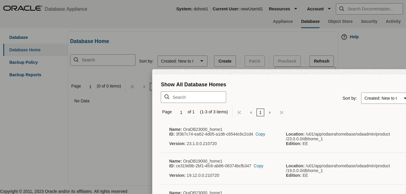

Step 7 - Delete a Database Home
You can delete a database home using the BUI or the command line. This lab uses BUI to delete a database home.
Go to the Database tab, then click on the Database Home to see all the database homes. Click on Actions, then click Delete (for example, home1).
You can see that the database home is deleted.

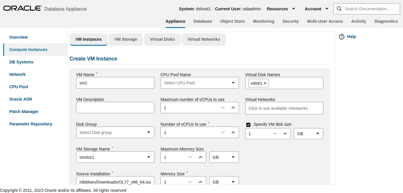

Lab 4 - Virtualization: Create Application and Database KVMs
Virtualization provides many benefits to customers such as cost savings through consolidation and better resource utilization, Virtual Machine (VM) isolation that provides better security, and KVM license hard partitioning support.
Kernel-based VM (KVM) is an industry standard virtualization technology that is also used in Oracle Cloud and other public clouds.

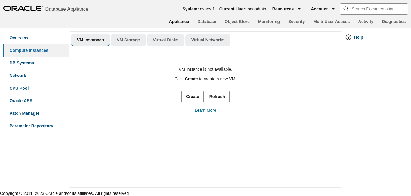

You will use Oracle Database Appliance BUI to create an application KVM, called Compute Instance, and a database KVM, called Database System.
Step 1 - Create an Application KVM (Compute Instance)
Understand the steps to create an application KVM.

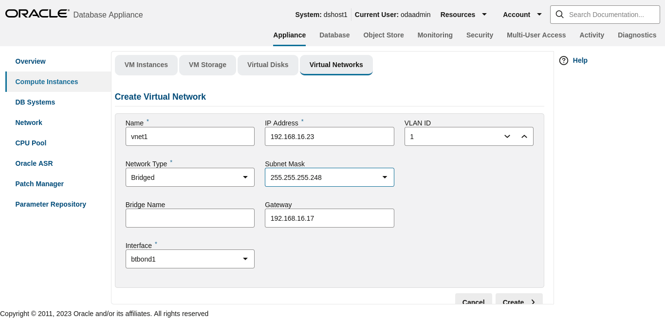

Before you create an application KVM on Oracle Database Appliance, you must create the following:
  • CPU Pool
  • VM Storage
  • Virtual Disk
  • Virtual Network

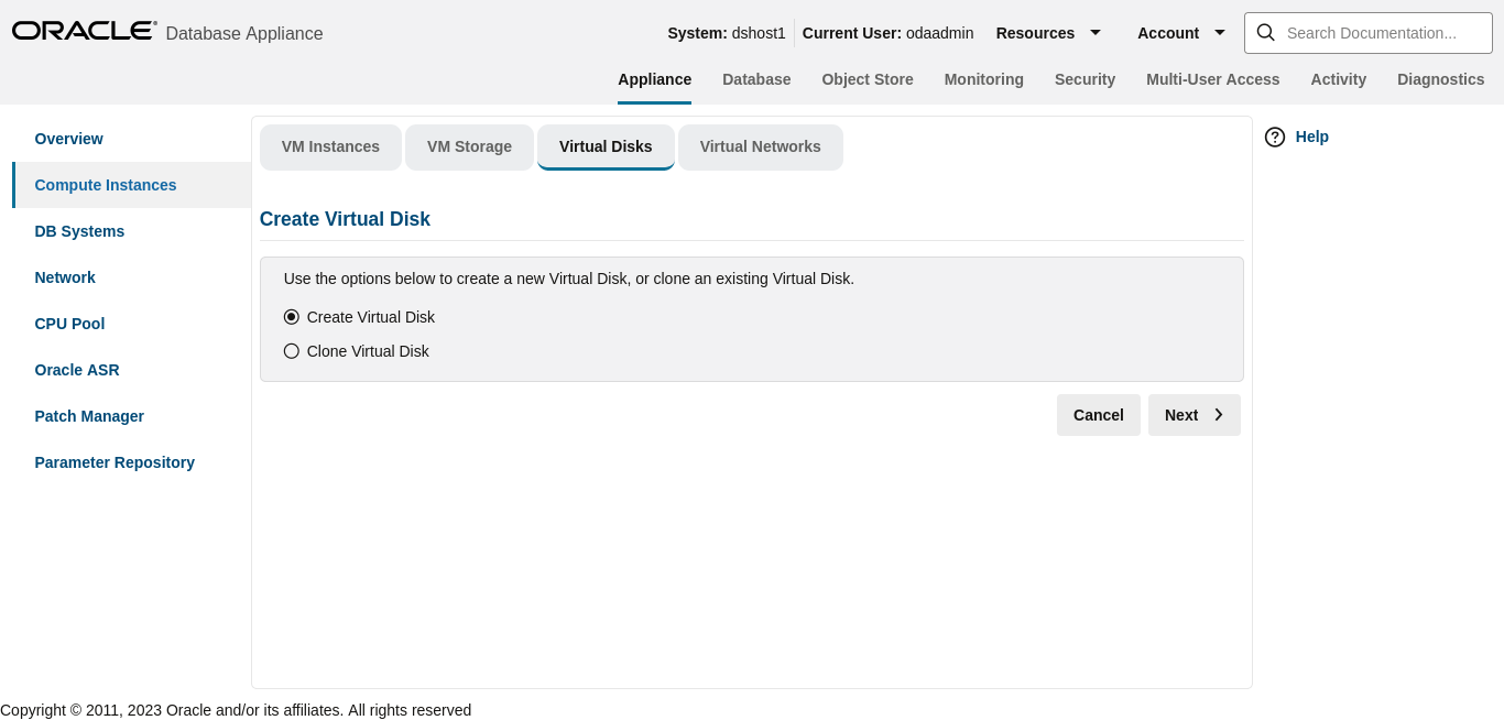

You must create a guest operating system (Linux or Windows) ISO image to create the application KVM instance. After that, you must configure the guest operating system, networking (set IP address) so that you can access the VM to install applications. You can also modify and delete an application KVM.

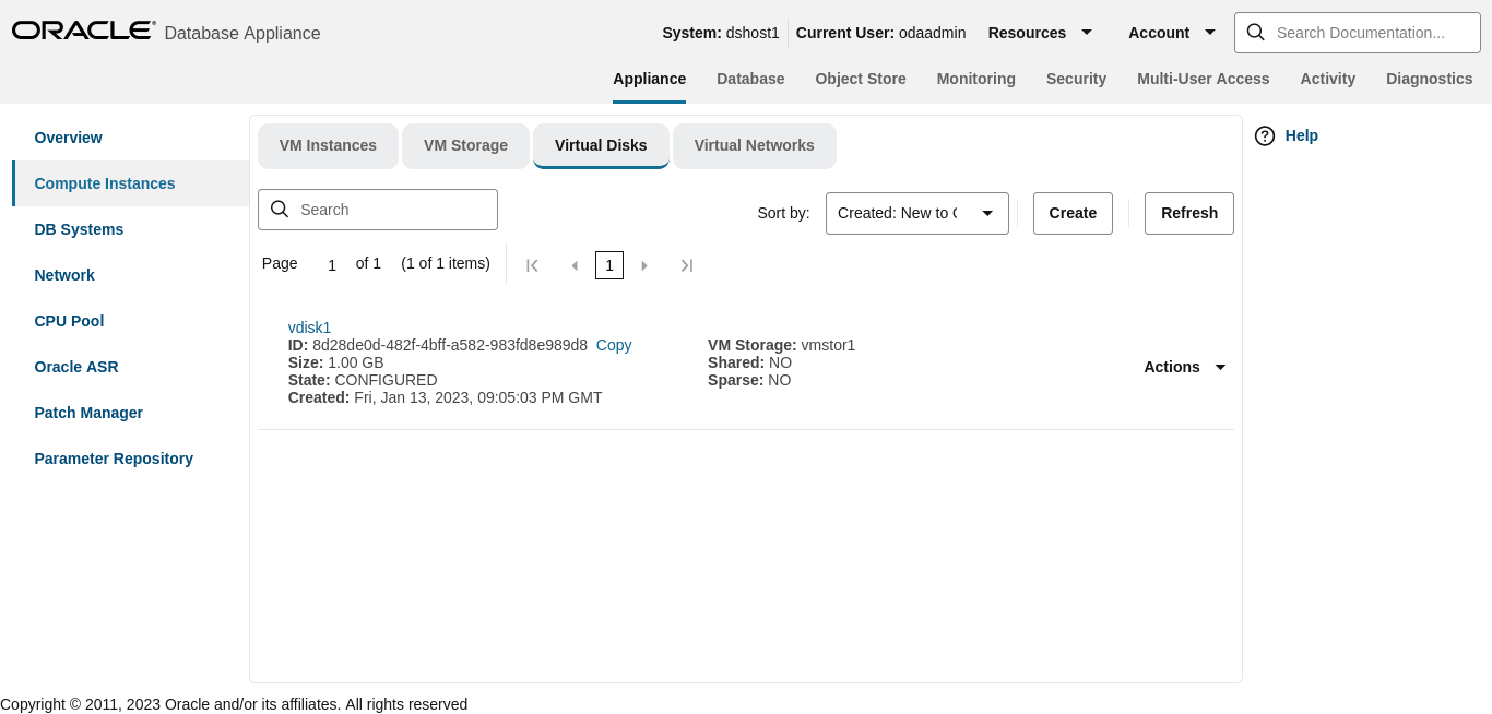

First, create a CPU Pool for the application KVM. In the BUI, click CPU Pool, and then click Create. Enter the following information, then click Create.
You can see the CPU pool cpupool1 is created. A CPU pool is optional and not required to create an application KVM.
Next, create the VM Storage.

Next, create a virtual disk vdisk to be used by the application KVM. Select the Virtual Disks tab and click Create Virtual DiskDescription of bui_vdisk_select_option.png follows
Select Create Virtual Disk, then click Next.Description of bui_vdisk_create.png follows
Enter the following information for vdisk1, and then click Create. You can see vdisk1 is created.Description of bui_vdisk_created_successfully.png follows
Create a virtual network for the KVM:
Select the Virtual Networks tab, and then click Create Virtual Network.
Specify the Virtual Network information, then click Create.Description of bui_vnet_create.png follows
You can see the virtual network vnet1 is created.Description of bui_vnet_created_successfully.png follows
Create an application KVM (Compute Instance):
Select the VM Instances tab, and then click Create.Description of bui_vm_list.png follows
Select Create VM Instance, then click Next.Description of bui_vm_create.png follows
Specify the information for vm1, then click Create. Note the Source Installation path to the Linux ISO image. Note that the VM disk size is 10GB. VM disk is the local system boot disk where the Linux image is installed.

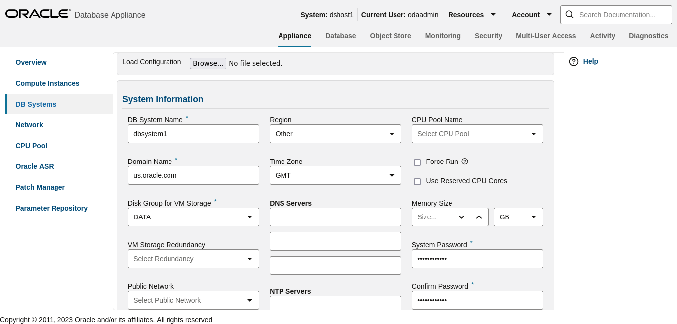

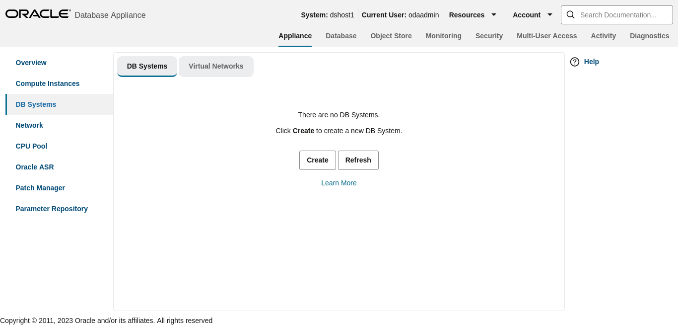

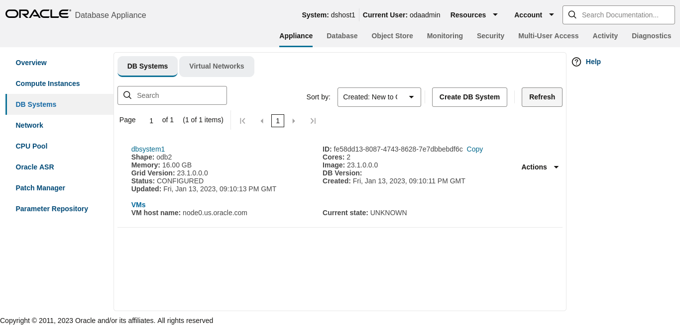

In the BUI, select DB Systems on the left, and click Create.Description of bui_db_system_list.png follows
Enter the System Information, Network Information, CPU Pool and Database Information, then click Create.Description of bui_db_system_create.png follows
Note the database shape selected will determine the number of CPU cores assigned to the database. A database CPU pool is automatically created, or a database CPU Pool can be selected. A default network is also be automatically assigned to the database, or a network can be selected. Make sure CDB is selected.
You can see that a database KVM dbsystem1 is created.Description of bui_dbsystem_created_successfully.png follows
You can find the details for dbsystem1 by clicking on it.
You can modify the DB System by clicking Actions and then selecting Modify.
You can change the database shape from odb2 (2 cores) to odb4 (4 cores).
Click the DB Systems tab on the left to verify that dbsystem1 has 4 cores now.

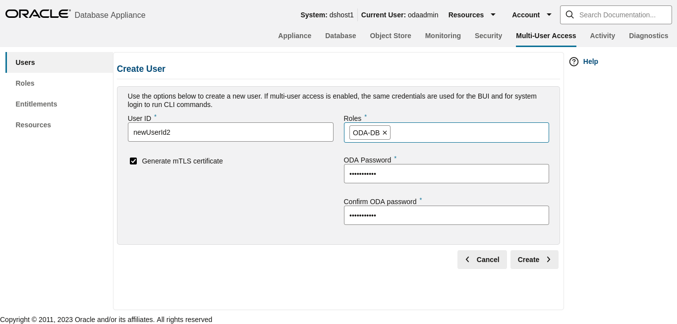

Step 1 - Create New Users
Understand the steps to create new users.
Navigate to the Multi-User Access tab in the BUI. Create a new user, user1, and provide a temporary password. The password for user1 must be changed on the first login.Description of bui_oma_create_user.png follows
Go to the Users tab on the left to verify that the new user, user1, is created.
Create a second user, user2 using the same process.
Go to the Users tab on the left to verify that user2 is created.

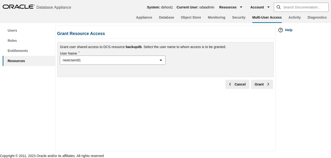

Step 2 - Grant a Resource to a User
Understand the steps to grant a resource to a user.

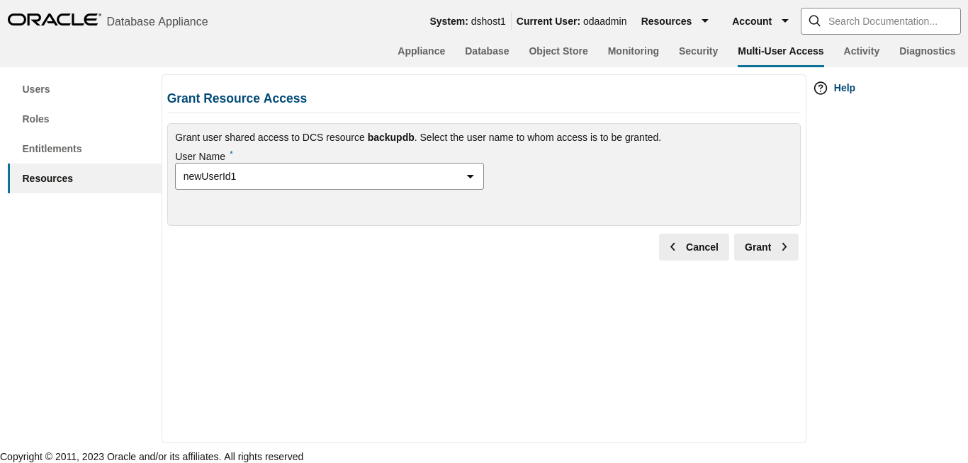

You will grant a resource, db5, to user1. Go the Resources tab on the left, click on Show Advanced Search, select ODA_DB, and click Search. On db5, click Actions, and then select Grant Resource Access.Description of bui_oma_resources_list.png follows
In the User Name drop-down, select user1, then click Grant.Description of bui_oma_grant_resource_access.png follows
To verify that user1 has access to db5, click on the Resources tab on the left again. Note that user1 now has shared access to db5. Note that this database was originally created by the odaadmin user.

Specify the temporary password created by the odaadmin user, and you are prompted to provide a new password. You can use a password similar to WELcome12## or create your own.
When you log in with the new password, note that the Current User is displayed as user1. Note that there are fewer tabs on the top for user1.Description of bui_oma_show_all_dbdhomes.png follows

Click on the Database tab. There are no database available to user2. Click Create Database.Description of bui_oma_database_landing_page.png follows

Log in as odaadmin to review resources and user access.
When logged in as the odaadmin user, you can view all the databases.

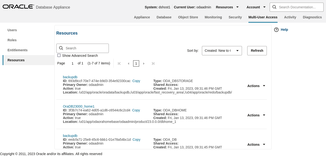

Click on the Multi-User Access tab, then click on the Resources tab on the left. Use the Advanced Search feature and search for ODA_DB, You can see the Primary Owner of the database and Shared Access users for the databases. The user1 has access to db5, and user2 has access to user2db1.

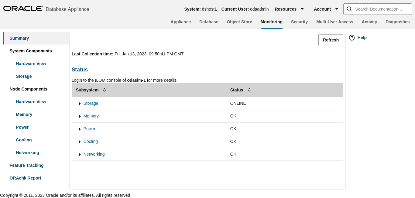

Use either the command line or the BUI to monitor Oracle Database Appliance software, hardware, and feature usage.
Oracle Database Appliance also provides security reports, diagnostic information, and context sensitive online help (documentation, FAQ, blogs). An Oracle Enterprise Manager plug-in is available if you want to use Oracle Enterprise Manager to monitor your IT infrastructure. This lab will demonstrate how to monitor Oracle Database Appliance with BUI and ODACLI commands.

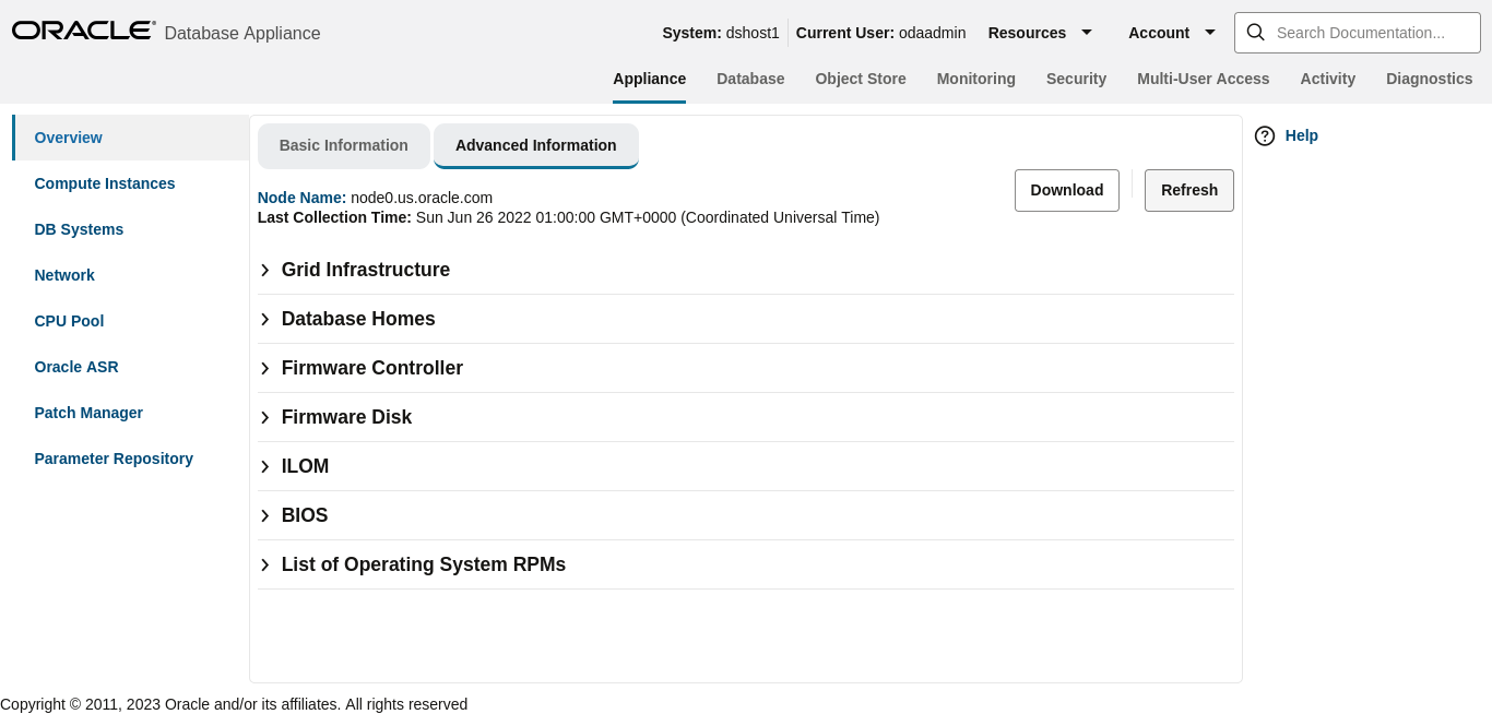

To view the Oracle Database Appliance software components, click on the Advanced Information tab on the Appliance Overview page.Description of bui_appliance_landing.png follows

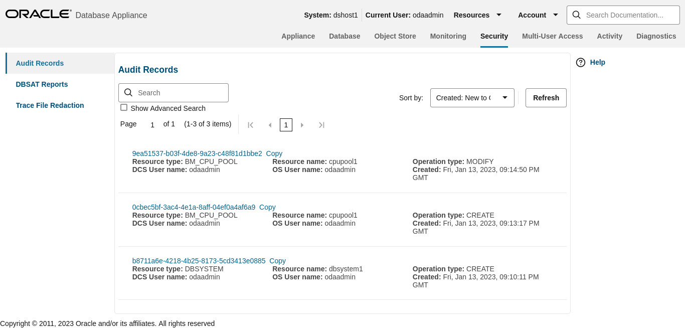

To view security-related information, click on the Security tab on the Appliance page.Description of bui_security_landing_page.png follows

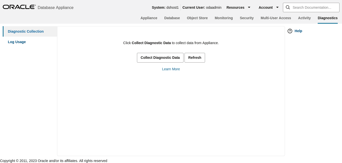

To view diagnostic and log usage information, click on the Diagnostics tab on the Appliance page.Description of bui_diagnostics_landing_page.png follows

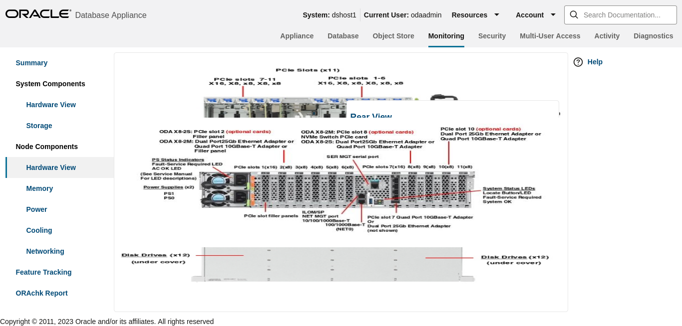

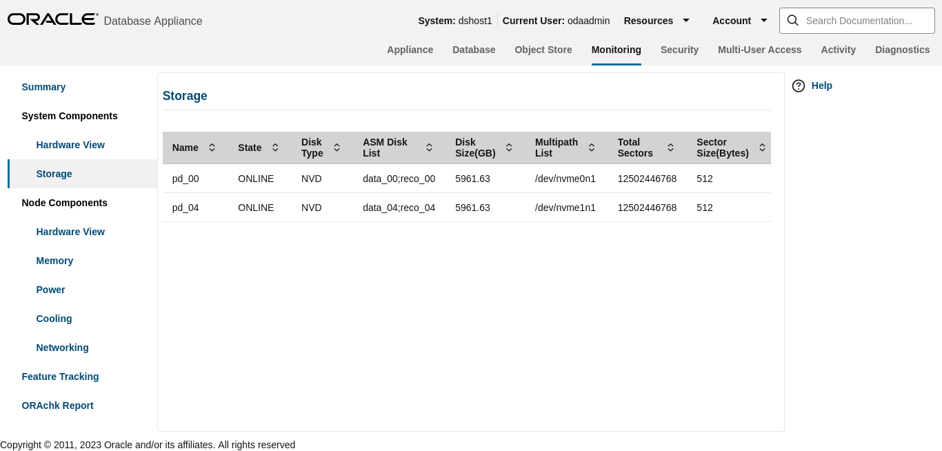

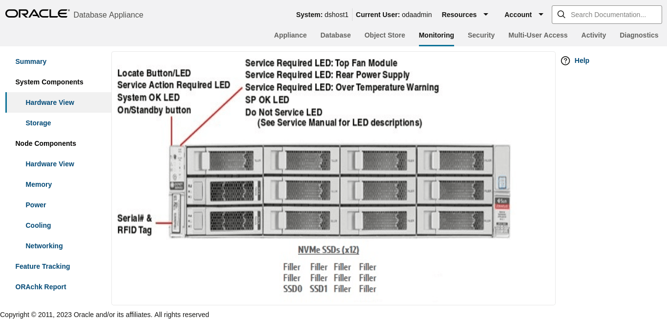

Step 2 - Hardware Monitoring and Feature Tracking

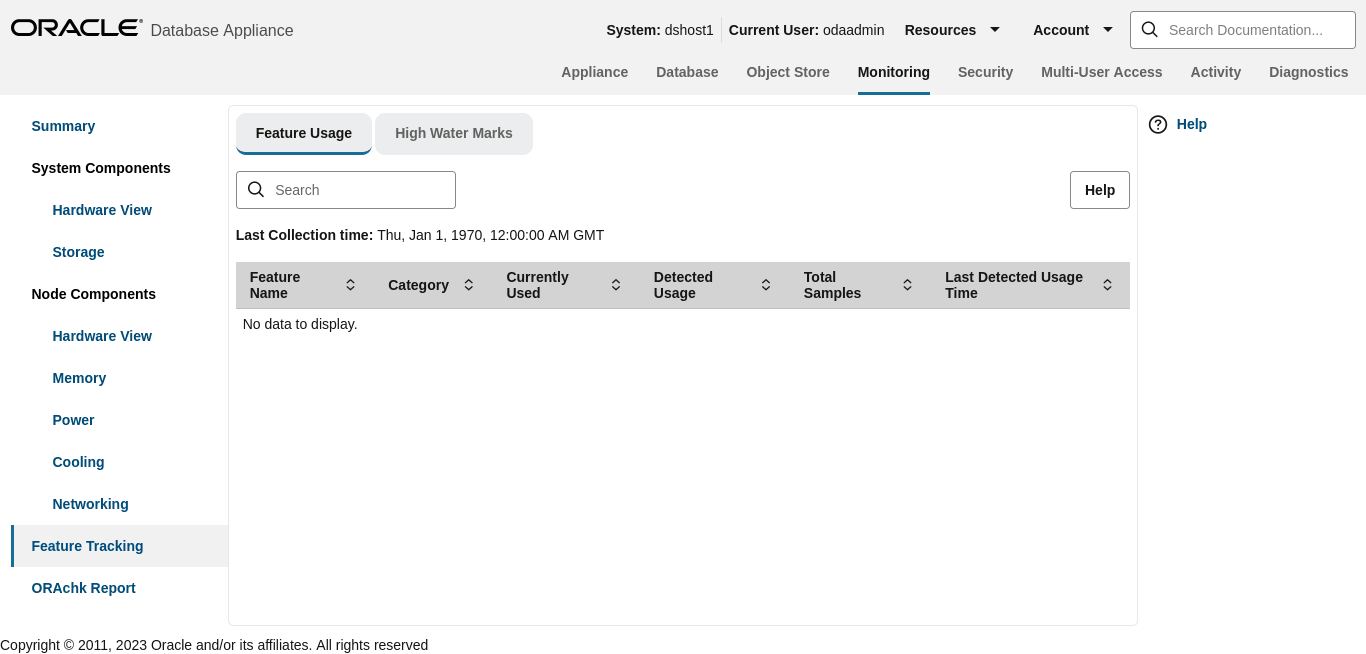

The BUI displays Oracle Database Appliance hardware status and tracks feature usage including High Water Marks.
Feature Tracking
The Feature Tracking output displayed in the simulator may not match the display on an actual Oracle Database Appliance. Following is a sample output:Description of bui_monitoring_feature_usage.png follows

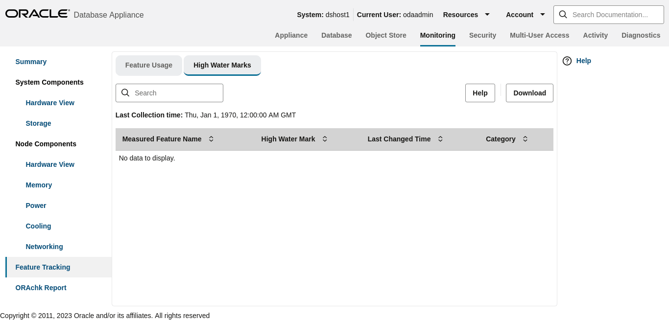

High Water Marks
The High Water Marks output displayed in the simulator may not match the display on an actual Oracle Database Appliance.Description of bui_high_water_marks.png follows

Command: odaadmcli show storage
Description: The following command displays the storage controllers and drives.
$ sudo odaadmcli show storage
==== BEGIN STORAGE DUMP ========
Host Description: Oracle Corporation:ORACLE SERVER X7-2
Total number of controllers: 2
              Id         = 0
              Serial Num = 500605b00d3e88c0
              Vendor     = LSI Logic
              Model      = ORCL-EXT-SAS3
              FwVers     = 13.00.00.00
              strId      = mpt3sas:3b:00.0
              Id         = 1
              Serial Num = 500605b00d3e8450
              Vendor     = LSI Logic
              strId      = mpt3sas:5e:00.0
Total number of expanders: 2
              Id         = 0
              Serial Num = 50800200022f163f
              Vendor     = ORACLE
              Model      = DE3-24C
              FwVers     = 0306
              strId      = Secondary
              WWN        = 50800200022e41be
              Id         = 1
              Vendor     = ORACLE
              Model      = DE3-24C
              FwVers     = 0306
              strId      = Primary
              WWN        = 50800200022e447e
Total number of PDs: 24
              /dev/sdaa       HGST              HDD 9796gb slot:  0  exp:  0   H7210A520SUN010T
              /dev/sdab       HGST              HDD 9796gb slot:  1  exp:  0   H7210A520SUN010T
              /dev/sdac       HGST              HDD 9796gb slot:  2  exp:  0   H7210A520SUN010T
              /dev/sdad       HGST              HDD 9796gb slot:  3  exp:  0   H7210A520SUN010T
              /dev/sdae       HGST              HDD 9796gb slot:  4  exp:  0   H7210A520SUN010T
              /dev/sdaf       HGST              HDD 9796gb slot:  5  exp:  0   H7210A520SUN010T
              /dev/sdag       HGST              HDD 9796gb slot:  6  exp:  0   H7210A520SUN010T
              /dev/sdah       HGST              HDD 9796gb slot:  7  exp:  0   H7210A520SUN010T
              /dev/sdai       HGST              HDD 9796gb slot:  8  exp:  0   H7210A520SUN010T
              /dev/sdaj       HGST              HDD 9796gb slot:  9  exp:  0   H7210A520SUN010T
              /dev/sdak       HGST              HDD 9796gb slot: 10  exp:  0   H7210A520SUN010T
              /dev/sdal       HGST              HDD 9796gb slot: 11  exp:  0   H7210A520SUN010T
              /dev/sdam       HGST              HDD 9796gb slot: 12  exp:  0   H7210A520SUN010T
              /dev/sdan       HGST              HDD 9796gb slot: 13  exp:  0   H7210A520SUN010T
              /dev/sdao       HGST              HDD 9796gb slot: 14  exp:  0   H7210A520SUN010T
              /dev/sdap       HGST              SSD 3200gb slot: 15  exp:  0   HBCAC2DH2SUN3.2T
              /dev/sdaq       HGST              SSD 3200gb slot: 16  exp:  0   HBCAC2DH2SUN3.2T
              /dev/sdar       HGST              SSD 3200gb slot: 17  exp:  0   HBCAC2DH2SUN3.2T
              /dev/sdas       HGST              SSD 3200gb slot: 18  exp:  0   HBCAC2DH2SUN3.2T
              /dev/sdat       HGST              SSD 3200gb slot: 19  exp:  0   HBCAC2DH2SUN3.2T
              /dev/sdau       HGST              SSD  800gb slot: 20  exp:  0   HBCAC2DH4SUN800G
              /dev/sdav       HGST              SSD  800gb slot: 21  exp:  0   HBCAC2DH4SUN800G
              /dev/sdaw       HGST              SSD  800gb slot: 22  exp:  0   HBCAC2DH4SUN800G
              /dev/sdax       HGST              SSD  800gb slot: 23  exp:  0   HBCAC2DH4SUN800G
==== END STORAGE DUMP =========
