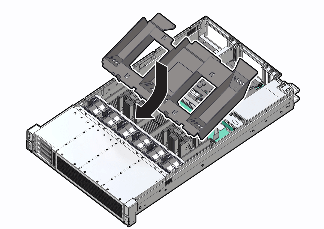

Install the Air Baffle
Install the air baffle by placing it into the server and lowering it to its inserted position.
To install the air baffle, the baffle must fit around the processor heatsinks, then lifted up about 50 degrees. Locate the tabs on the air baffle so that one tab on each side is under the lip of the fan tray, and the others are on top of the fan tray.
Description of the illustration aog-54_install-air-baffle.png -

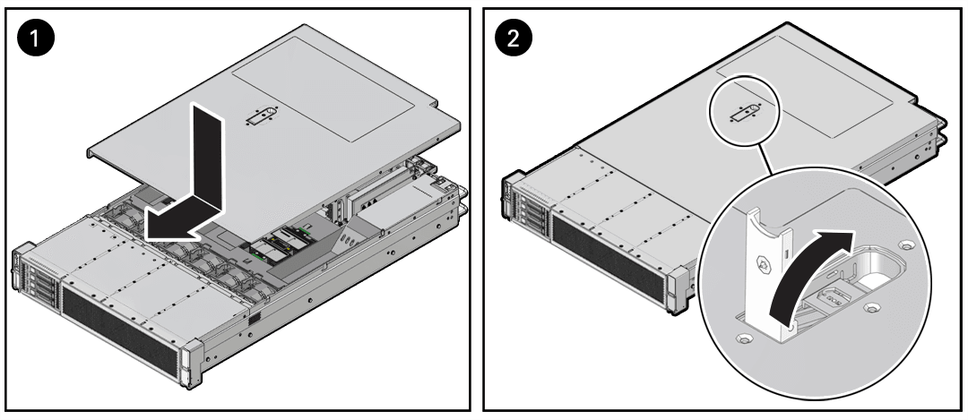

Place the top cover on the chassis [1].
Set the cover down so that it hangs over the back of the server by about 1 inch (25 mm) and the side latches align with the cutouts in the chassis.
Check both sides of the chassis to ensure that the top cover is fully down and flush with the chassis. If the cover is not fully down and flush with the chassis, slide the cover towards the back of the chassis to position the cover in the correct position.
Gently slide the cover toward the front of the chassis. As you slide the cover toward the front of the server, the release button on the top of the server automatically rotates downward to the closed position.
Description of the illustration mm-10866_4-drive-install-cover.png -
- Latch the top cover closed by pushing down on the button until it is flush with the
cover and you hear an audible click [2].
An audible click indicates that the cover is latched.
- Use a Torx T15 screwdriver to turn the release button latch counter-clockwise to the locked position.

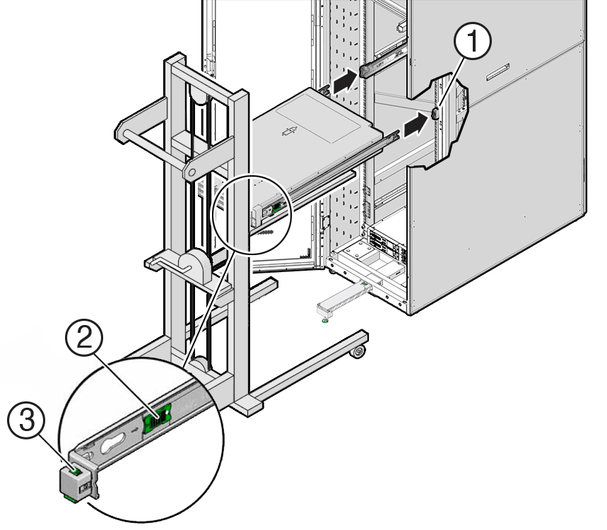

- Position the server so that the back ends of the mounting brackets are aligned with the slide-rail assemblies that are mounted in the rack.
- Insert the mounting brackets into the slide-rails, and then push the server into
the rack until the mounting brackets are flush with the slide-rail stops
(approximately 30 cm or 12 inches).
Description of the illustration aog-250_server-mtng-brkt-rack.pngCall Out Description 1
Inserting mounting bracket into slide-rail
2
Slide-rail release button
3
Slide-rail lock
- Simultaneously push and hold the green slide-rail release buttons on each mounting
bracket while you push the server into the rack. Continue pushing the server into the
rack until the slide-rail locks (on the front of the mounting brackets) engage the
slide-rail assemblies with an audible click.

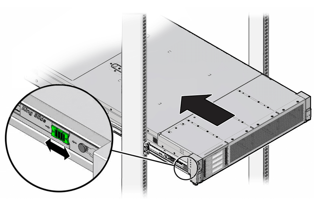

Return the Server to the Normal Rack Position
If the server is in the extended maintenance position, use this procedure to return the server to the normal rack position.
Push the server back into the rack, as described in the following steps.
Simultaneously pull and hold the two green release tabs (one on each side of the slide rails on the server) toward the front of the server, while you push the server into the rack.
Verify that the cable management arm (CMA) retracts without binding.
To pull the green release tab, place your finger in the center of the tab, not on the end, and apply pressure as you pull the tab toward the front of the server.
Description of the illustration aog-248_maint-position-latch-release.png -
Continue pushing the server into the rack until the slide-rail locks (on the front of the server) engage the slide-rail assemblies.
You hear an audible click when the server is in the normal rack position.

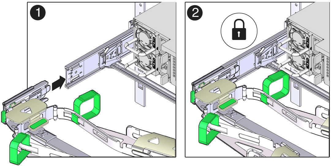

To install CMA connector A into the left slide-rail:
Insert CMA connector A into the front slot on the left slide-rail
until it locks into place with an audible click [1 and 2].
The connector A tab (callout 1) goes into the slide-rail front slot (callout 2).
Gently tug on the left side of the front slide bar to verify that
connector A is properly seated.
Connector A tab
2
Left slide-rail front slot

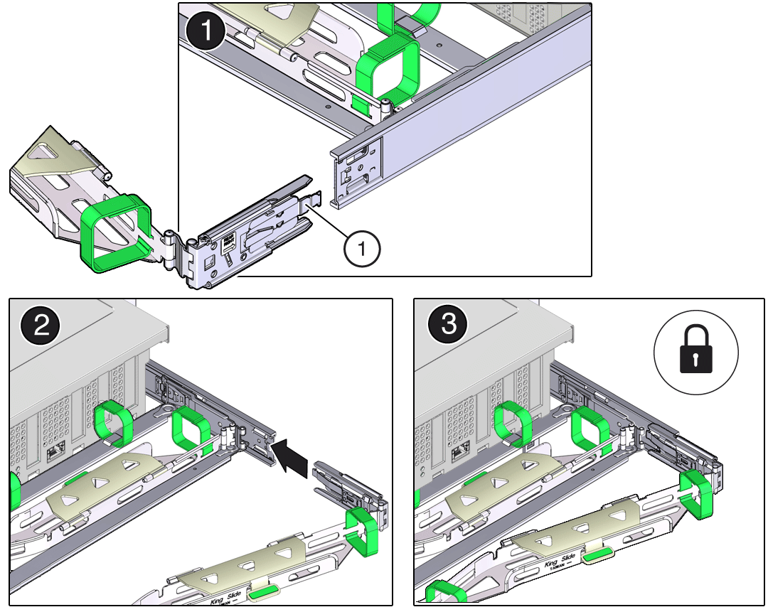

To install CMA connector C into the right slide-rail:
Align connector C with the slide-rail so that the locking spring
(callout 1) is positioned inside (server side) of the right
slide-rail [1].
Description of the illustration mm-10236_rt_slide_rear_conn.pngCall Out Description 1
Connector C locking spring
- Insert connector C into the right slide-rail until it locks into place with an audible click [2 and 3].
- Gently tug on the right side of the CMA back slide bar to verify that connector C is properly seated.
slide-rail [1].

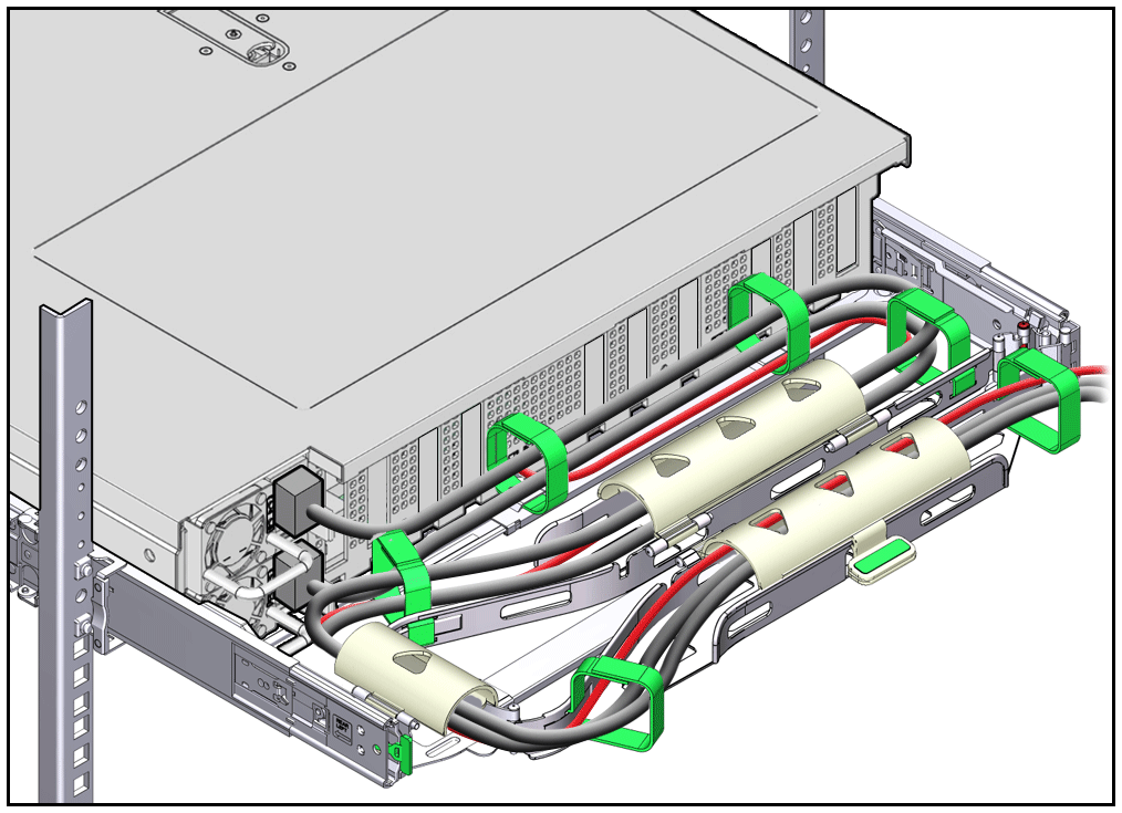

Open the CMA cable covers, route the server cables through the CMA cable
troughs (in the order specified in the following steps), close the cable
covers, and secure the cables with the six Velcro straps.
- First through the front-most cable trough.
- Then through the small cable trough.
Then through the back-most cable trough.
Caution:
When securing the cables with the Velcro straps located on the front slide bar, ensure that the Velcro straps do not wrap around the bottom of the slide bar. Otherwise, expansion and contraction of the slide bar might be hindered when the server is extended from the rack and returned to the rack.
Ensure that the secured cables do not extend above the top or below the
bottom of the server to which they are attached.
Otherwise, the cables might snag on other equipment installed in the rack when the server is extended from the rack or returned to the rack.
If necessary, bundle the cables with additional Velcro straps to ensure
that they stay clear of other equipment.
If you need to install additional Velcro straps, wrap the straps around the cables only, not around any of the CMA components. Otherwise, expansion and contraction of the CMA slide bars might be hindered when the server is extended from the rack and returned to the rack.
