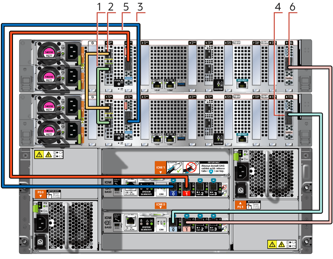

Cabling the Storage for Oracle Database Appliance X10-HA
Connect the storage cables for Oracle Database Appliance 10-HA.
Table 3-1 Storage Cabling for Oracle Database Appliance X10-HA
| Callout Number | Purpose | Start - Compute Node0 | End - Compute Node1 |
| 1 | Connect green SFP28 cable (Interconnect Port 25GbE) | Connect into green port (PORT 2) in PCIe slot 1 | Connect into green port (PORT 2) in PCIe slot 1 |
| 2 | Connect yellow SFP28 cable (Interconnect Port 25GbE) | Connect into yellow port (PORT 1) in PCIe slot 1 | Connect into yellow port (PORT 1) in PCIe slot 1 |
| 3 | Connect dark blue SAS cable | Connect into dark blue port (SAS0) in PCIe slot 2 in Node0 | Connect into dark blue port in top IO Module (PORT 0) |
| 4 | Connect light blue SAS cable | Connect into light blue port (SAS1) in PCIe slot 9 in Node0 | Connect into light blue port in bottom IO Module (PORT 0) |
| 5 | Connect dark red SAS cable | Connect into dark red port (SAS1) in PCIe slot 2 in Node1 | Connect into dark red port in top IO Module (PORT 1) |
| 6 | Connect light red SAS cable | Connect into light red port (SAS0) in PCIe slot 9 in Node1 | Connect into light red port in bottom IO Module (PORT 1) |

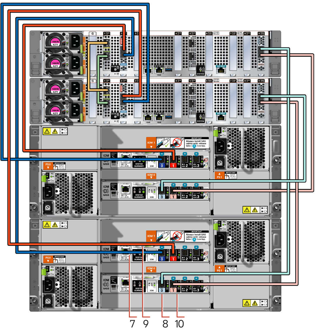

Cabling the Storage Expansion Shelf
Description of the illustration storage_cables_with_extension_shelf_for_x10-2-ha.png
Table 3-2 Cabling the Storage Expansion Shelf for Oracle Database Appliance X10-HA
| Callout Number | Purpose | Start - Compute Nodes | End - Expansion Shelf |
| 7 | Connect dark blue SAS cable | Connect into dark blue port (SAS0) in PCIe slot 2 in Node1 | Connect into dark blue port in top IO Module (PORT 0) |
| 8 | Connect light blue SAS cable | Connect into light blue port (SAS1) in PCIe slot 9 in Node1 | Connect into light blue port in bottom IO Module (PORT 0) |
| 9 | Connect dark red SAS cable | Connect into dark red port (SAS1) in PCIe slot 2 in Node0 | Connect into dark red port in top IO Module (PORT 1) |
| 10 | Connect light red SAS cable | Connect into light red port (SAS0) in PCIe slot 9 in Node0 | Connect into light red port in bottom IO Module (PORT 1) |
