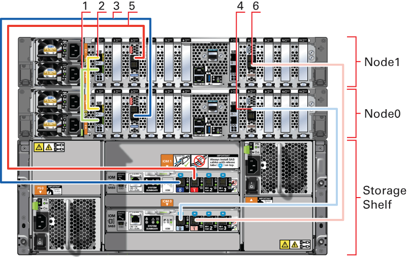

Cabling the Storage for Oracle Database Appliance X8-2-HA
Connect the storage cables for Oracle Database Appliance X8-2-HA.
Table 3-1 Storage Cabling for Oracle Database Appliance X8-2-HA
| Callout Number | Purpose | Start - Compute Node0 | End - Compute Node1 |
1 |
Connect green SFP+ cable (Interconnect Port 25GbE) | Connect into green port (PORT 2) in PCIe slot 1 |
2 |
Connect yellow SFP+ cable
Connect into yellow port (PORT 1) in PCIe slot 1 |
3 |
Connect dark blue SAS cable | Connect into dark blue port (SAS0) in PCIe slot 3 in Node0 |
Connect into dark blue port in top IO Module (PORT 0) |
4 |
Connect light blue SAS cable | Connect into light blue port (SAS1) in PCIe slot 8 in Node0 |
Connect into light blue port in bottom IO Module (PORT 0) |
5 |
Connect dark red SAS cable | Connect into dark red port (SAS1) in PCIe slot 3 in Node1 |
Connect into dark red port in top IO Module (PORT 1) |
6 |
Connect light red SAS cable | Connect into light red port (SAS0) in PCIe slot 8 in Node1 |
Connect into light red port in bottom IO Module (PORT 1) |

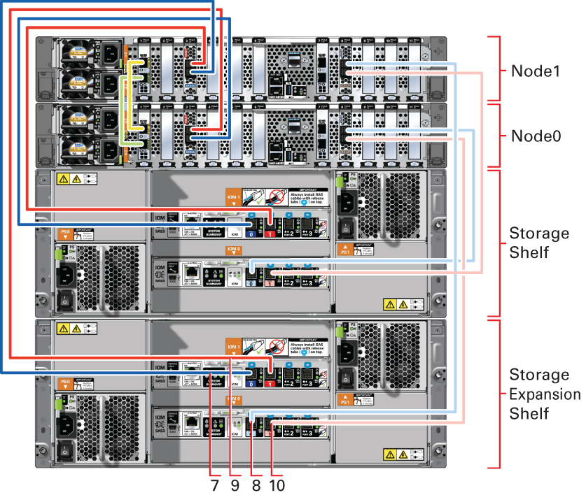

Cabling the Storage Expansion Shelf
Table 3-2 Cabling the Storage Expansion Shelf for Oracle Database Appliance X8-2-HA
| Callout Number | Purpose | Start - Compute Nodes | End - Expansion Shelf |
7 |
Connect dark blue SAS cable | Connect into dark blue port (SAS0) in PCIe slot 3 in Node1 |
8 |
Connect light blue SAS cable | Connect into light blue port (SAS1) in PCIe slot 8 in Node1 |
9 |
Connect dark red SAS cable | Connect into dark red port (SAS1) in PCIe slot 3 in Node0 |
10 |
Connect light red SAS cable | Connect into light red port (SAS0) in PCIe slot 8 in Node0 |

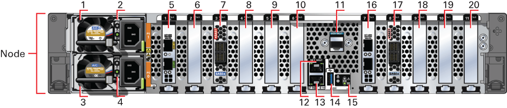

Attaching Network Cables to Oracle Database Appliance X8-2-HA
Connect Oracle Database Appliance X8-2-HA to either a 10GBase-T (copper) or 25GbE SFP28 (fiber) network.
The SFP28 ports support 10Gb and 25Gb fibre and twinaxial cable (twinax), depending on the SFP modules used in these ports. For 10GBase-T public networking, use the Cat-6 network cables. To use the SFP28 ports, use the correct transceivers and cables to meet your switch bandwidth. The following sections show the cabling options for 10GBase and 25GbE SFP28 (fiber) network ports.
Connecting the Fiber and Copper Network Cables for Oracle Database Appliance X8-2-HA
Table 3-3 Network Ports and Cabling
| Callout | Description |
| 1 | Power Supply (PS) 1 with fan module |
| 2 | Power Supply (PS) 1 status indicators: Service Required LED: amber, AC OK LED: green |
| 3 | Power Supply (PS) 0 with fan module |
| 4 | Power Supply (PS) 0 status indicators: Service Required LED: amber, AC OK LED: green |
| 5 | PCIe card slot 1: Oracle Dual Port 25Gb Ethernet Adapter provides two ports with SFP28 connections for a private cluster interconnect between server nodes |
| 6 | PCIe card slot 2: filler panel, or optional Oracle Dual Port 25Gb Ethernet Adapter, or optional Oracle Quad Port 10GBase-T Adapter |
| 7 | PCIe card slot 3: provides two SAS3 connectors used to connect the servers to the storage shelf and the storage expansion shelf |
| 8-10 | PCI card slots 4-6: filler panels |
| 11 | SER MGT port: RJ-45 serial port used to connect to the Oracle ILOM service processor. |
| 12 | NET MGT port: 10/100/1000Base-T network interface port with RJ-45 connector used to connect to the Oracle ILOM service processor. |
| 13 | 100/1000Base-T network interface port with RJ-45 connector: NET 0 |
| 14 | USB 3.0 connector |
| 15 | System status indicators: Locate LED: white, Service Required LED: amber, Power/OK LED: green |
| 16 | PCIe card slot 7: Oracle Dual Port 25Gb Ethernet Adapter or Oracle Quad Port 10GBase-T Adapter |
| 17 | PCIe card slot 8: provides two SAS3 connectors used to connect the servers to the storage shelf and the storage expansion shelf |
| 18 | PCIe card slot 9: filler panel |
| 19 | PCIe card slot 10: filler panel, or optional Oracle Dual Port 25Gb Ethernet Adapter, or optional Oracle Quad Port 10GBase-T Adapter |
| 20 | PCIe card slot 11: filler panel |

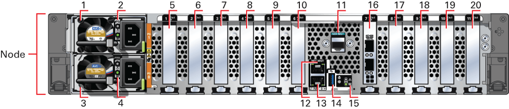

Attaching Network Cables to Oracle Database Appliance X8-2S or X8-2M
Connect Oracle Database Appliance X8-2S or X8-2M to either a 10GBase-T (copper) or 25GbE SFP28 (fiber) network.
Connecting Network Cables for Oracle Database Appliance X8-2S or X8-2M
Connect the Fiber and Copper Network Cables for Oracle Database Appliance X8-2S or X8-2M
Table 3-8 Network Ports and Power Cabling
| 5 | PCIe card slot 1: filler panel |
| 6 |
PCIe card slot 2: Oracle Database Appliance X8-2S: filler panel Oracle Database Appliance X8-2M: filler panel, or optional Oracle Dual Port 25Gb Ethernet Adapter, or optional Oracle Quad Port 10GBase-T Adapter |
| 7-8 | PCIe card slot 3 and PCI card slot 4:
Oracle Database Appliance X8-2S: filler panel Oracle Database Appliance X8-2M: Oracle NVMe Switch PCIe card |
| 9-10 | PCI card slots 5-6: filler panels |
Oracle Database Appliance X8-2S: filler panel, or optional Oracle Dual Port 25Gb Ethernet Adapter, or optional Oracle Quad Port 10GBase-T Adapter Oracle Database Appliance X8-2M: Oracle NVMe Switch PCIe card |
| 18 | PCIe card slot 9: Oracle NVMe Switch PCIe card |
