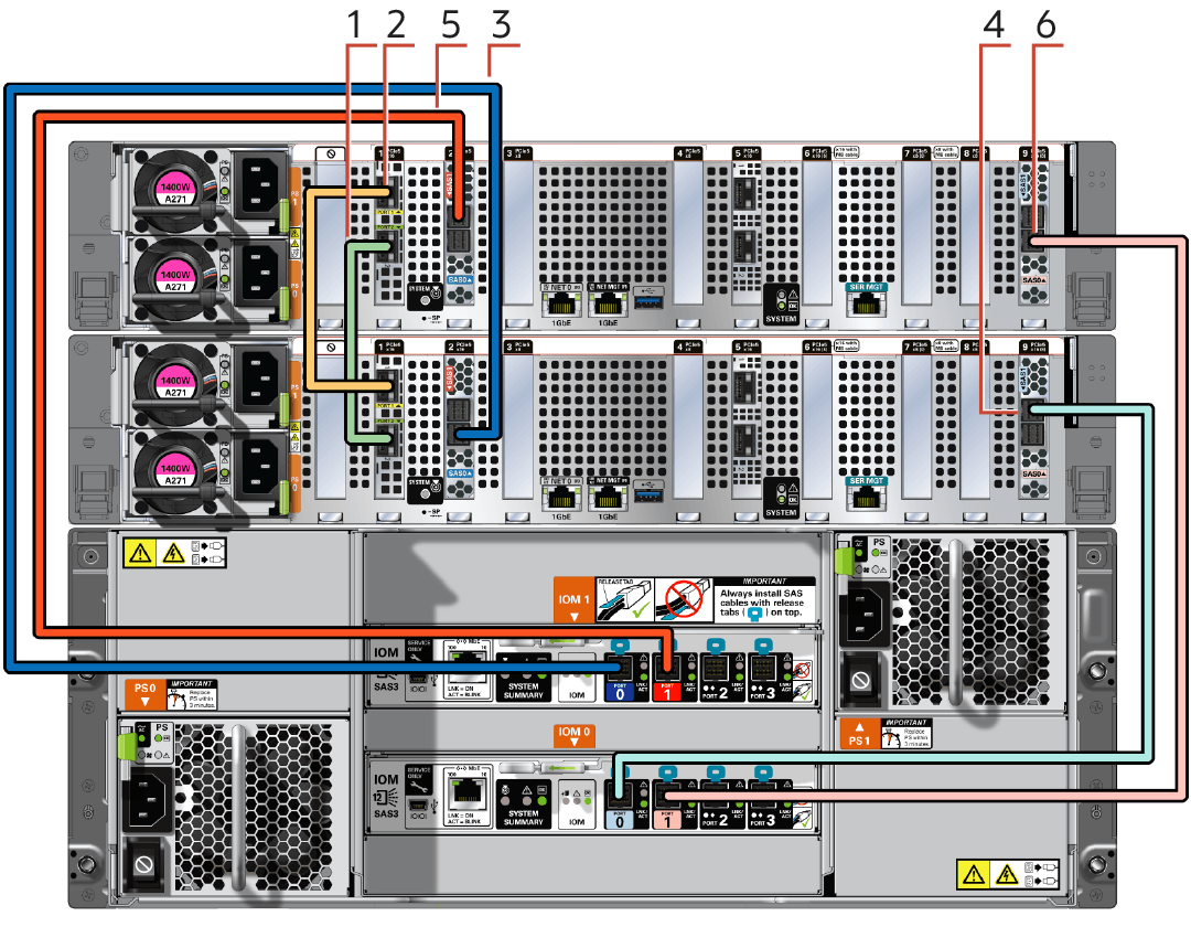

Cabling the Storage for Oracle Database Appliance X10-HA
Connect the storage cables for Oracle Database Appliance 10-HA.
Table 3-1 Storage Cabling for Oracle Database Appliance X10-HA
| Callout Number | Purpose | Start - Compute Node0 | End - Compute Node1 |
1 |
Connect green SFP28 cable (Interconnect Port 25GbE) | Connect into green port (PORT 2) in PCIe slot 1 |
2 |
Connect yellow SFP28 cable
Connect into yellow port (PORT 1) in PCIe slot 1 |
3 |
Connect dark blue SAS cable | Connect into dark blue port (SAS0) in PCIe slot 2 in Node0 |
Connect into dark blue port in top IO Module (PORT 0) |
4 |
Connect light blue SAS cable | Connect into light blue port (SAS1) in PCIe slot 9 in Node0 |
Connect into light blue port in bottom IO Module (PORT 0) |
5 |
Connect dark red SAS cable | Connect into dark red port (SAS1) in PCIe slot 2 in Node1 |
Connect into dark red port in top IO Module (PORT 1) |
6 |
Connect light red SAS cable | Connect into light red port (SAS0) in PCIe slot 9 in Node1 |
Connect into light red port in bottom IO Module (PORT 1) |

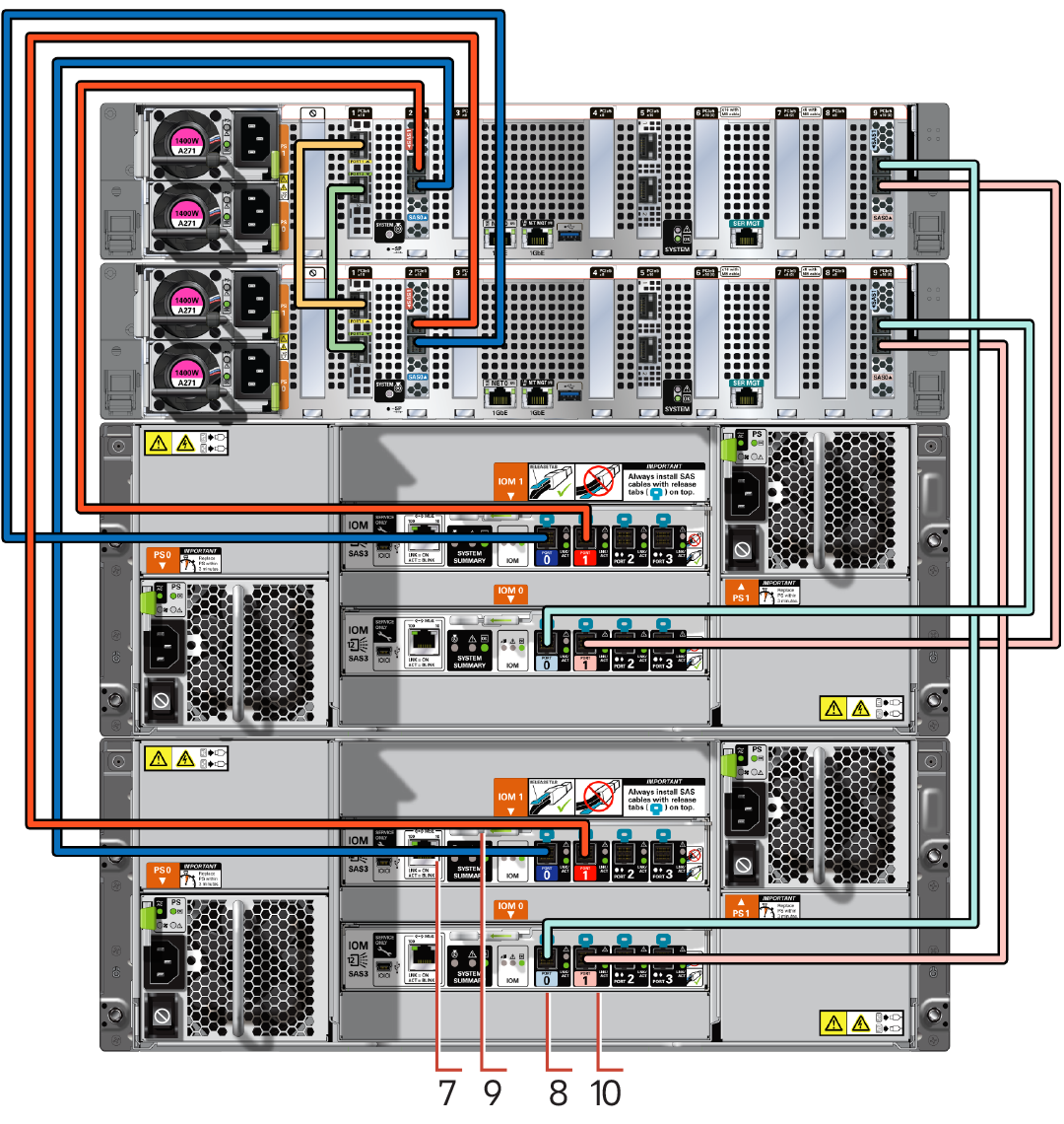

Cabling the Storage Expansion Shelf
Description of the illustration storage_cables_with_extension_shelf_for_x10-2-ha.png
Table 3-2 Cabling the Storage Expansion Shelf for Oracle Database Appliance X10-HA
| Callout Number | Purpose | Start - Compute Nodes | End - Expansion Shelf |
7 |
Connect dark blue SAS cable | Connect into dark blue port (SAS0) in PCIe slot 2 in Node1 |
8 |
Connect light blue SAS cable | Connect into light blue port (SAS1) in PCIe slot 9 in Node1 |
9 |
Connect dark red SAS cable | Connect into dark red port (SAS1) in PCIe slot 2 in Node0 |
10 |
Connect light red SAS cable | Connect into light red port (SAS0) in PCIe slot 9 in Node0 |

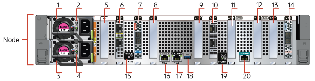

Attaching Network Cables to Oracle Database Appliance X10-HA
Connect Oracle Database Appliance X10-HA to either a 10GBase-T (copper) or 25GbE SFP28 (fiber) network.
The SFP28 ports support 10Gb and 25Gb fibre and twinaxial cable (twinax), depending on the SFP modules used in these ports. For 10GBase-T public networking, use the Cat-6 network cables. To use the SFP28 ports, use the correct transceivers and cables to meet your switch bandwidth. The following sections show the cabling options for 10GBase and 25GbE SFP28 (fiber) network ports.
Connecting the Fiber and Copper Network Cables for Oracle Database Appliance X10-HA
Table 3-3 Network Ports and Power Cabling
| Callout | Description |
| 1 | Power Supply (PS) 1 with fan module |
| 2 | Power Supply (PS) 1 status indicators: Service Required LED: amber, AC OK LED: green |
| 3 | Power Supply (PS) 0 with fan module |
| 4 | Power Supply (PS) 0 status indicators: Service Required LED: amber, AC OK LED: green |
| 5 | Not used |
| 6 | PCIe card slot 1: Oracle Dual Port 25Gb Ethernet Adapter which provides two ports for a private cluster interconnect between server nodes |
| 7 | PCIe card slot 2: provides two SAS3 connectors used to connect the servers to the storage shelf and the storage expansion shelf |
| 8 | PCIe card slot 3: filler panel |
| 9 | PCIe card slot 4: filler panel, or 2nd optional Oracle Dual Port 25Gb Ethernet Adapter or Oracle Quad Port 10GBase-T Adapter |
| 10 | PCIe card slot 5: 1st Oracle Dual Port 25Gb Ethernet Adapter or Oracle Quad Port 10GBase-T Adapter |
| 11 | PCIe card slot 6: filler panel |
| 12 | PCIe card slot 7: filler panel |
| 13 | PCIe card slot 8: filler panel, or 3rd optional Oracle Dual Port 25Gb Ethernet Adapter or Oracle Quad Port 10GBase-T Adapter |
| 14 | PCIe card slot 9: provides two SAS3 connectors used to connect the servers to the storage shelf and the storage expansion shelf |
| 15 | Locate LED (white) |
| 16 | 100/1000Base-T network interface port with RJ-45 connector: NET 0 |
| 17 | NET MGT port: 10/100/1000Base-T network interface port with RJ-45 connector used to connect to the Oracle ILOM service processor |
| 18 | USB 3.1 connector |
| 19 | System status indicators: Service Required LED (amber), Power/OK LED (green) |
| 20 | SER MGT port: RJ-45 serial port used to connect to the Oracle ILOM service processor |

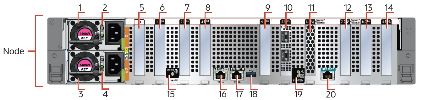

Attaching Network Cables to Oracle Database Appliance X10-S or X10-L
Connect Oracle Database Appliance X10-S or X10-L to either a 10GBase-T (copper) or 25GbE SFP28 (fiber) network.
Connecting Network Cables for Oracle Database Appliance X10-S or X10-L
Connect the Fiber and Copper Network Cables for Oracle Database Appliance X10-S or X10-L
Table 3-8 Network Ports and Power Cabling
| 5 | Not used |
| 11 | PCIe card slot 6: Oracle Retimer PCIe Card |

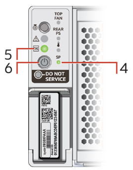

Powering On Oracle Database Appliance the First Time
Use this procedure the first time you power on Oracle Database Appliance.
When you power on Oracle Database Appliance for the first time, the system automatically defines your public network interface based on which of the public interface ports are connected. For Oracle Database Appliance X10-2-HA, the dual-port 10/25 GbE SFP28 PCIe adapter is used for the cluster interconnect.
After you connect power cords, the green SP OK light-emitting diode (LED) lights blink for a few minutes, and then turn to steady ON. The cooling fans also may turn on. However, these events do not indicate that the system is started. You must complete all of the steps in this section to turn on the appliance properly. Read through the entire section to understand the sequence required for initial system startup.Parent topic: Readying Oracle Database Appliance for Deployment
