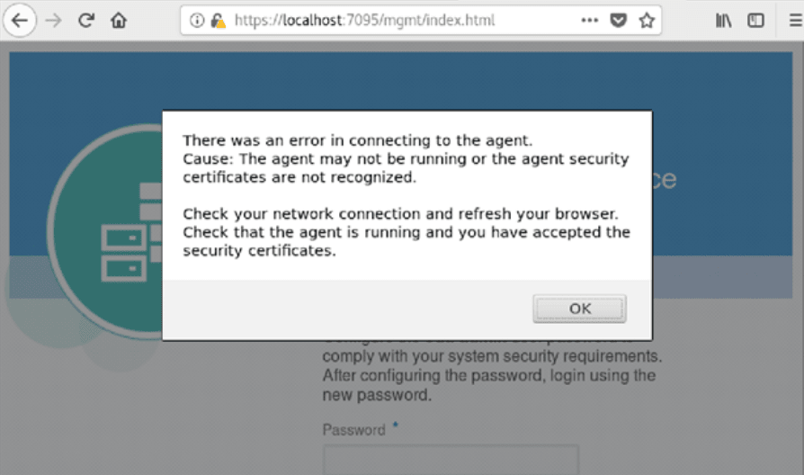

About BUI Agent Certificate Issue
Understand the common BUI issues you may encounter when setting up the Oracle Database Appliance simulator.
Requirements
You may encounter a BUI Agent Certificate Issue. See the following example:
https://server IP:7098/mgmt/index.html
Your assigned port number maybe different
You may see a BUI agent security certificate error message:
Description of bui_certificates_error.png follows
To fix it, you must add a certificate exception to the BUI agent port, with is your assigned port number -1. In this case, the port number is 7098.
( Your port number maybe different)
Go through the certificate exception process and add the exception. Then go back to your assigned port.
Go through the certificate exception process again and add the exception. Then you can access the BUI to create the appliance.
