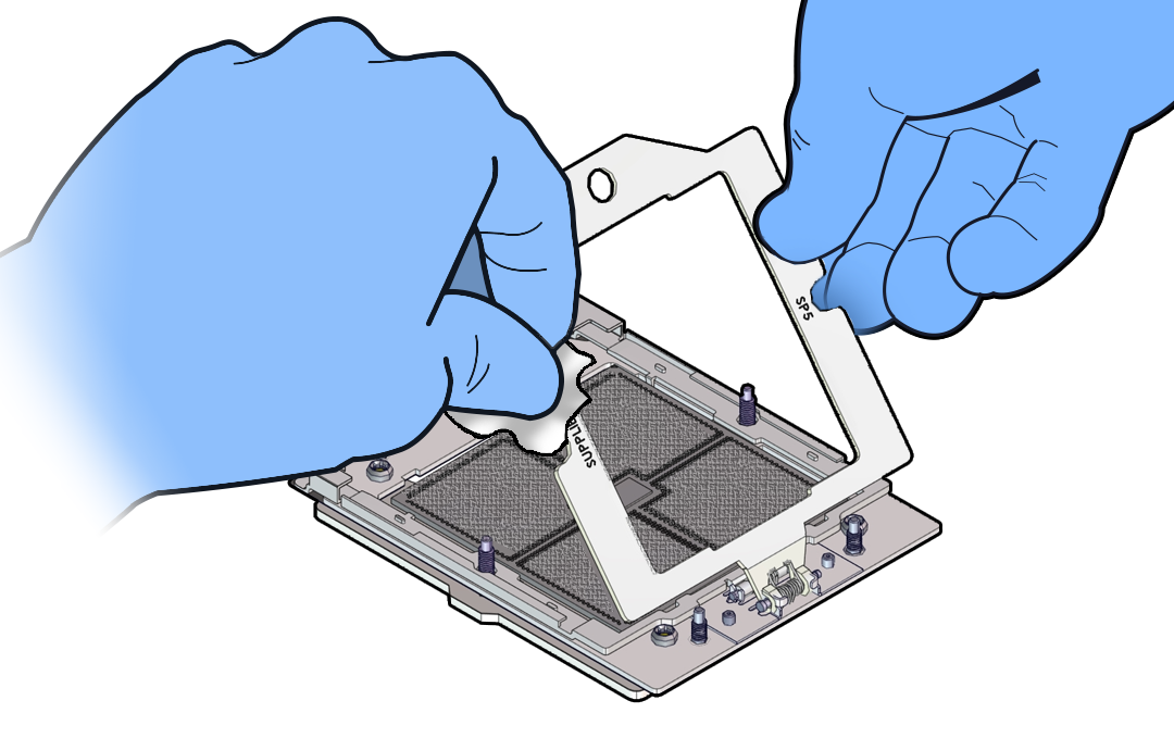

Identify and Remove a Processor
Use ESD gloves (not latex or vinyl), if possible, when handling the processor.

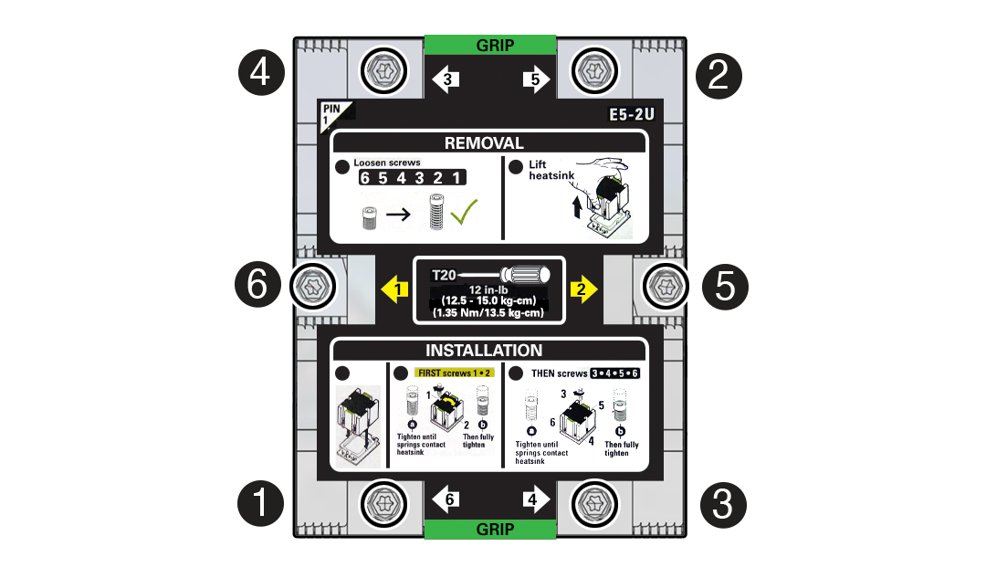

- Obtain a torque driver set to 12 in-lb (inch-pound) (1.35 Nm/13.5 kg-cm) force with T20 Torx bit for processor and heatsink removal.
Be careful not to touch the processor socket pins.
Caution:
The processor socket pins are very fragile. A light touch can bend the processor socket pins beyond repair. -

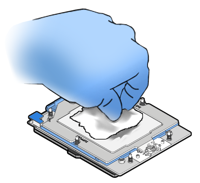

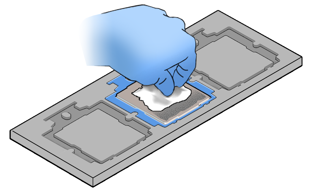

Remove thermal grease from the processor and any on the socket assembly before removing the carrier with the processor.
If thermal grease falls into the socket, there is no way to remove it without damaging the socket.
Do not allow the thin layer of thermal grease between the heatsink and the processor to contaminate the workspace or other components.
Failure to remove and replace thermal grease with new thermal grease can result in processor overheating.

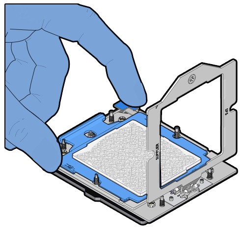

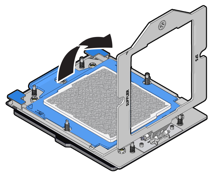

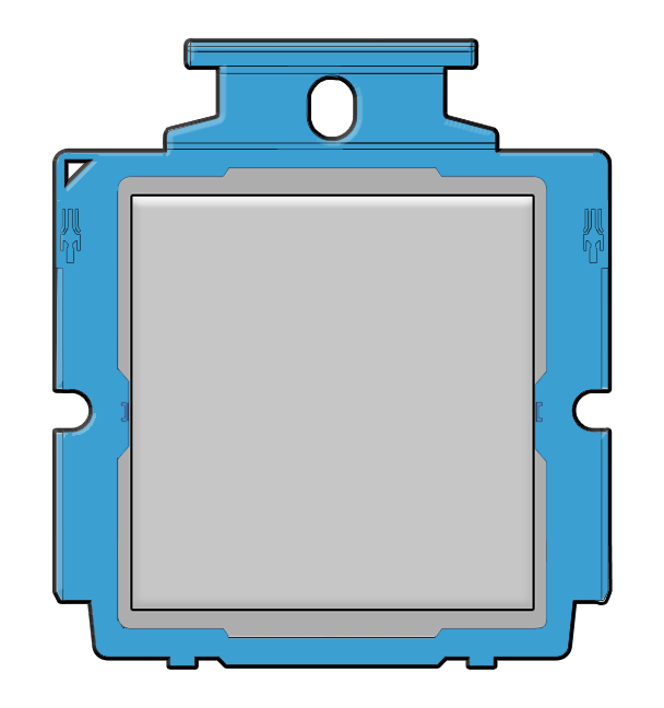

- Never remove the processor from the carrier. Replacement processors come
with a carrier package.

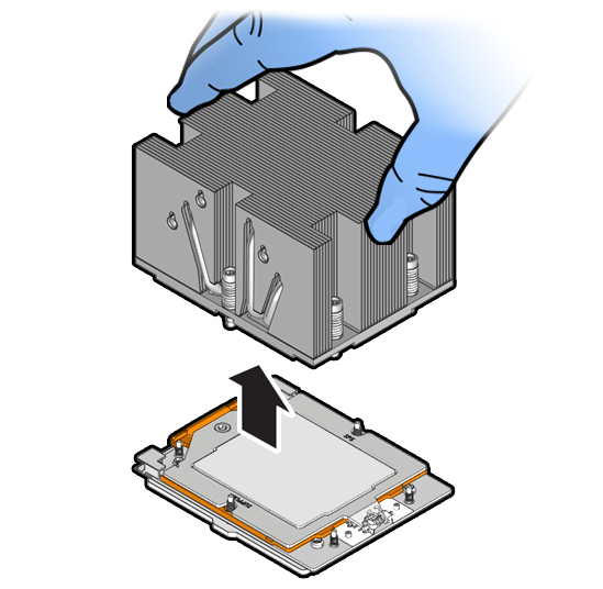

Whenever you remove a processor on a usable motherboard, replace it with another processor and reinstall the processor heatsink; otherwise, the server might overheat due to improper airflow. See Install a Processor.
