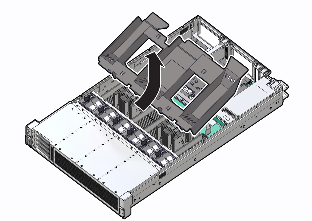

Remove the air baffle by lifting the baffle up and out of the server.
Lift up the air baffle in the rear at a 50 degree angle, and slide slightly rearward to clear the air baffle tabs that prevent the front of the baffle from lifting up.
- Set aside the air baffle.
