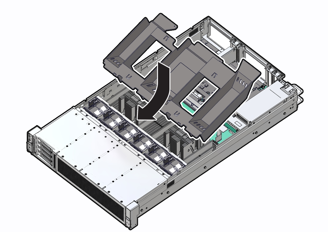

Install the Air Baffle
Install the air baffle by placing it into the server and lowering it to its inserted position.
To install the air baffle, the baffle must fit around the processor heatsinks, then lifted up about 50 degrees. Locate the tabs on the air baffle so that one tab on each side is under the lip of the fan tray, and the others are on top of the fan tray.
Consider your next step:
If you removed the air baffle as part of another procedure, return to that procedure.
Otherwise, continue to with this procedure.
Return the server to operation:
- Install the server top cover.
- Return the server to the normal rack position.
- Reconnect the power cords and data cables to the server.
Power on the server.
See Power On the Server.
- Verify that the power supply AC OK LED is lit.
