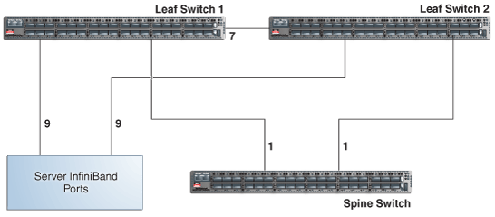

Cabling Three Switches Within a Rack
In a single rack, the two leaf switches are interconnected using seven connections. In addition, each leaf switch has one connection to the spine switch. The leaf switches connect to the spine switch as shown in Figure G-1.
Figure G-1 In-Rack Connections Between Spine Switch and Leaf Switches
Description of "Figure G-1 In-Rack Connections Between Spine Switch and Leaf Switches"
The servers connect to the leaf switches as shown in Figure G-2.
Figure G-2 In-Rack Connections Between the Servers and the Leaf Switches
Description of "Figure G-2 In-Rack Connections Between the Servers and the Leaf Switches"

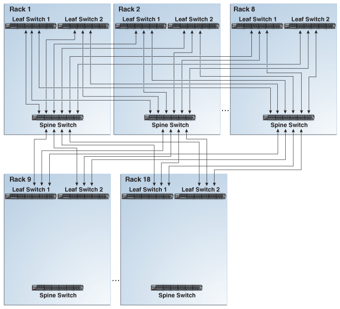

Cabling Switches in Up to 18 Racks
When you connect racks 9 through 18, remove the interswitch connections between the leaf switches, and disconnect the spine switches from the InfiniBand fabric. Figure G-5 shows that the eight links from every leaf switch connect to the spine switches in racks 1 to 8.
The connections among racks 1 to 8 do not change you add the cables for racks 9 to 18.
Figure G-5 Connecting Switches Across 18 Racks
Description of "Figure G-5 Connecting Switches Across 18 Racks"

18-Rack Cabling
Table G-47 shows the cable connections for the switches when 18 racks are cabled together. The cabling among racks 1 through 8 does not change.
Table G-47 Leaf Switch Connections for Rack 18
| Leaf Switch | Connection |
R18 IB3 to Rack 1 |
R18-IB3-P8B to R1-U1-P2A |
R18 IB3 to Rack 2 |
R18-IB3-P9A to R2-U1-P2A |
R18 IB3 to Rack 3 |
R18-IB3-P9B to R3-U1-P2A |
R18 IB3 to Rack 4 |
R18-IB3-P10A to R4-U1-P2A |
R18 IB3 to Rack 5 |
R18-IB3-P10B to R5-U1-P2A |
R18 IB3 to Rack 6 |
R18-IB3-P2A to R6-U1-P2A |
R18 IB3 to Rack 7 |
R18-IB3-P2B to R7-U1-P2A |
R18 IB3 to Rack 8 |
R18-IB3-P8A to R8-U1-P2A |
R18 IB2 to Rack 1 |
R18-IB2-P8B to R1-U1-P2B |
R18 IB2 to Rack 2 |
R18-IB2-P9A to R2-U1-P2B |
R18 IB2 to Rack 3 |
R18-IB2-P9B to R3-U1-P2B |
R18 IB2 to Rack 4 |
R18-IB2-P10A to R4-U1-P2B |
R18 IB2 to Rack 5 |
R18-IB2-P10B to R5-U1-P2B |
R18 IB2 to Rack 6 |
R18-IB2-P2A to R6-U1-P2B |
R18 IB2 to Rack 7 |
R18-IB2-P2B to R7-U1-P2B |
R18 IB2 to Rack 8 |
R18-IB2-P8A to R8-U1-P2B |
