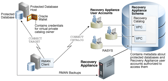

Figure 8-1 shows an RMAN client connecting to a protected database (CONNECT TARGET) and to the virtual private catalog (CONNECT CATALOG). For backup and restore operations to be possible, the credentials for the virtual private catalog owner must exist in the Oracle wallet on the protected database host.
Figure 8-1 Protected Database Access
Description of Figure 8-1 follows
Description of "Figure 8-1 Protected Database Access"
