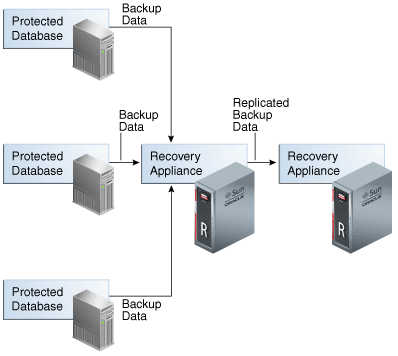

In the example Figure 1, a protected database sends backups to one Recovery Appliance, which transfers the backups on to another Recovery Appliance. This topology is called one-way Recovery Appliance replication. The first Recovery Appliance is the upstream Recovery Appliance and the second is the downstream Recovery Appliance.
Figure 1: Simple Replication Topology
Many other replication scenarios are possible, as given in Additonal Replication Topology Examples
