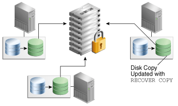

1.1.2 Incremental Backups and RECOVER COPY
The RMAN technique shown in Figure 1-2 makes daily incremental backups, and then uses the RECOVER COPY command to merge the incremental changes into the full database copy. In this way, the database copy on disk is "rolled forward" every day.
Figure 1-2 RECOVER COPY on Disk, and Backup to Tape
Description of Figure 1-2 follows
Description of "Figure 1-2 RECOVER COPY on Disk, and Backup to Tape"
This technique has the following advantages:
  • Only one initial full backup is required, which reduces the total weekly backup window time.
  • An RMAN SWITCH command can point the control file to the database copy, which turns the copy into an actual database file, and thus eliminates the RESTORE step.
Some disadvantages are as follows:
  • You must have sufficient disk space to keep a copy of the whole database on disk, and the archived redo log files required to recover it.
  • Only one physical copy of the database exists. You select the point in time at which to keep the copy, so you can recover to subsequent points in time. For example, to restore to any point in time within the past week, your physical copy must be older than SYSDATE-7. The disadvantages are:
    • You cannot recover to a time earlier than the time at which you maintain the database copy.
    • The closer your recovery point in time is to the current time, the more incremental backups you must restore and apply to the copy. This technique adds time to the overall recovery time objective.
  • The database copy cannot be compressed or encrypted.

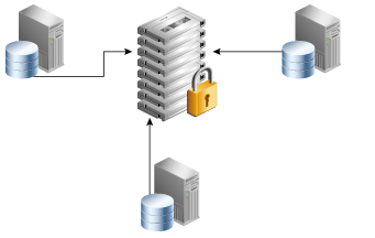

1.1.3 Full Backups to a Third-Party Deduplicating Appliance
As an alternative to RMAN incremental backups and tape drives, some customers use third-party deduplicating appliances to process backup streams. Figure 1-3 depicts three databases writing to a centralized third-party appliance.
Figure 1-3 Third-Party Deduplicating Appliance
Description of Figure 1-3 follows
Description of "Figure 1-3 Third-Party Deduplicating Appliance"
  • A central backup location serves all databases in the environment.
  • The third-party software searches for patterns at the byte and sub-byte level to eliminate redundant data from backup to backup. For example, if a full database backup is almost identical to the backup taken a week before, then the software can attempt to prune the redundant bits from the incoming backup stream.
  • To reduce network load, one optional technique utilizes source-side deduplication so that backup streams are deduplicated on the database host instead of the third-party appliance. Typically, this technique relies on an RMAN SBT plug-in.
  • These third-party appliances do not recognize or validate Oracle AI Database blocks. From the perspective of the appliance, a database backup is the same as a file system backup: a stream of bytes.
  • Deduplication is only effective for full database backups that have a high degree of redundancy. Strategies that use incremental backups often do not achieve good deduplication ratios.
  • The third-party appliance dictates which Oracle AI Database features to use rather than the other way around. Often, adapting to the requirements of the appliance means rewriting existing backup scripts.
