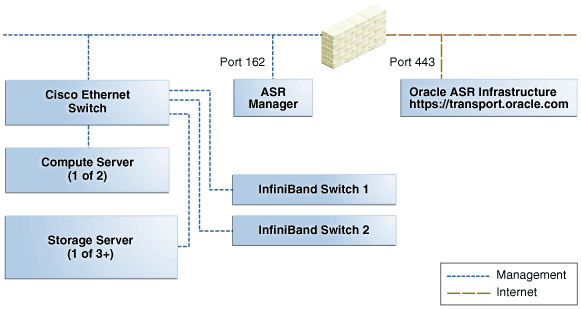

ASR Manager uses the following ports for normal operations. Ensure that Recovery Appliance and ASR Manager server ports are open:
All Recovery Appliance servers must have port 6481 open for HTTP-based asset activation requests that they receive from ASR Manager.
The server running ASR Manager must have port 162 open for SNMP-based telemetry messages that the Recovery Appliance servers send to it.
The Oracle
transport.oracle.comweb server has port 443 open for HTTPS-based telemetry messages that ASR Manager sends to it.
See Figure 4-1 for the port locations.

Figure 4-1 shows the network connections between ASR and Recovery Appliance.
Figure 4-1: Auto Service Request Network Connections
