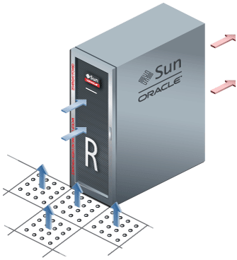

Use perforated tiles, approximately 400 CFM/tile, in front of the rack for cold air intake. The tiles can be arranged in any order in front of the rack, as long as cold air from the tiles can flow into the rack. Inadequate cold air flow could result in a higher inlet temperature in the servers due to exhaust air recirculation. The following table describes the recommended number of floor tiles:
| Type of Oracle Exadata Database Machine or Oracle Exadata Storage Expansion Rack | Recommended Number of Floor Tiles |
| Oracle Exadata full rack systems | 4 |
| Oracle Exadata half rack systems | 3 |
| Oracle Exadata quarter and eighth rack systems | 1 |
Figure 2-1 shows a typical installation of the floor tiles for a full rack.
Figure 2-1: Typical Data Center Configuration for Perforated Floor Tiles
