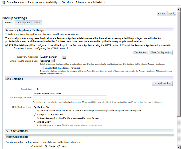

Configuring Backup Settings for Protected Databases Using Cloud Control
Backup settings define the default backup environment for the protected database. The settings that configure real-time redo transport and polling locations define how backups are created to the Recovery Appliance. Other settings, such as control file autobackups or backup optimization, define best practices and performance improvements for protected database backups. These settings may be configured based on your requirements.
To configure backup settings for a protected database using Cloud Control:
  1. Access the home page for the protected database as described in “Accessing the Protected Database Home Page Using Cloud Control”.
  2. From the Availability menu, select Backup & Recovery, and then select Backup Settings.
    The Backup Settings page for the protected database is displayed. Figure 2 displays the Device tab of the Backup Settings page. The Recovery Appliance Settings section displays the Recovery Appliance and the Recovery Appliance user that you configured in “Enrolling the Protected Database with Recovery Appliance”.
    Figure 2: Backup Settings Page for Protected Databases
    Description of image follows
  3. In the Device tab, configure the following optional settings:
    • To write redo data asynchronously from the protected database to the Recovery Appliance, in the Recovery Appliance Settings section, select Enable Real-Time Redo Transport.
      See Also: “About Real-Time Redo Transport”
    • If you want to configure backup polling for the protected database, then specify the polling location in the Disk Backup Location setting of the Disk Settings section.
      Disk backups created to this location will then be automatically picked up by the Recovery Appliance if the protected database is assigned to a protection policy that specifies this location as a polling location. Polling policies are created by the Recovery Appliance administrator.
    • If the protected database is on RAC, the operating system login credentials must be the same on all nodes.
  4. In the Policy tab, configure settings that define the objects that must be backed up.
    Although it is not mandatory to configure the settings in this section, it is strongly recommended that you configure automatic backups for the control file and server parameter file. Table 2 describes these configuration settings.
    • To configure control file and server parameter file autobackups:
      • Select Automatically backup the control file and server parameter file (SPFILE) with every backup and database structural change.
      • In the Autobackup Disk Location field, specify an existing directory or Automatic Storage Management (ASM) disk group name to which the control file and server parameter file autobackups must be stored. If no location is specified, then the autobackups are stored in the local fast recovery area.
    • To enable backup optimization, select Optimize the whole database backup by skipping unchanged files such as read-only and offline datafiles that have been backed up.
    • To enable block change tracking, select Enable block change tracking for faster incremental backups and specify the name of the block change tracking file in the Block Change Tracking File field.
    • In the Tablespaces Excluded from Whole Database Backup section, ensure that you do not add any tablespaces.
    Note: When backing up to Recovery Appliance, the initial full backup of the protected database must contain all the tablespaces.
    • In the Archived Redo Log Deletion Policy section, select one of the following options to specify how RMAN must handle redo log file deletion for the local backups stored on the protected database host:
      • None
        Archived redo logs in the fast recovery area are eligible for deletion if they have been backed up at least once or if they are obsolete according to the backup retention policy.
      • Delete archived redo log files after they have been backed up the specified number of times
        Deletes archived redo log files that have been backed up the number of times specified in the Backups field.
        Note: In the Retention Policy section, you need not specify any values. The settings in the Retention Policy section are not used for backups to Recovery Appliance, as the retention policy is inherited from the protection policy that is associated with the protected database when it is enrolled with the Recovery Appliance.
  5. Click Apply to save the backup settings.

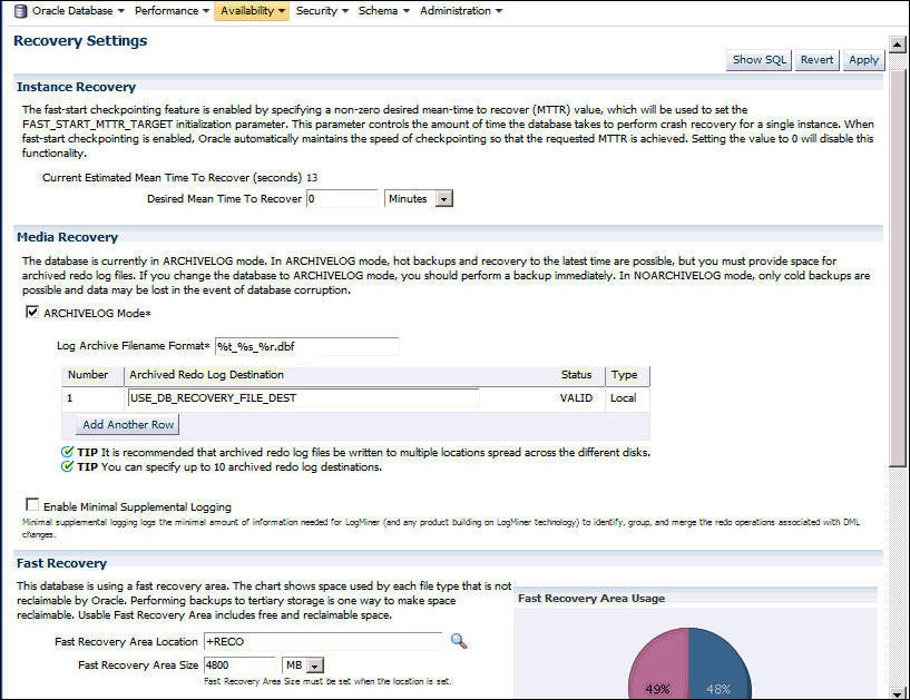

Configuring Recovery Settings for Protected Databases Using Cloud Control
Recovery settings define the default recovery environment for the protected database. The only mandatory setting for Recovery Appliance is the Log Archive Filename Format. Configuring the remaining recovery settings is optional.
To configure recovery settings for a protected database using Cloud Control:
  2. From the Availability menu, select Backup & Recovery, then select Recovery Settings.
    The Recovery Settings page for the protected database is displayed as shown in Figure 3.
    Figure 3: Protected Database Recovery Settings
  3. In the Instance Recovery section, specify the Desired Mean Time To Recover.
  4. In the Media Recovery section, perform the following steps:
    • (Optional) Select ARCHIVELOG Mode.
    • (Optional) In the Log Archive Filename Format field, specify the format used for archived redo log file names.
    • In the Archived Redo Log Destination field, provide a destination to store archived redo log files or specify USE_DB_RECOVERY_FILE_DEST to indicate that the redo log files must be stored in the local fast recovery area.
      If you selected Enable Real-Time Redo Transport in the Backup settings for this protected database, then the archived redo log destination is automatically set.
  5. Configure a local fast recovery area for the protected database by specifying the following in the Fast Recovery section:
    • In the Fast Recovery Area Location field, specify the file-system or ASM location where backup-related files are stored. Oracle recommends that you configure a fast recovery area for the protected database. Local backups of the protected database are stored in the fast recovery area.
    • In the Fast Recovery Area Size field, specify the disk space quota allocated to the fast recovery area. This is the maximum storage that can be used by the recovery area for this protected database. Specifying a size is mandatory when you configure a fast recovery area.
  6. Click Apply to save the recovery settings.

Clearing the Backup Configuration of Protected Databases Using Cloud Control
You can clear the backup configuration of a protected database and remove its existing Recovery Appliance settings. Clearing the backup configuration removes the currently-configured Recovery Appliance and virtual private catalog user, any configured RMAN channels, and the real-time redo transport configuration.
To clear the backup configuration for a protected database using Cloud Control:
    The Backup Settings page for the protected database is displayed as shown in Figure 2.
  3. In the Recovery Appliance Settings section, click Clear Configuration.
    Note: If real-time redo transport was configured for the protected database, then you must manually force a redo log switch to maintain an accurate state for the Redo Shipping column of this protected database in Cloud Control.
