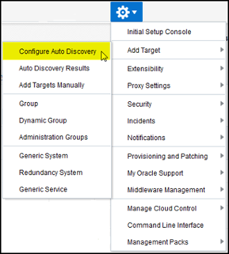

  2. Click Setup, then Add Target, and finally Configure Auto Discovery, as shown in Figure 3-1:
    Figure 3-1 Configure Auto Discovery Menu
    Menu option

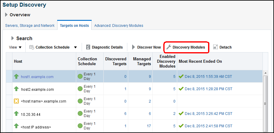

  3. On the Setup Discovery page, select a host on the Targets on Hosts tab and click Discovery Modules, as shown in Figure 3-2:
    Figure 3-2 Setup Discovery
    Discovery Modules button

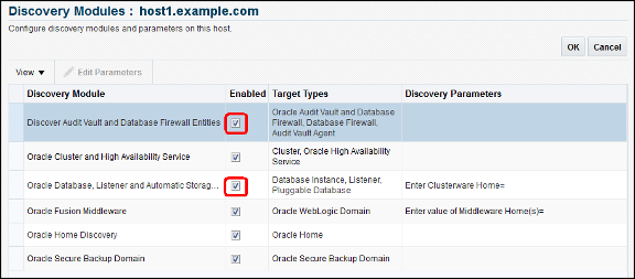

  4. On the Discovery Modules page, confirm that Discover Audit Vault and Database Firewall Entities and the Oracle Database, Listener and Automatic Storage Management options are enabled, as shown in Figure 3-3:
    Figure 3-3 Discovery Modules
    Discovery Modules options
    Click OK.
