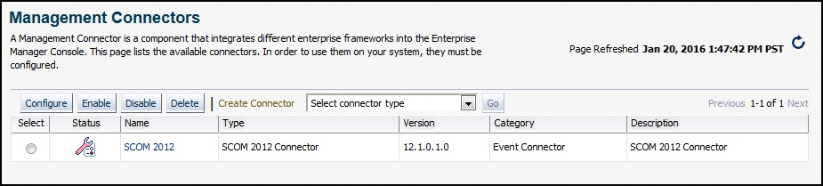

- The connector instance shows up as unconfigured in the Connector Setup page. Figure 3-1 shows an unconfigured SCOM 2012 connector instance.
Figure 3-1 Unconfigured SCOM 2012 Connector Instance

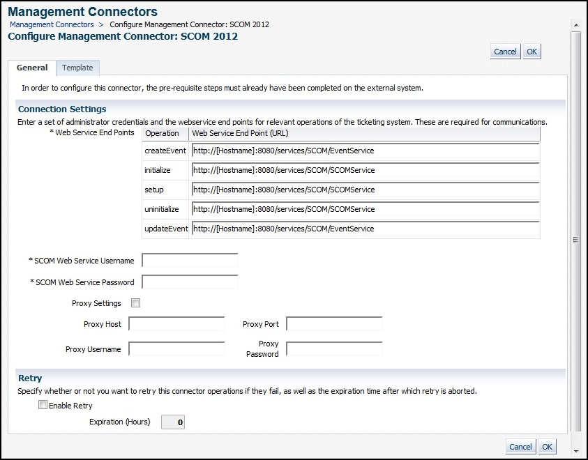

Figure 3-2 General Tab of Configure Management Connector Page

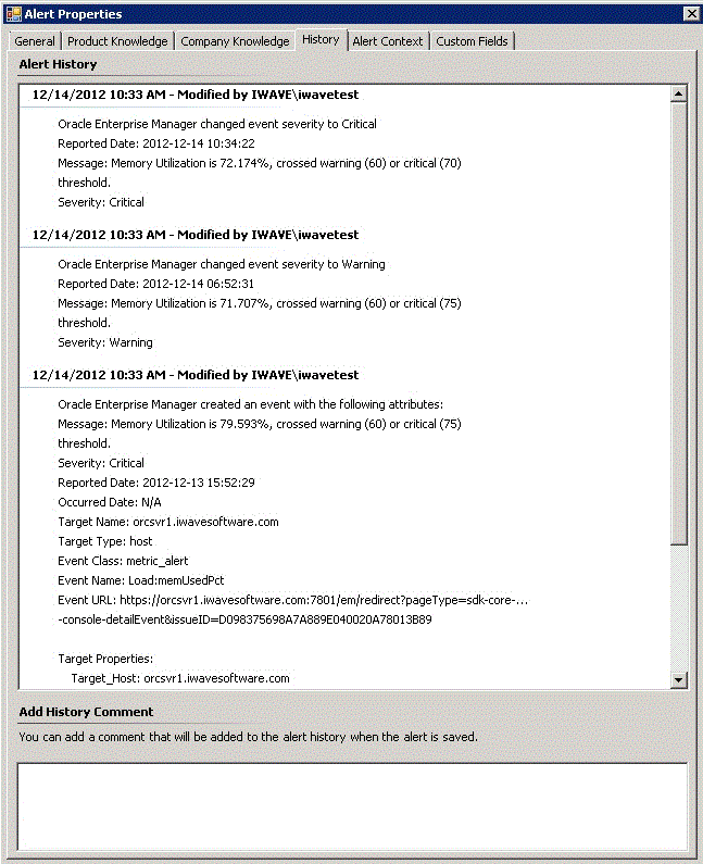

There is an alternate template defined in the connector that must be installed for the updateEvent operation to switch from the default Update-Only mode to the Create-On-Update mode. By default, the alternate template will synchronize the history log information when a new event severity is sent from Enterprise Manager. This means that the history log in the new alert will include an entry for the original alert created and an entry for each update that has occurred up to that point in time. Also, the history log of the original alert will include an entry for the original create and one for each update as well. Figure 3-3 shows an example of the history log for the new alert when the default synchronization feature is enabled.

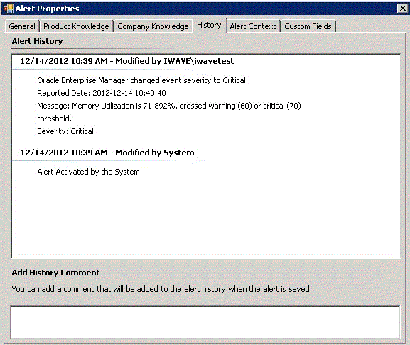

If synchronization of the logs is not desired, the alternate template has a flag that can be changed to disable the synchronization feature. When the feature is disabled, the original alert will just have information about the original create but will not include any update entries. Also any new alerts that are created will just have a single entry for the update associated with that alert. Figure 3-4 shows an example of the history log for the new alert when the synchronization feature has been disabled.

Figure 3-3 History Log with Synchronization Feature Enabled (default value)
Figure 3-4 History Log with Synchronization Feature Disabled

Connection Settings
The SCOM connector communicates with Microsoft SCOM through the SCOM web service installed as described in Installing the Microsoft SCOM Web Service. All fields are mandatory.
Web Service End Points – URL to use when performing event operations that require interaction with the SCOM web service. The web service uses two different URLs depending on the operation being performed. One URL is used for the registration of the SCOM Agent with Microsoft SCOM (setup, initialize, and uninitialize operations), and defaults to the following value:
http://[Hostname]:8080/services/SCOM/SCOMServiceThe other URL is used to create/update alert information in SCOM (createEvent and updateEvent operations), and defaults to the following value:
http://[Hostname]:8080/services/SCOM/EventServiceModify the URL for the operations based on whether the SCOM web service was set up using HTTP or HTTPS:
For HTTP:
Replace
[Hostname]in the URL with the hostname or IP address of the system where the SCOM web service was installed.
For HTTPS:
Change the protocol from http to https.
Replace
[Hostname]in the URL with the hostname or IP address of the system where the SCOM web service was installed. -
Change the port number from 8080 to 8443.
SCOM Web Service Username - User name that was configured for accessing the SCOM web service in step 9 of the appropriate web service installation section (Installing the Microsoft SCOM Web Service on UNIX and Installing the Microsoft SCOM Web Service on Windows).
SCOM Web Service Password - Password that was configured for accessing the SCOM web service in step 10 of the appropriate web service installation section (Installing the Microsoft SCOM Web Service on UNIX and Installing the Microsoft SCOM Web Service on Windows).
