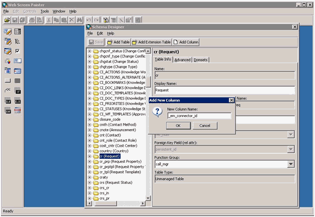

Start the Web Screen Painter and log in using an account that has permission to update database schemas.
Select Tools from the menu, then Schema Designer.
The Schema Designer window appears.
Scroll down through the list of tables, right-click on cr (Request), and select Add Column.
The Add New Column pop-up appears, as shown in Figure 8-1.
Figure 8-1 Add New Column Window
Enter a column name of _em_connector_id and click OK.

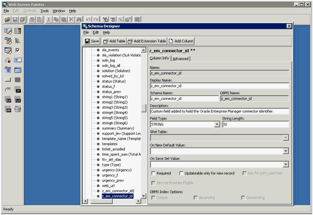

A form appears that contains the new column information.
Set the Field Type to STRING and the String Length to 32. You can also optionally add a description.
Click Save after you have entered the information.
Figure 8-2 shows an example of a completed form.
Figure 8-2 Example of New Column Input

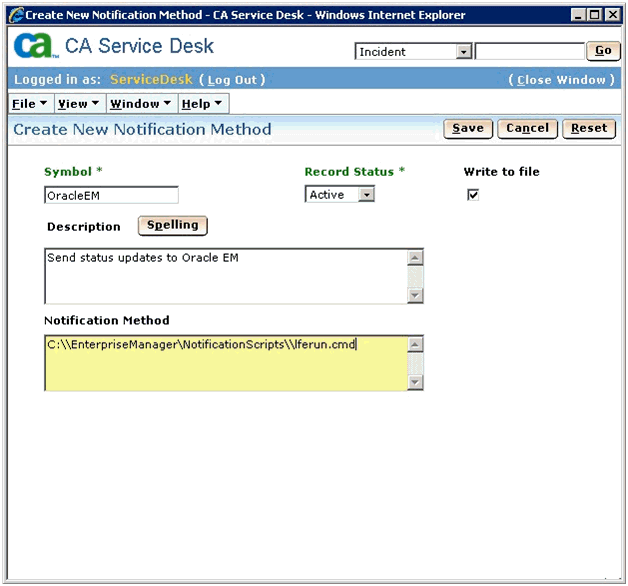

Click on Notification Methods, then click on Create New.
The Create New Notification Method window appears.
Enter information in the fields as shown in Figure 8-3. The path in the Notification Method field should be the path where the notification script is installed.
On Windows platforms, you must use double backslashes to separate directory names in the path.
Figure 8-3 Create New Notification Method Window
Click Save.

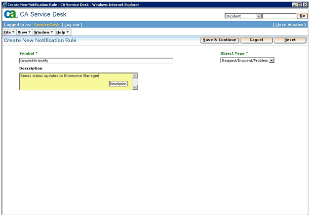

Click on Notification Rules, then click on Create New.
The Create New Notification Rule window appears.
Enter information in the fields as shown in Figure 8-4, then click Save & Continue.
Figure 8-4 Create New Notification Rule Window

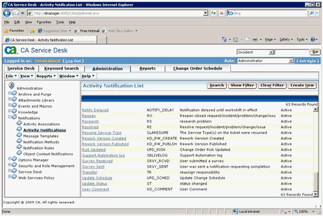

Click on Activity Notifications and find Update Status in the Activity Notification List. See Figure 8-5 for an example of the Activity Notification List.
Figure 8-5 Activity Notification List
Click on Update Status, then click Edit.
The Update Status Activity Notification Detail window appears.
