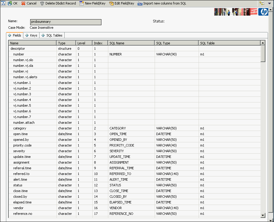

Enter a File Name of probsummary and click Search.
A form with the probsummary table information appears, as shown in Figure 6-1.

Click on the line with a Name of descriptor and a Type of structure.
Click on New Field/Key.
The Add Field window appears.
Enter a Name of oracle.connector.id and a type of character, then click Add.

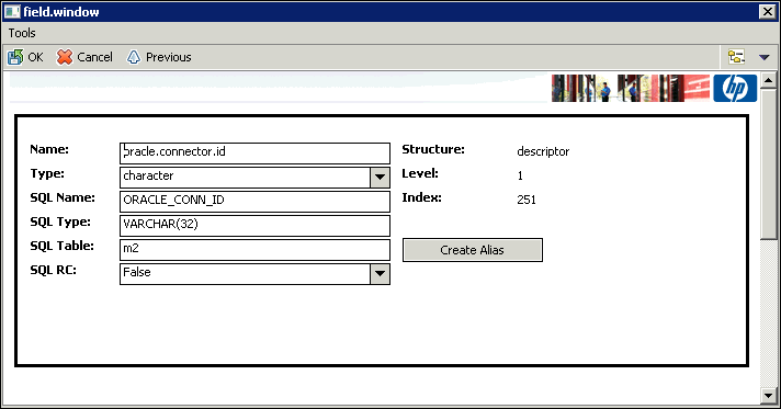

Scroll down to the bottom of the list of fields and click on the row with the name of oracle.connector.id.
Click on Edit Field/Key. The field edit window appears, as shown in Figure 6-2.
Figure 6-2 Update Field Window
Enter ORACLE_CONN_ID in the SQL Name field, VARCHAR(32) in the SQL Type field, and m2 in the SQL Table field, then click OK.

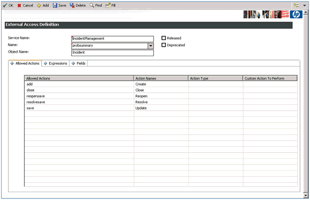

Modify the web service to include the new database field as follows:
Expand Menu Navigation, then Tailoring, then Web Services in the System Navigator pane.
Double-click on WSDL Configuration.
The External Access Definition panel appears.
Enter probsummary in the Name field and click Search.
The record for probsummary will be loaded as shown in Figure 6-3.
Figure 6-3 External Access Definition Panel

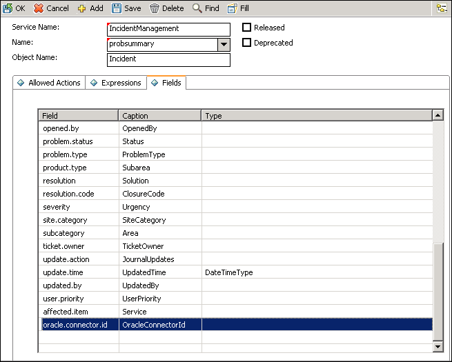

Click on the Fields tab and scroll to the bottom of the list of fields.
Click on the Field column of the first empty row and select oracle.connector.id from the list.
Click on the Caption column on the same row and enter OracleConnectorId, as shown in Figure 6-4, then click OK.
Figure 6-4 Oracle Connector ID

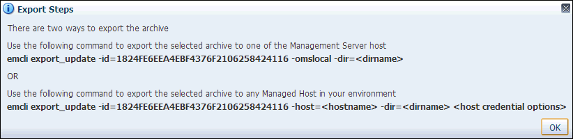

Determine the command required to export the archive files. To do this, perform the following steps:
From the Setup menu of the Enterprise manager console, select Extensibility, then Self Update.
Click on the Management Connector link in the Type column.
The HP Service Manager connectors appear in the list with a status of Applied.
Click on the HP Service Manager connector, then select Export from the Actions list.
A pop-up window, like the example shown in Figure 6-5, appears with the command required to export the file.
Figure 6-5 Export Command Example

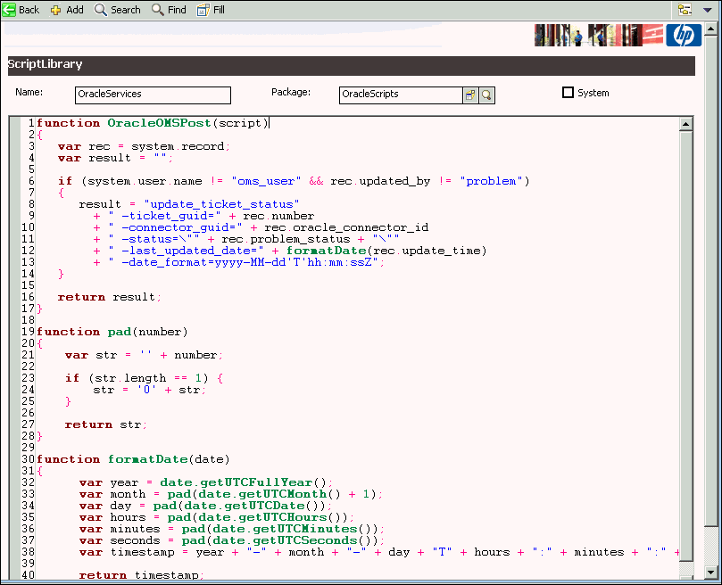

Create a Script Library that generates the parameters for the EM CLI call by performing the following sub-steps:
Expand Menu Navigation, then Tailoring in the System Navigator pane.
Double-click on Script Library.
The Script Library panel appears.
Enter a Name of OracleServices and a Package of OracleScripts.
Copy the contents of the OracleOMSPost.js file from Exporting the Notification Script Files into the script panel. Figure 6-6 shows the Script Library panel after the fields have been specified.
Change the value of the username on line 6 from oms_user to the username that Enterprise Manager will use to access the Service Manager web service. See Service Manager Username in Connection Settings for more information.
Click Add.
Figure 6-6 Script Library Panel

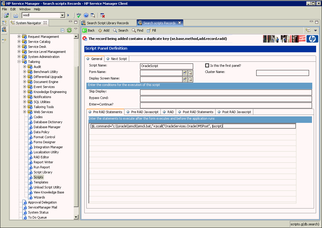

Create a Script Panel that calls the Script Library by performing the following sub-steps:
Double-click on Scripts in the System Navigator panel.
The Script Panel Definition panel appears.
Enter a script name of OracleScript.
Click on the Pre RAD Statements tab.
Click on the first line and enter the following text, where <emcli_dir> is the path where the EM CLI tool was installed:
$L.command="<emcli_dir>\\emcli.bat;"+jscall("OracleServices.OracleOMSPost", $script)
Backslashes in the path must be entered as double backslashes. For example, C:\tools\em\emcli.bat would be entered as C:\\tools\\em\\emcli.bat.
Figure 6-7 shows the Script Library panel after the fields have been specified.
Click on the RAD tab and set Application to us.launch.external.
Click on the first line in the Names column and enter name.
Click on the first line in the Values column and enter $L.command.
Click Add to create the Script Panel.
Figure 6-7 Script Panel Definition

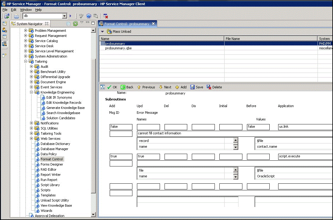

Perform the following sub-steps to update the Format Control to invoke the script upon creating or updating a ticket:
Double-click on Format Control in the System Navigator panel.
The Search Format Control Records panel appears.
The Format Control: probsummary panel appears.
Click on the line where the Name is probsummary.
Click Subroutines to open the Subroutines tab.
One or more subroutines may already be defined.
Scroll down the screen to the last empty entry and enter the following data:
Set Add to true.
Set Upd to true.
Set Names to file on line 1, and name on line 2.
Set Values to $file on line 1, and OracleScript on line 2.
Figure 6-8 shows the Format Control panel after you have specified the fields.
Click Save.
