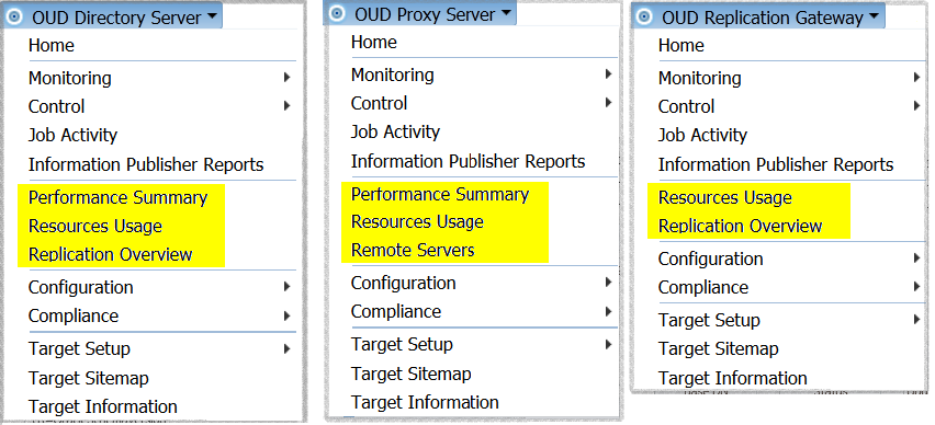

Figure 1-1 Comparison of Target Instance Submenus
Description of "Figure 1-1 Comparison of Target Instance Submenus"
Table 1-1 compares submenus for an OUD Directory Server instance, OUD Proxy Server instance, and OUD Replication Gateway instance. All submenus include many identical commands including: Home, Monitoring, Control >, Job Activity, Information Publisher Reports, Configuration >, Compliance >, Target Setup >, Target Sitemap, and Target Information. For each target instance, however, the Home page presents different high-level information based on the target instance type.
In Table 1-1, the following differences are highlighted:
For a Directory Server instance, the submenu provides access to the following information: Performance Summary, Resources Usage, and Replication Overview.
For a Proxy Server instance, the submenu provides access to the following information: Performance Summary, Resources Usage, and Remote Servers.
For a Replication Gateway instance, the submenu provides access to the following information: Resources Usage and Replication Overview.

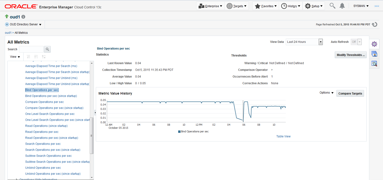

1.3.2 Using the All Metrics Page
The Oracle Unified Directory submenu pages display only a subset of the monitored metrics. The Monitoring > All Metrics command provides access to all the monitored metrics for the target instance.
For example, the Performance Summary page of a directory server page provides information on the about the add, delete, modify, modify DN, search, and bind Operations Performed on the server. The All metrics page also provides Operations information for each LDAP connection handlers, which are not included in the Performance Summary page.
To display the All Metrics page:

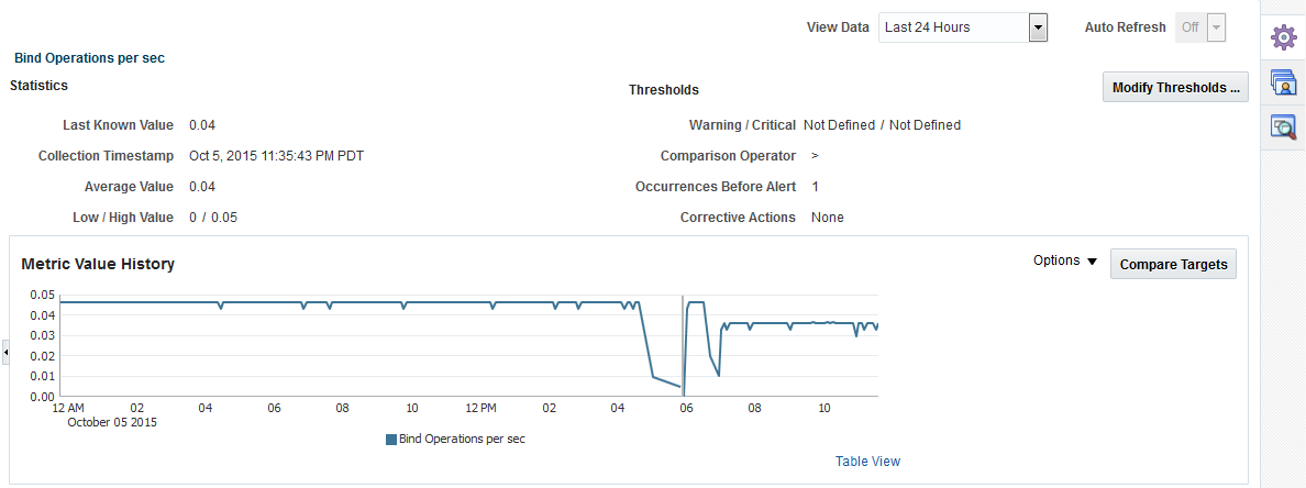

Metrics are organized in logical groups. The following figure illustrates the metrics available when the Operations Read Information group is expanded, and Bind Operations Per Second is selected.
To display details of the metric, click on the metric name. In Figure 1-3, to display information about Bind Operations Per Second within the last 24 hours, you need to choose the Bind Operations per sec metric from the All Metrics page. A new page dedicated to this metric is displayed.
Figure 1-3 lists the following Statistics:
Last Known Value: 0.04
Average Value: 0.04
Low Value: 0
High Value: 0.05
Warning Threshold: Not Defined
Critical Threshold: Not Defined
Occurrences Before Alert: 1
Corrective Actions: None
A graph is labeled with metric values ranging from 0.00 to 0.50, and hourly intervals spanning 24 hours. The graph data illustrates activity peaks between the hours of 08AM and 08AM the following day.
Figure 1-3 One Level Search Operations Per Second page
Description of "Figure 1-3 One Level Search Operations Per Second page"

1.3.5 Summary of Proxy Server Instance Monitoring Information
You can review the monitoring information of the proxy server instance displayed on various pages in the Enterprise Manager Cloud Control console.
1.3.5.1 Proxy Server Instance Home Page Metrics
The proxy server instance Home page provides the following basic information:
General information about the proxy server instance and its current status including: up time, the administration port, the full version of the server, install and instance paths, and server role
Availability of the server
The current load of the LDAP server with the number of Operations Per Second, the Average etime Per Operation, the number of Connections Per Second, the number of Current Connections, and the Connections Peak
List of configured suffixes with the server role, the network groups, and the associated algorithms
List of configured connection handlers with the type, the port number, whether connection handler is enabled or disabled, Average etime (ms) Per Operation, and the number of Operations Per Second Since the Last Collection
List of remote servers with, for each server, the name, the host name, the port number, the SSL port number, the suffix and workflow element, the status of the remote server, the last up time, and the last down time
Performance overview with line charts representing the number of Operations Completed, the Operations eTime, the number of connections, and the CPU usage.
In addition, the Home page displays any alerts that might have been generated by the monitored server instance.
1.3.5.2 Proxy Server Instance Performance Summary Page Metrics

1.3.6 Summary of Replication Gateway Monitoring Information
You can review the monitoring information of the replication gateway displayed on various pages in the Enterprise Manager Cloud Control console.
If the plug-in type that you have selected does not correspond to the server instance type that you want to monitor (that is, directory, proxy, or replication gateway, an alert to this effect is displayed on the Home tab.
1.3.6.1 Replication Gateway Instance Home Page Metrics
The replication gateway instance Home page provides the following basic information:
General information about the replication gateway instance and its the current status including: up time, administration port, full version of the server, install and instance paths, server role, and whether replication is enabled or disabled
