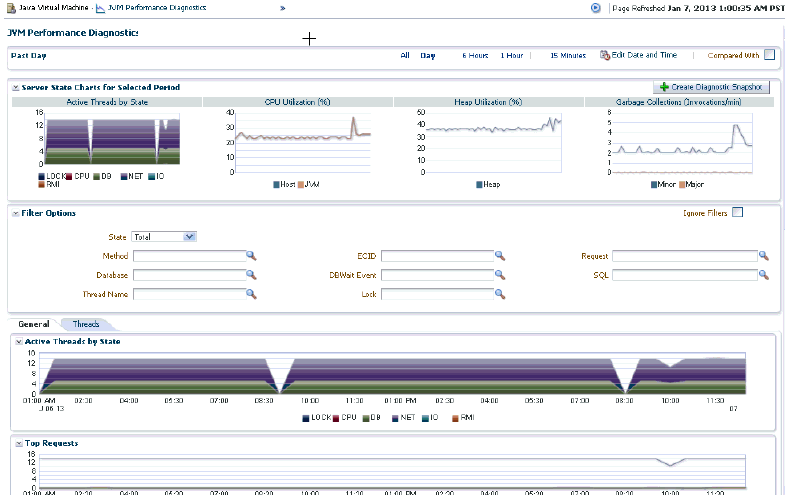

In each case, a new window is displayed showing the JVM Performance Diagnostic view. In the multi-VM case, JVMD shows a VM group target and aggregate information for the group. Figure 12-1 shows the JVM Performance Diagnostic view.
Figure 12-1 JVM Performance Diagnostic View
Figure described in text
This view shows the summary details of the JVM in which the selected operation is running. It shows Server state charts, Active Threads by State, Top Methods, Top Requests, Top DBWait Events, TopSQLs, and Top Databases. You can filter the data that is displayed by specifying various criteria.
Click on the Threads tab to view the Thread State transition chart. This chart shows how the threads have transitioned from one state to another in the selected period. Click on a bar graph in the Thread State Transition chart to view the Sample Analyzer, which provides a detailed analysis on the thread of the thread.
Click the Live Thread Analysis control to see all threads running in the JVM. Click on a thread to view additional information about that thread.

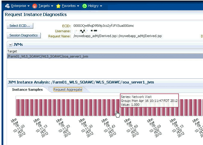

Figure 12-2 shows part of the Request Instance Diagnostic view for a given ECID.
Figure 12-2 The Request Instance Diagnostics View
Figure described in text.
The JVMs panel lists all the JVMs through which the request was executed. Select a JVM to display the following information:
  • RID: The Relationship ID, an ordered set of numbers describing the location of each task in the tree of tasks.
  • The start time and the duration of the request.
  • Step Name: The individual steps in the request. For example, the first step could be jsp, the second could be EJB, and the third could be DB.
  • CPU utilization by the JVM
  • GC Major/Minor indicates the number of objects added to the major and minor garbage collections.
If you select a JVM from the list, a bar graph is displayed in the Instance Samples tab of the JVM Instance Analysis panel. This graphs shows the thread state in each JVM snapshot taken within the duration of the request. A color key, to the right of the display, indicates a different thread state; Runnable, Lock, IO wait, DB Wait, NW wait, and RMI Wait. Hover over the graph to get an in-depth view of the thread.

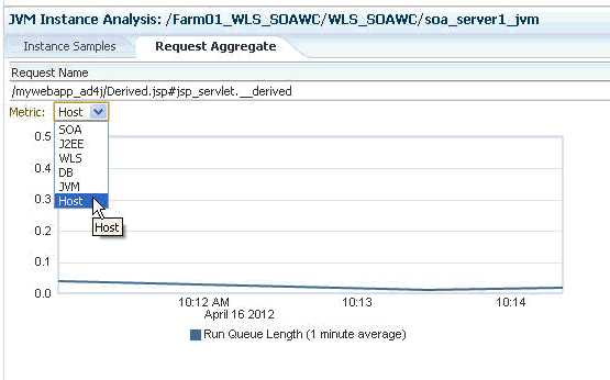

To view aggregate metrics collected for the selected JVM during the specified period, click on the Request Aggregate tab. Figure 12-3 shows a sample tab.
To view measurements for a given metric type, select the desired type from the drop down Metric menu, as shown in the figure.
