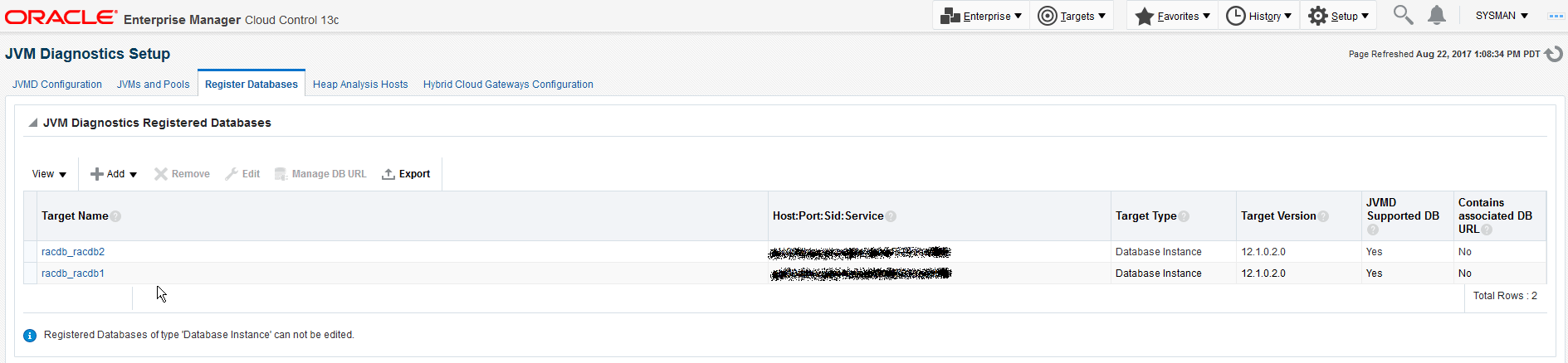

Setting Up JVM Diagnostics
Follow these steps to set up and configure JVM Diagnostics:
JVMD Load Balancers information is also displayed on the Setup page. The table includes Load Balancer URL, its status, and a list of engines associated with it.
Configuring the JVM Diagnostics Engine
You can configure the JVM Diagnostics Engine by defining engine parameters and advanced settings. You can then create new idle thread rules and system call rules. Operations on existing rules include importing and exporting a rules, as well as deleting a rule.

Configuring the Heap Analysis Hosts
The analysis and load heap steps have significant memory requirement on the Heap Analysis Host. Ensure you have a 64-bit JVM and sufficient free memory on the Heap Analysis Host.
To configure the heap analysis hosts, follow these steps:

To register the database:
From the Setup menu, select Middleware Management, then select Setup. Select the JVM Diagnostics Engine row in the RUEI/JVMD Engines table and click Configure.
Click the Register Databases tab. The list of registered databases is displayed. The database name, host, Oracle SID for the monitored database, and listener port number is displayed. You will also see a column indicating “JVMD Supported DB". If this column has a value of Yes, you can proceed with the cross tier analysis. If the column has a value of Unavailable, you cannot perform cross tier analysis because the JDBC connection to the database cannot be established.
If cross tier correlation is not established even after registering the database with JVMD, select a database and click Manage DB URL. In the Associate / Disassociate a Registered Database field, select a Database URL and click Add and specify the URL of the database to be associated. After the URL has been associated with the registered database, the JVM Diagnostics Engine will start monitoring the cross-tier calls between JVM targets and the underlying database.
