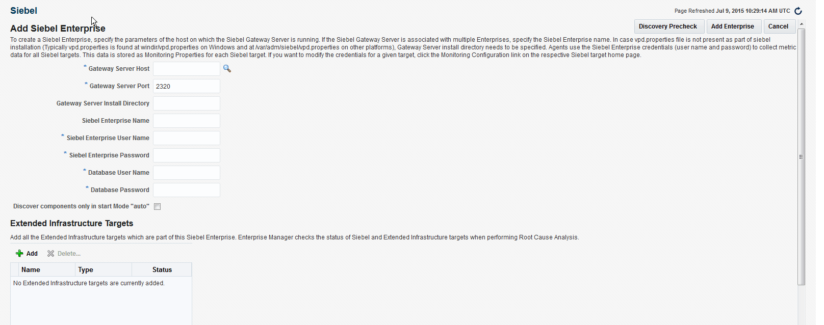

Adding a Siebel Enterprise
Siebel Enterprise enables administrators to logically organize distributed targets for efficient and effective management and monitoring.
To add a Siebel Enterprise to Cloud Control for monitoring, perform the following steps:
  1. From the Targets menu, select Siebel.
  2. On the Siebel page, select the Enterprises tab, then click Add.
    The Add Siebel Enterprise page appears, as shown in Figure 3-1.
  3. Enter the details and credentials. You can also select Auto Start Mode to discover only those components for which the start mode is set as ‘auto’. Selecting this option will ignore all the components for which the start mode is set as ‘manual’.
    For typical installations, the gateway server port is 2320.
  4. After entering the credentials, you can either choose to continue with adding the enterprise by clicking Add Enterprise, or perform the Discovery Precheck.
  5. To perform the Precheck, click Discovery Precheck.
    Clicking Discovery Precheck opens the Discovery Precheck wizard, which displays whether the Precheck was performed successfully. Click Close to proceed to the Precheck Details page.
    Discovery Precheck performs the following checks, the detailed results of which are displayed on the Precheck Details page.
    • Gateway Check
    • Discovery Check
    • Server Manager Check
    • Server Check
    • Enterprise Check
    • Host Check
    After reviewing the details on the Precheck Results page, click Proceed to Discovery. You can proceed with the discovery only if the Precheck is successful.
    If the Precheck fails, check all the credentials provided, and if the Enterprise already exists in the Enterprise Manager Repository.
    The progress page notifies you when the Siebel Enterprise and its associated targets are created.
    The discovery will fail if there is a mismatch in the host name of the Siebel server and the host name discovered in Enterprise Manager (EM).
    There is a possibility of a mismatch in complex Siebel network configurations such as virtual host or cluster Siebel servers/gateways, where the Siebel host mentioned in Siebel configuration does not match with the host monitored in EM. In such cases, the siebelserverconfig.xml file provides mapping between these hosts.
    The siebelserverconfig.xml file should be used to add mapping host entries for discovery. The file can be found in <agent_inst>/sieblserverconfig directory. The siebelserverconfig directory is not available in a fresh plug-in deployment. It will be created after the first siebel target discovery. Thereby, Siebel servers with mismatched hosts will not be discovered in the first discovery attempt.
Figure 3-1 Add Siebel Enterprise Page

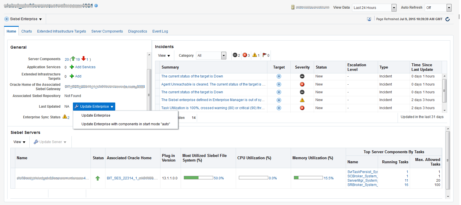

Updating the Siebel Enterprise
After you add or remove Siebel servers or server components from your Siebel Enterprise, you must update the Enterprise, and check the relations between the Siebel Enterprise and Enterprise Manager targets.
Perform the following steps to update the Enterprise:
  1. From the Targets menu of the Enterprise Manager Console, select Siebel.
  2. Click on the Siebel enterprise you want to update.
  3. On the Siebel Enterprise Home page, in the General section, click Update Enterprise.
    Clicking Update Enterprise gives you the following options:
    • Update Enterprise, which updates all components in an enterprise, whether components are in manual start mode, or start ‘auto’ mode.
    • Update Enterprise with Components in Start Mode ‘Auto', which updates only those components in an enterprise which are in start ‘auto’ mode.
    The Siebel Enterprise Home page appears, as shown in Figure 3-2.
  4. Review the report that is displayed, and click Close.
    Clicking Close opens the Configuration Change Report page, with the details on the report of the relations between Siebel Enterprise and Enterprise Manager targets.
  5. After reviewing the report, click Update to update the Enterprise.
    If the report displays errors, click Cancel.
Figure 3-2 Siebel Enterprise Home Page

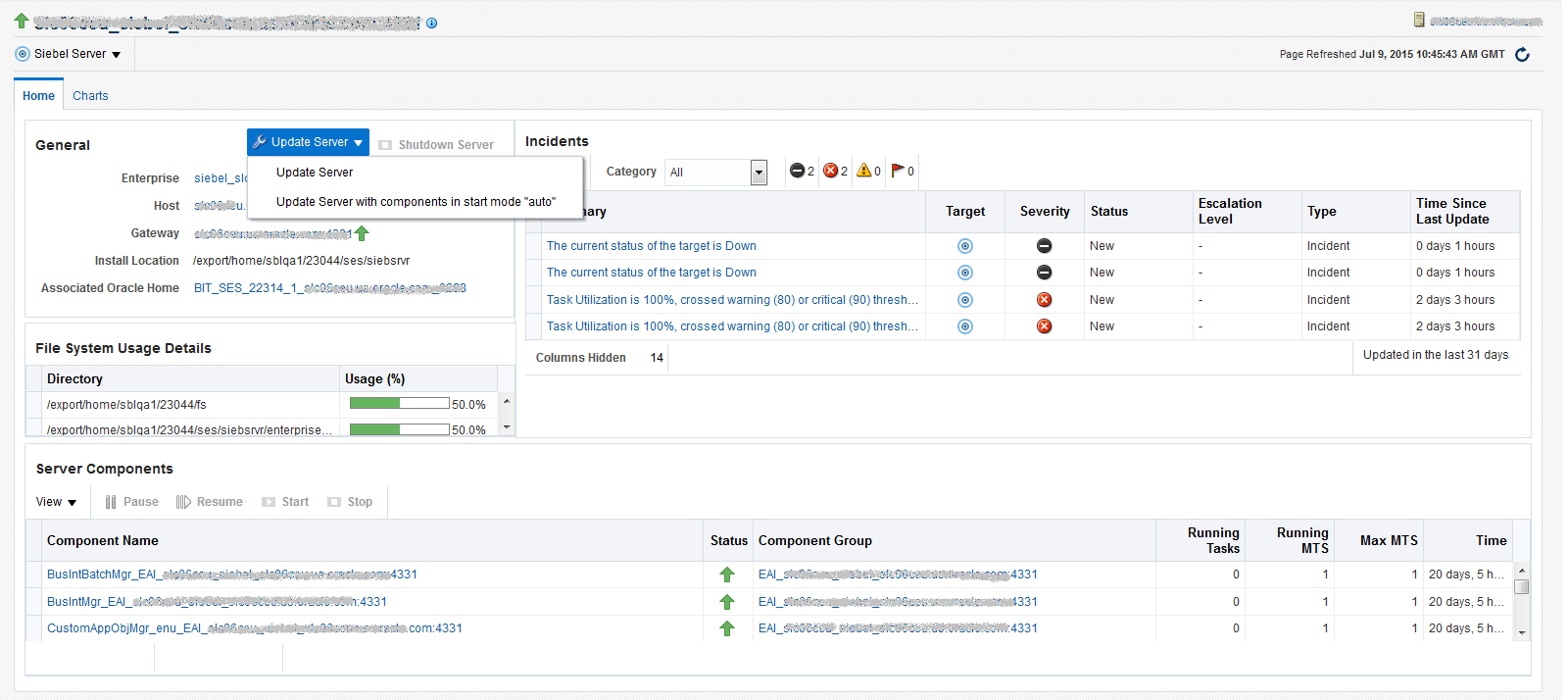

Updating the Siebel Servers
To synchronize the topology for Siebel Servers, perform the following steps:
  2. Click the Siebel server target, and on the Siebel Server home page, in the General section, click Update Server.
    Clicking Update Server gives you the following options:
    • Update Server, which updates all components in a server, whether components are in manual start mode, or start ‘auto’ mode.
    • Update Server with Components in Start Mode "Auto" which updates only those components in a server which are in start ‘auto’ mode.
    The Siebel Server Home page appears, as shown in Figure 3-3.
  3. Review the report that is displayed, and click Close.
Figure 3-3 Siebel Server Home Page
