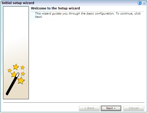

Click Next to proceed with configuration. The dialog shown in Figure 4-3 appears.

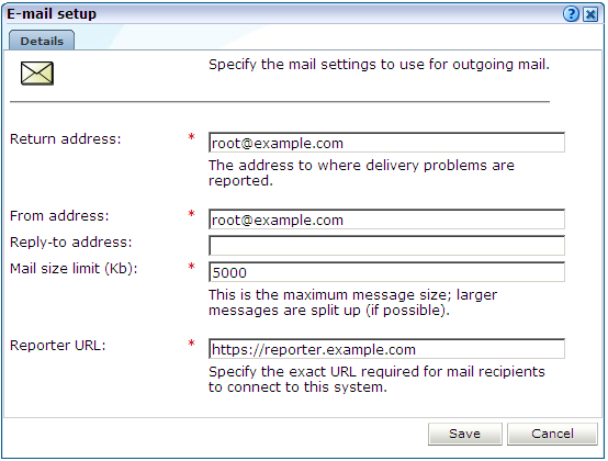

Specify the requested information as explained in Table 4-1.
Table 4-1 E-mail Setup Fields
Field Description Return address
Specifies the e-mail address to which failed or problem e-mails are reported. It is recommended that this an address that is regularly checked.
From address
Specifies the address the recipient sees in their mail client.
Reply-to address
Specifies the address that users can click within an e-mail to reply to an e-mail. If this is not specified, the From address setting is used.
Mail size limit
Specifies the maximum message size (in kilobytes) allowed for e-mails. If an e-mail contains reports that exceed this limit, the system will try to split up the reports into individuals e-mails to overcome this limitation. Reports that are too large to be sent individually are not sent, and the user is informed of the problem. The default mail size limit is 5000 Kb.
Reporter URL
Specifies the exact URL required for e-mail recipients to connect to the Reporter system. Typically, this is the same URL used by RUEI users to access the Reporter system.
The e-mail information is used to configure RUEI's interface to your internal network, and will be used for reporting problems. When you have entered the required information, click Next. The dialog shown in Figure 4-4 appears.

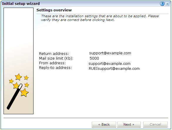

Check that the information specified in the settings overview is correct. You can use Back and Next to move between dialogs as necessary. Click Next. The dialog shown in Figure 4-5 appears.
This dialog indicates how far the system has got in applying your specified settings. Typically, this process takes a maximum of 15 minutes. Click Finish to close the dialog.
