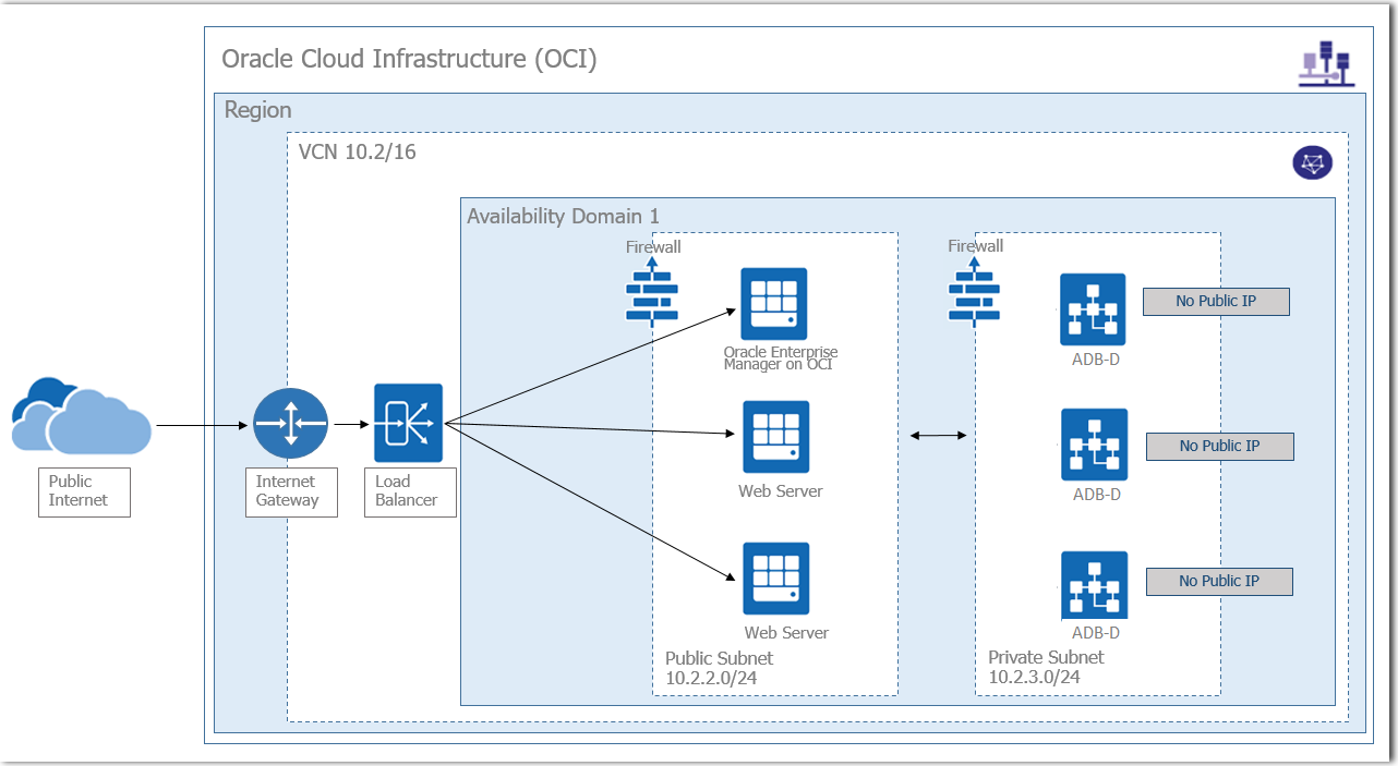

The following diagram provides an overview of how Oracle Enterprise Manager deployed on Oracle Cloud Infrastructure connects with Autonomous Databases – Dedicated.
In the diagram:
- Oracle Enterprise Manager is deployed using a Marketplace image in a
Public subnet in a VCN.
Note that in the diagram, the other Web Servers in the Public subnet are not a part of the Oracle Enterprise Manager deployment, but a part of a sample scenario that depicts a typical Oracle Cloud Infrastructure application deployment that connects with Autonomous Databases – Dedicated.
- Autonomous Databases – Dedicated are created in a Private subnet in the same VCN.
- Oracle Enterprise Manager connects with Autonomous Databases – Dedicated using a Private IP address.

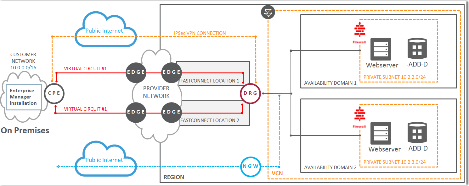

Oracle Enterprise Manager Deployed On Premises
You can use Oracle Enterprise Manager deployed on premises to discover Autonomous Databases – Dedicated, including Autonomous Databases – Dedicated on Oracle Exadata Cloud at Customer.

- Review and use the specified connectivity options to connect Oracle
Enterprise Manager deployed on premises with the Autonomous Database –
Dedicated. Oracle Enterprise Manager on premises connects with the
Autonomous Database – Dedicated using a Private IP address, and you can use one of
the following options to connect Oracle Enterprise Manager deployed in your
on-premises network to the Autonomous Database – Dedicated in your VCN.
- Site-to-Site VPN, which is an Internet Protocol Security (IPSec) VPN. IPSec VPN provides standards-based IPSec encryption over public internet. See Site-to-Site VPN in Oracle Cloud Infrastructure documentation.
- FastConnect, which provides an easy way to create a dedicated, private connection between the on-premises network and the VCN in Oracle Cloud Infrastructure. See FastConnect in Oracle Cloud Infrastructure documentation.
Note that you do not have host access to the Autonomous Database – Dedicated in Oracle Cloud Infrastructure. If required, web server instances in the Private subnet can initiate connections to the internet by way of a NAT gateway. See NAT Gateway in Oracle Cloud Infrastructure documentation.
The following diagram provides an overview of how Oracle Enterprise Manager deployed on premises connects and interacts with Autonomous Databases – Dedicated in Oracle Cloud Infrastructure.
In the diagram:
- Oracle Enterprise Manager is deployed in an on-premises network.
- The Autonomous Databases – Dedicated are created in Private subnets in a VCN in Oracle Cloud Infrastructure.
- The two connectivity options, Site-to-Site VPN and FastConnect, are displayed to demonstrate how Oracle Enterprise Manager deployed on premises connects with the Autonomous Database – Dedicated using these options.
