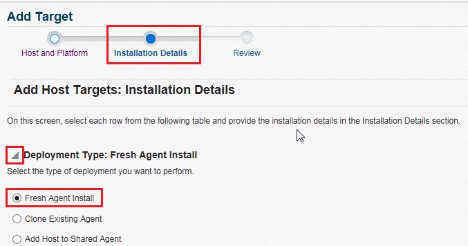

What Is an Add Host Target Wizard?
The Add Host Targets Wizard is a GUI-rich application accessible from within the Enterprise Manager Console, and used for installing Management Agents on unmanaged hosts and converting them to managed hosts in the Enterprise Manager system.
To access the Add Host Targets Wizard, do one of the following:
  • From the Setup menu, select Add Target, then select Add Targets Manually. On the Add Targets Manually page, click Install Agent on Host.
  • From the Setup menu, select Add Target, then select Auto Discovery Results. On the Auto Discovery Results page, under the Servers, Storage and Network tab, select a host that you want to monitor from the displayed list, then click Promote.

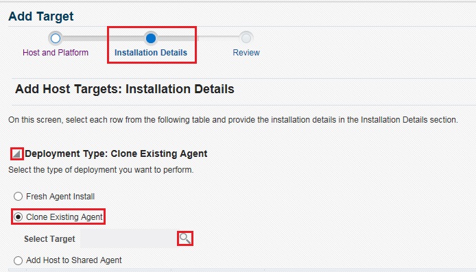

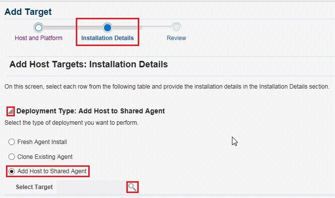

The wizard enables you to do the following on multiple hosts across platforms with options to run preinstall and postinstall scripts:
  • Deploy a fresh Management Agent
    Deploy a Fresh Management Agent
  • Clone an existing well-tested and patched Management Agent
    Deploy an Existing Management Agent
  • Install a Management Agent (called Shared Agent) using an existing, centrally shared Management Agent (called Master Agent)
    Deploy a Centrally Shared Management Agent
Although the Add Host Targets Wizard can be used for remotely installing one Management Agent, the wizard is best suited for mass-deployment of Management Agents, particularly while mass-deploying Management Agents of different releases on hosts of different platforms. The wizard gives you the flexibility to select hosts on which you want to install a Management Agent. This helps you when you want to install the Management Agent on several hosts, in one attempt.

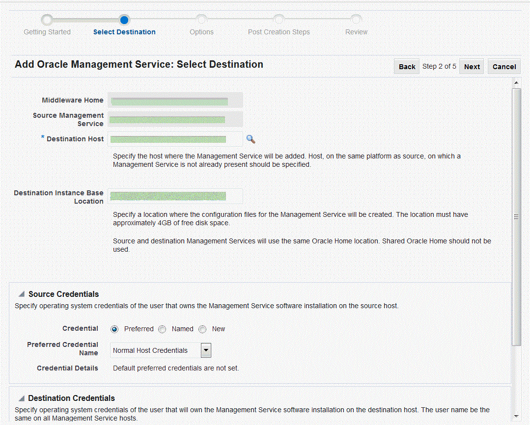

The Add Management Service deployment procedure (Figure 2-2) helps you meet high-availability requirements by enabling you to install an additional OMS using an existing OMS that is running on an Admin Server host.
Figure 2-2 Add Management Service Deployment Procedure
In simple words, the Add Management Service deployment procedure enables you to install additional OMS instances in your environment. The deployment procedure clones an existing OMS and replicates its configuration to the destination host.
The earlier releases of Enterprise Manager offered this installation type from the Enterprise Manager Installation Wizard. However, for the Enterprise Manager release, this installation type is offered as a deployment procedure.
For more information about the deployment procedure, see the chapter on adding additional management service in the Oracle Enterprise Manager Basic Installation Guide.
