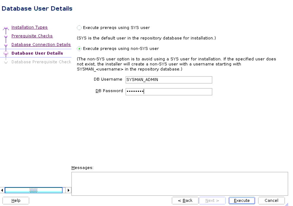

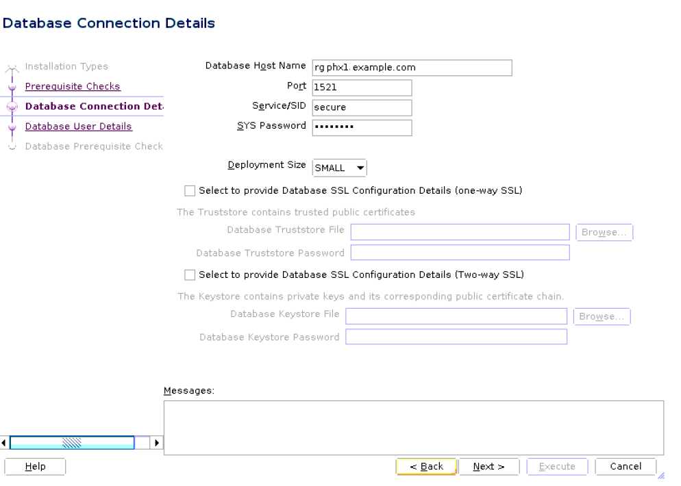

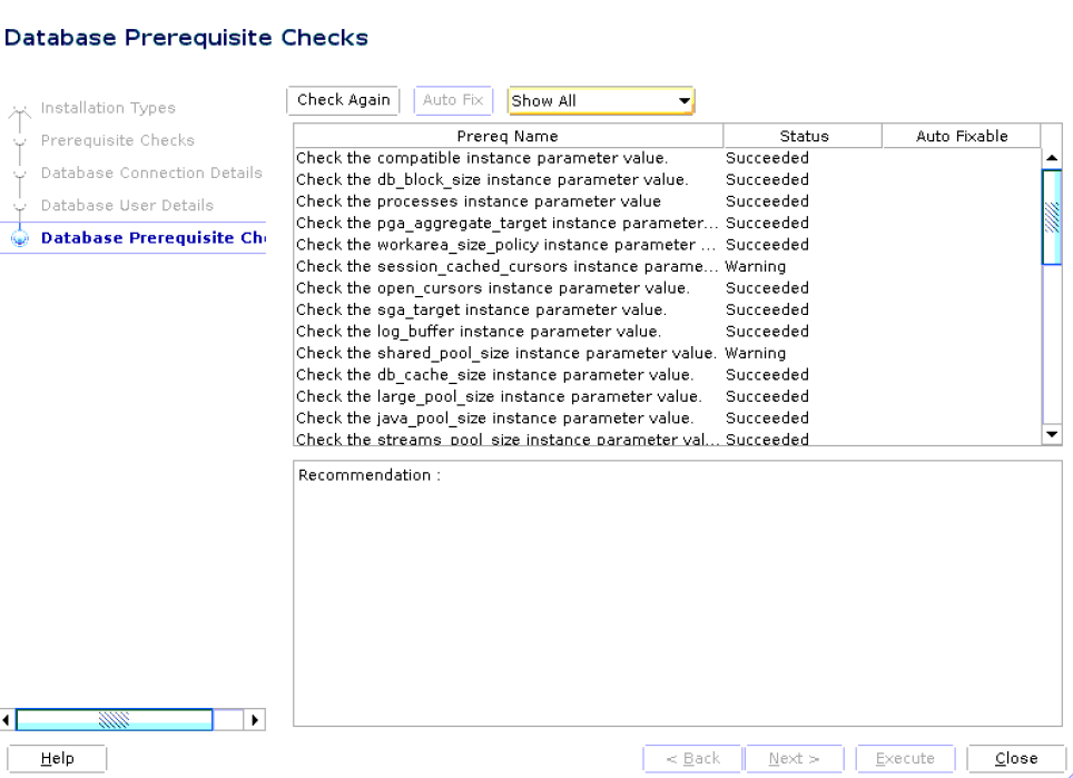

Running the EM Prerequisite Kit in Graphical Mode
Every time the EM Prerequisite Kit is run in graphical mode, the results of the prerequisite checks run for a particular component are displayed and the user can view the status of each prerequisite check.
To view the status of the EM prerequisites, follow these steps:
