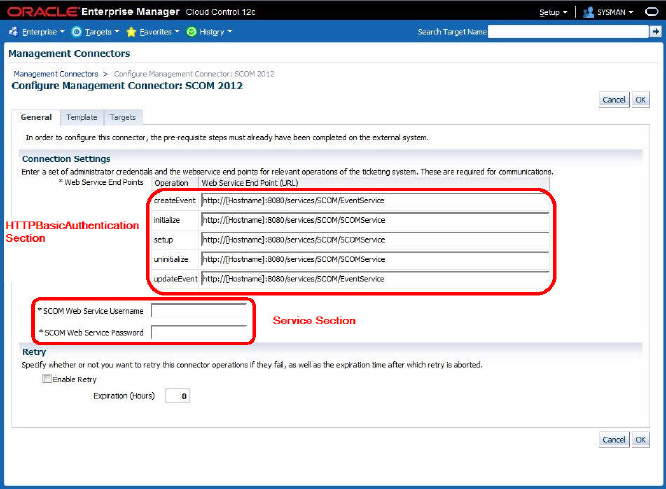

Defining the Connector Descriptor File
Now that you have the templates created, it is time to create a connector descriptor file that defines the connector in Enterprise Manager. The connector descriptor XML file describes the connector metadata and the configuration properties of the connector, such as web service end points and authentication schema.
The key points to remember when constructing a descriptor are:
                              The connector descriptor file name must be connectorDeploy.xml
                              The XML file should adhere to the connectorDeploy.xsdschema.
See Table 2-2 in the Extracting Schema Files section for the location of the connectorDeploy.xsd schema file.
Refer to the sample connectorDeploy.xml in Event Connector Samples for reference implementation.
Table 2-5 lists the sections that comprise a connector descriptor and provides a summary of what each section does:
Table 2-5 Metadata Sections
| Metadata Section | Required | Explanation |
| Connector Information | Yes | This section provides information about the connector that will be displayed at the UI. |
| Authentication | No | Specifies the authentication method and the parameters that are required to connect to the web service. |
| Service | Yes | This section is used to configure the URLs used to connect to the web service for the different service operations. |
| Template Registration | Yes | This section is used to define all of the templates that are used for the connector. |

  </NewTargetType>Authentication Section
The authentication section specifies the authentication method and the credentials that are required to connect to the web service. There are three possible authentication types that can be configured. If no authentication section is specified, no authentication will be performed when the connector connects to the web service. Table 2-7 lists the three possible authentication sections and the fields contained in each.
Table 2-7 Authentication Fields
| Section/Field | Required | Description | |
| SOAPHeaderAuthentication | No | Specifies the credentials used to connect to the web service using SOAP header authentication. | |
| *Username | Yes | The username to specify in the SOAP header | |
| *Password | Yes | The password to specify in the SOAP header | |
| *AuthVariable | No | Up to 20 other variables to pass in the SOAP header | |
| *SOAPHeader | Yes | A string that serves as template for the SOAP header. It will be updated by substituting the user inputs for variables defined above in the designated location and bound with a HTTP request. | |
| HTTPBasicAuthentication | No | Specifies the credentials used to connect to the web service using basic authentication | |
| *Username | Yes | The username to specify when calling the web service | |
| *Password | Yes | The password to specify when calling the web service | |
| UserNameTokenAuthentication | No | Specifies the credentials used to connect to the web service using Username Token Profile authentication | |
| *Username | Yes | The username to specify | |
| *Password | Yes | The password to specify | |
* Fields marked with an asterisk are comprised of the following subfields:
                              VariableName: Name of the variable being defined
                              DisplayName: Name to use when displaying information about this field at the UI
                              "required" attribute: Specifies whether the field is required (defaults to false if not specified)
Sample Authentication Section
Example 2-9 shows the information that is included in the Authentication section. In this example, the authentication method is basic authentication. The operator would be required to provide SCOM Web Service Username and SCOM Web Service Password values when configuring the connector. The values entered by the operator would be passed in the basic authentication header for any requests that are sent to the web service.
Example 2-9 Authentication Section Sample
<HTTPBasicAuthentication>
  <Username required="true">
    <VariableName>Username</VariableName>
    <DisplayName>SCOM Web Service Username</DisplayName>
  </Username>
  <Password required="true">
    <VariableName>Password</VariableName>
    <DisplayName>SCOM Web Service Password</DisplayName>
  </Password>
</HTTPBasicAuthentication>Service Section

Sample Service Section
Example 2-10 shows both of the required Service sections and three optional sections. The URLs in the WebServiceEndpoint element are placed in a CDATA section to avoid conflicts with reserved XML characters. The values surrounded by square brackets [] need to be replaced by the operator on the configuration page.
For example, the default URL for the createEvent operation is:
http://<host name>:8080/services/SCOM/EventService
This value will be displayed in the Web Service End Points section of the configuration page next to the createEvent operation. The operator will need to replace <host name> with the host name or IP address of the system where the web service is hosted.
Example 2-10 Service Section Sample

Example C-1 in Event Connector Samples shows the complete connector deployment file that includes the samples shown in the preceding sections. Figure 2-1 shows an example of the connector configuration page that is displayed for the sample deployment file. The image has been labeled to show where the fields were defined in the deployment file.
Figure 2-1 Complete Connector Deployment Page
