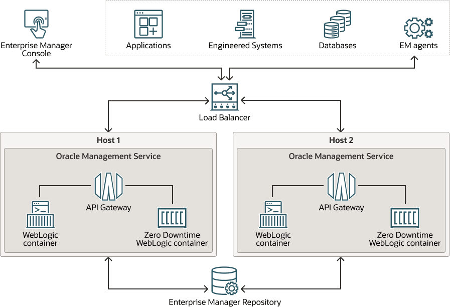

Figure 1-2 shows a sample Enterprise Managerconfiguration and illustrates how these core components fit into the architecture.
Figure 1-2 Enterprise Manager Architecture
In Figure 1-2, the load balancer and the multiple Oracle Management Service (OMS) instances are depicted only to indicate how a sample Enterprise Manager architecture would look in a large organization. They are not a prerequisite or a requirement for an Enterprise Manager system installation. If you do not have a load balancer, then the Management Agents communicate directly with the OMS instances.

The Management Agent is an integral software component that enables you to convert an unmanaged host to a managed host in the Enterprise Manager system. The Management Agent works in conjunction with the plug-ins to monitor the targets running on that managed host.
With the first Oracle Management Service (OMS) you install, by default you receive a Management Agent called the Central Agent. The Central Agent is used for monitoring only the first OMS host, the first OMS, and the other targets running on the first OMS host. To monitor other hosts and the targets running on those hosts, you must install a separate Standalone Management Agent on each of those hosts. Starting with Enterprise Manager 24ai, you can also install Remote Agents that allow you to monitor targets on remote hosts. Remote Agents can significantly reduce the number of agents you need to deploy on your managed environments, therefore simplifying the deployment and maintenance tasks.
About Oracle Management Service (OMS)
Oracle Management Service (OMS) is a Web-based application that orchestrates with the Management Agents and the plug-ins to discover targets, monitor and manage them, and store the collected information in a repository for future reference and analysis. The OMS also renders the user interface for Enterprise Manager.
The OMS is deployed to the middleware home, which is the parent directory that contains Oracle WebLogic Server, OMS, plug-ins, Java Development Kit (JDK), Oracle WT directory, Oracle Common, and other relevant configuration files and directories. While installing the OMS, the Enterprise Manager installation wizard automatically installs Oracle WebLogic Server and JDK. Starting with Enterprise Manager 24ai, you can apply Enterprise Manager software updates without incurring any downtime. The detection of events on all managed targets, alerts, incidents, notifications, or connector processing can continue with no interruptions because all the monitoring components run inside of an independent application container, the Zero Downtime (ZDT) WebLogic container.

The Oracle Management Repository (Management Repository) is a storage location where all the information collected by the Management Agent gets stored. It consists of objects such as database jobs, packages, procedures, views, and tablespaces.
The OMS uploads the monitoring data it receives from the Management Agents to the Management Repository. The Management Repository then organizes the data so that it can be retrieved by the OMS and displayed in the Enterprise Manager console. Since data is stored in the Management Repository, it can be shared between any number of administrators accessing Enterprise Manager.
At the time of installation, the Enterprise Manager installation wizard configures the Management Repository in your existing, certified database. The wizard, however, does not install a new database.
