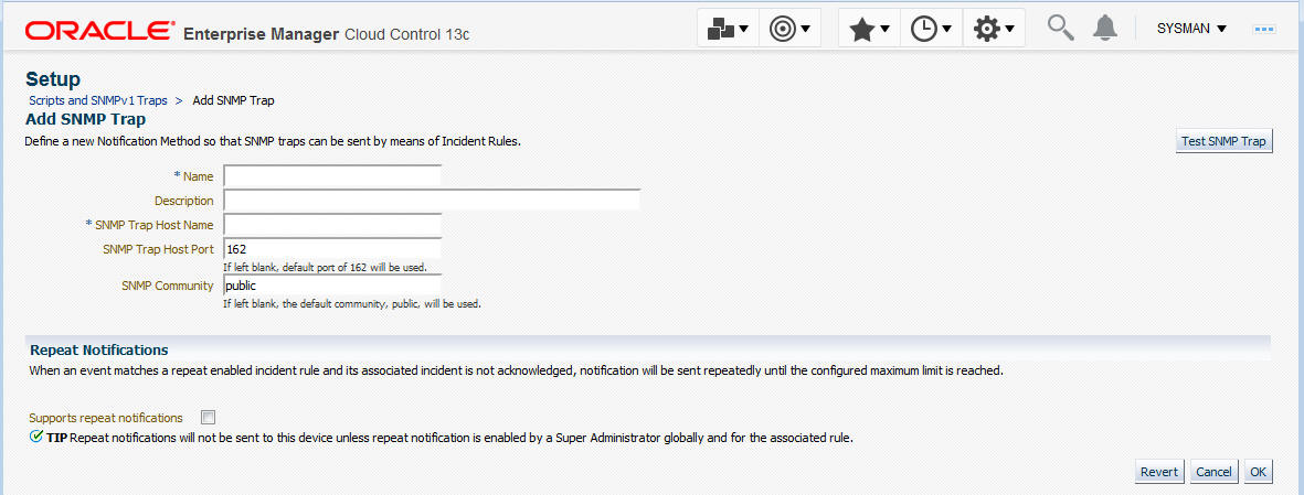

Step 1: Define a new notification method based on an SNMP trap.
Log in to Enterprise Manager as a Super Administrator. From the Setup menu, select Notifications and then select Scripts and SNMPv1 Traps.
You must provide the name of the host (machine) on which the SNMP master agent is running and other details as shown in the following example. As shown in, the SNMP host will receive your SNMP traps.
Figure 6-2 SNMP Trap Required Information
A Test SNMP Trap button exists for you to test your setup.
Metric severity information will be passed as a series of variables in the SNMP trap.
