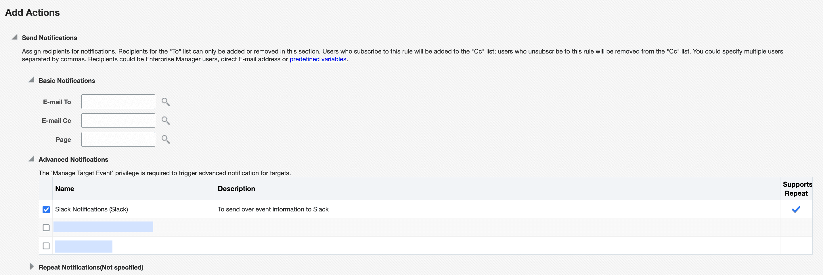

Add a new Action OR Select an existing action and select Edit.
Under the Send Notifications section, navigate to Advanced Notifications, and select the Slack notification method to be assigned. Select Continue.
Select Next.
