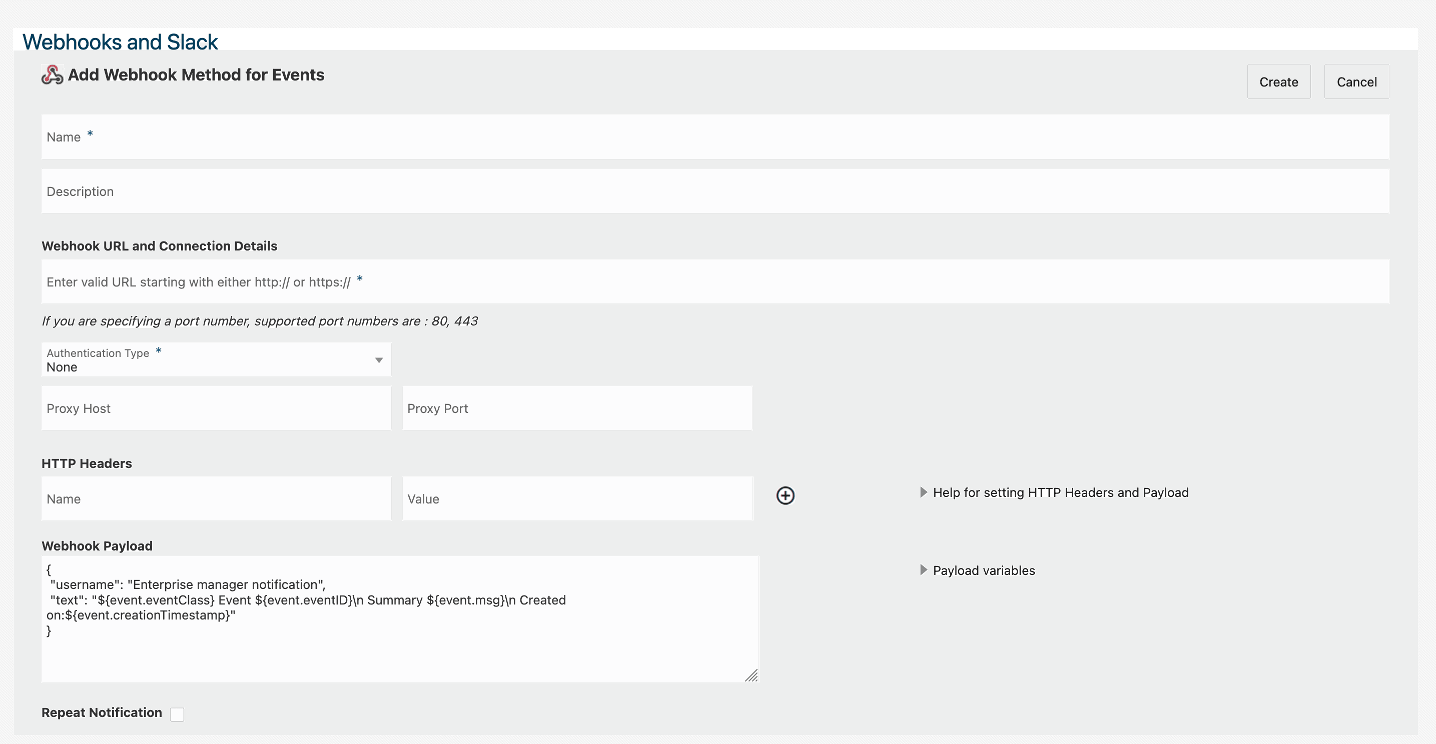

Add a Webhook notification method:
Click Add Notification Method in the Webhooks and Slack page.
- From the Applies to drop-down list, select Incidents or Events to send incident notifications or event notifications.
- Select Webhook:
- Incidents
- Events
- Incidents
- Enter a name and description for your notification method.
Enter the application’s incoming Webhook URL, and optionally other connection details.
- Optionally, modify the Webhook Payload. You can see the available payload variables by opening the Payload variable list on the right.
- Click Create.

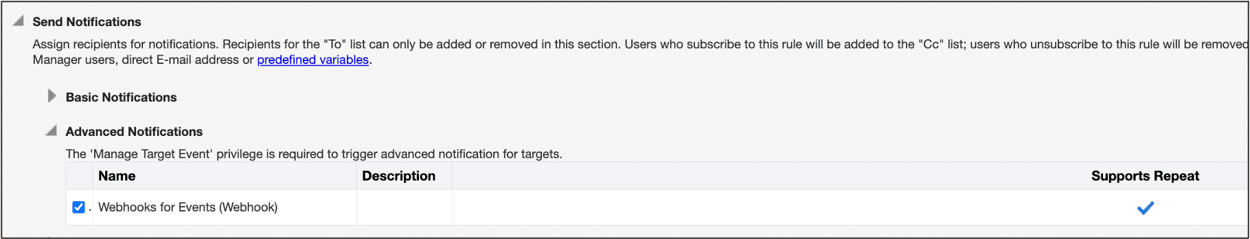

Add a new Action OR Select an existing action and select Edit.
Under the Send Notifications section, navigate to Advanced Notifications, and select the Webhook notification method to be assigned. Select Continue.
