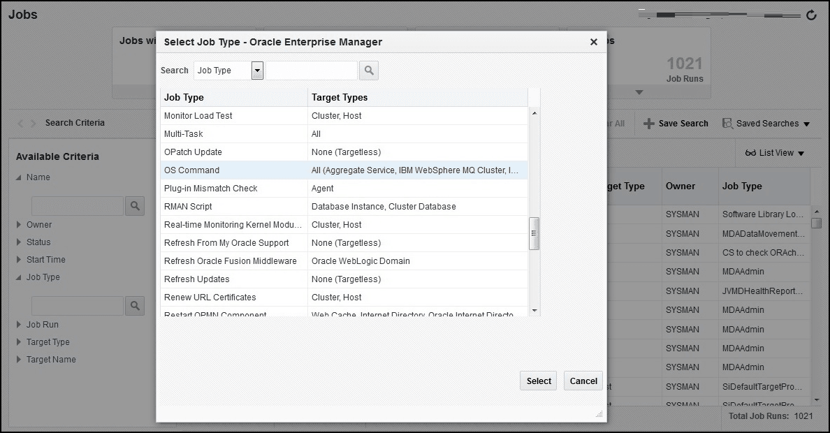

Table 8-1 shows some of the Enterprise Manager job types and functions.
Table 8-1 Example of Job Types

Introducing New Job Types
An Enterprise Manager job consists of a set of steps and each step runs a command or script. The job type defines how the steps are assembled. For example, which steps run serially, which ones execute in parallel, step order, and dependencies. You can express a job type, the steps, and commands in XML (for more information, see "Specifying a New Job Type in XML"). The job system then constructs an execution plan from the XML specification that enables it to run the steps in the specified order.

Adding Job Types to the Job Activity and Job Library Pages
To make a new job type accessible from the Enterprise Manager Cloud Console Job Activity or Job Library page, you must to modify the following specific XML tag attributes.
To display the job type on Job Activity page, set useDefaultCreateUI to "true" as shown in the following example.
<displayInfo useDefaultCreateUI="true"/>
To display the job type on the Job Library page, in addition to setting useDefaultCreateUI attribute, you must also set the jobtype editable attribute to "true."
<jobtype name="jobType1" editable="true">
If you set useDefaultCreateUI="true" and editable="false", then the job type appears on the Job Activity page only and not on Job Library page.This means you cannot edit the job definition.
Adding a Job Type to the Job Activity Page
Figure 8-1 shows the result of setting the useDefaultCreateUI attribute to "true" and enabling users to create a job to select the newly added job type from the Create Job menu.
Figure 8-1 Available Job Types from the Job Activity Page
Making the job type available from the Job Activity page also permits access to the default Create Job user interface when a user attempts to create a job using the newly added job type.
