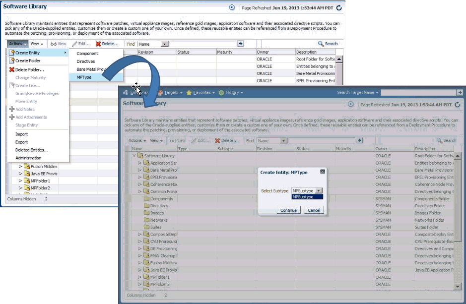

</EntitySubtype>Once a subtype defined is registered, entities of this subtype can be created (if creation is not blocked) using the Software Library console. To do so, from Enterprise menu, select Provisioning and Patching , then click Software Library. From the Software Libray page, select a user-owned folder. From Actions menu, select Create, and then select Type and then the SubType. All the sub-types that belong to the type selected are displayed. For more information, see the following graphic file.
Ideally, you must see the subtypes you created as a part of this list, if not, there is an issue with registration. For more information on registerting the sub-type, see Adding the Software Library Metadata to Enterprise Manager.

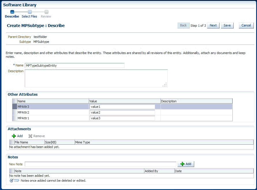

To use the file, ensure that you make the following changes:
MPAttr1,MPAttr2,andMPAttr3are the names of the entity properties, remove the properties that are not required, and change the names of the properties that you retain appropriately.Copy the
DictionaryItemsection from the above sample to create more entity properties. Note that, you can only update the name, you cannot change other aspects of the entity property. -
The entity properties for this sub-type are displayed as
Other Attributesin Sotware Library console. Only, after the subtype metadata with entity property definitions are registered, while creating or editing entities, you can specify values for the entity properties. However, note that you can not define new entity properties.
